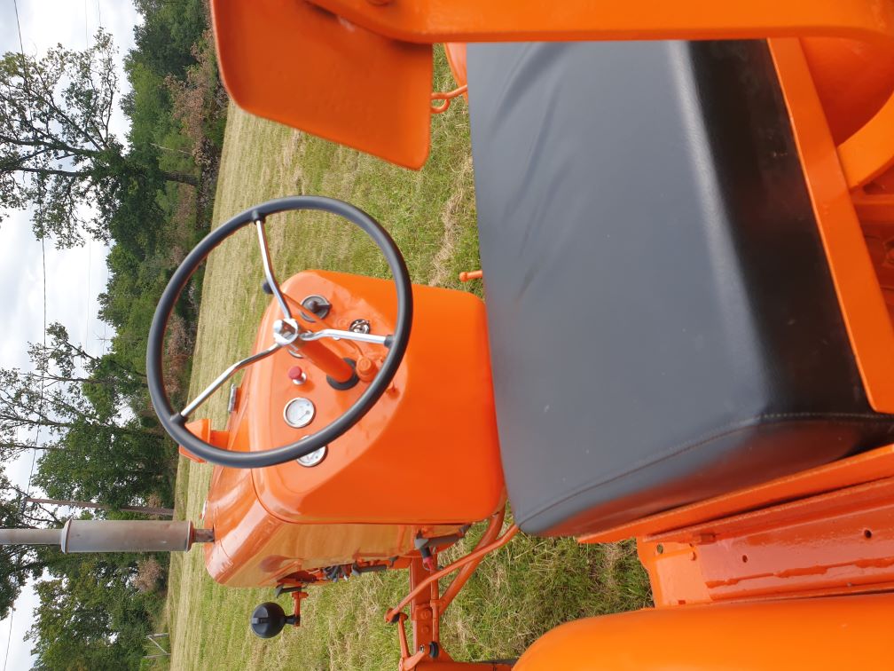

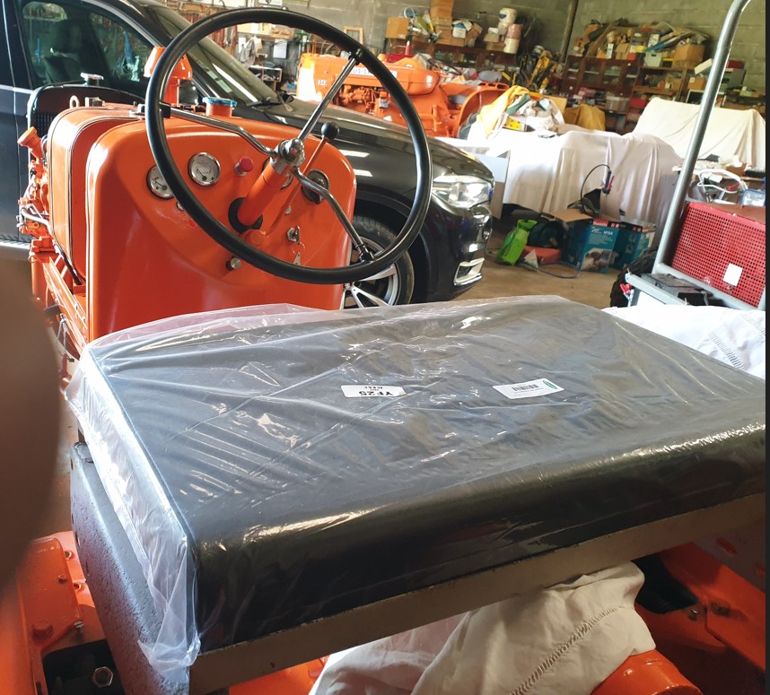

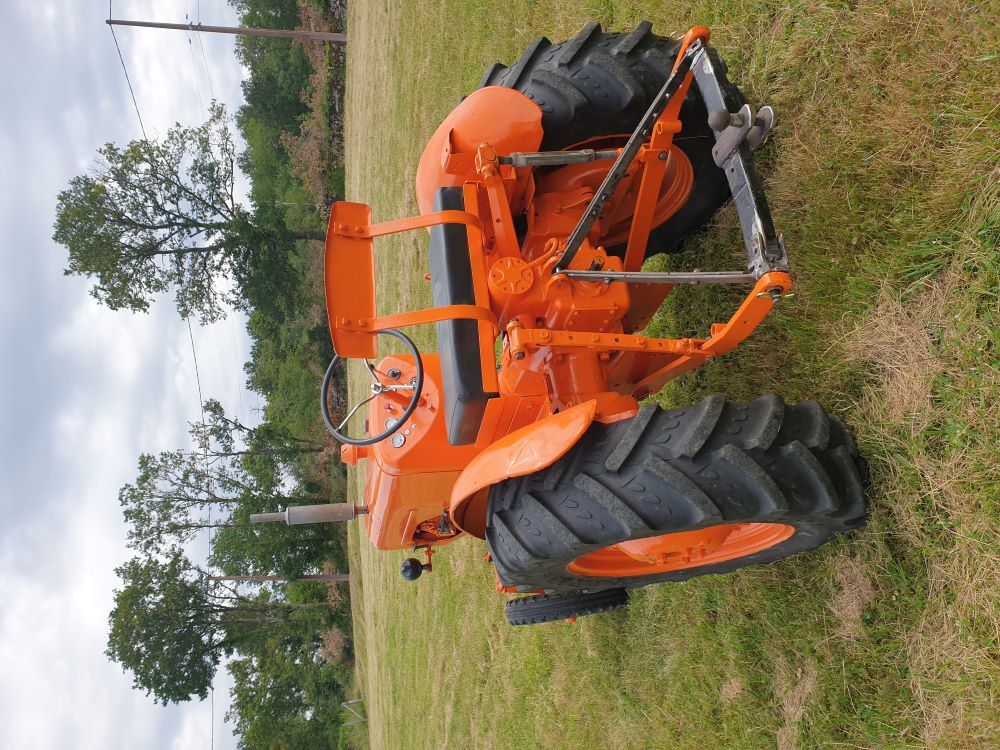

Just a feed back. I did it now
Edited by John426 - 24 Jun 2023 at 9:35am
Points: 91060
Post Options Post Options   Thanks (0) Thanks(0)   Quote steve(ill) Quote  Post ReplyReply Direct Link To This Post Posted: 24 Jun 2023 at 9:02am
very NICE... I have not taken a good look at the BACK end of a 272 before... Nice WIDE fenders.. Good setup on the 3 pt LIFT cylinder... and that 3 point system is GREAT.
