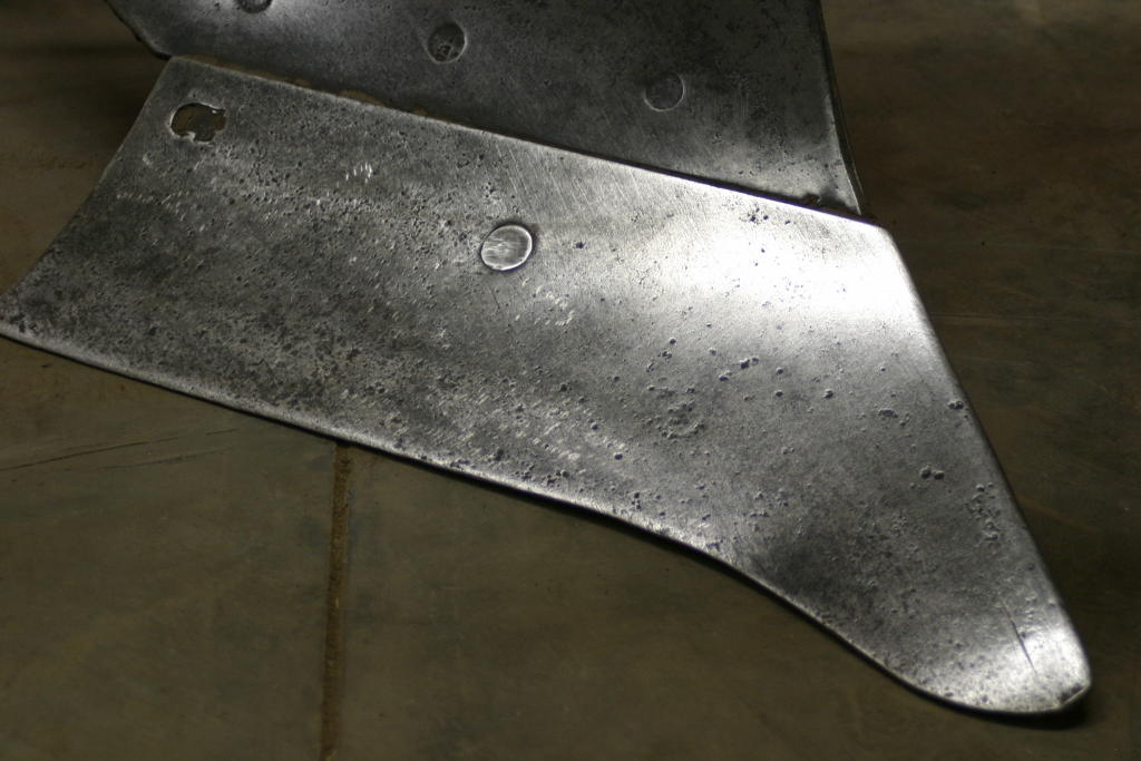

I think it's a 14".  The share number that is on it is 2512CR.  Looks like someone elongated the holes with a torch to make it fit.  It seems to fit good.  It's got some good rust pits in it so I'm not sure it will ever scour.

Plow bottoms don't define frames, nor frames define plow bottoms. They were sold independently. Most plow bottoms fit most plow frames and plow bottoms are different for different soils and regions.
That frog number was used in #24 bottoms, 12, 14, and 16", as well as #124 bottom 12 and 14". The moldboard was used only on #24 bottoms 12 and 14".
Making new holes in the frog might be the most practical way to fit a share that has about the right length and the right point angle.
As RFDeere listed, AC offered several different plow shares for different ground conditions and made of different materials. They also often offered narrow cut, normal cut, and wide cut for some bottoms indicating how far past the right bottom edge of the moldboard that the shares extended. But they also made few shares that interchanged between many plow bottoms. But landsides and coulters fit most every bottom. And were offered in several styles and sizes.
Ben Franklin Johnson may have bought the last AC plow share, there were probably some at Scotch Grove Iowa but they were all sold at auction and so far the buyer's haven't spoken up on this forum.
Scouring may surprise you. I had some rusty plow moldboards and attacked them with a flexible flap wheel on a 5" grinder and it took off the rust but the original steel surface was so hard it only polished it. Couldn't cut it.
As I recall seeing your share, it looks good for a lot of wear yet.

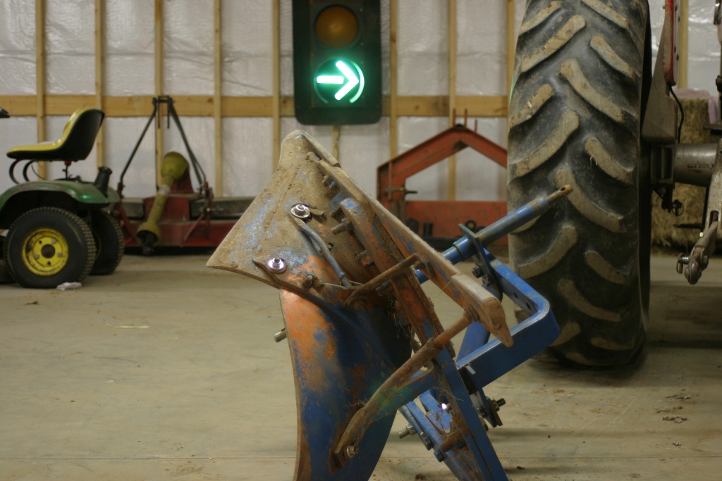

I took a picture of the plow share bolt.  It looks home made but I don't see why it won't work.
 My source for a new share fell through so it looks like I will have to make my old one work.  It's pitted so I'm wondering how it will scour.  I cleaned it as best I could.
Edited by AvillaMO - 27 Jan 2012 at 1:41pm

   The draw bolt is not factory, I can tell you that. Have you used this plow ? It looks like it is already shineing pretty good. What are you using to pull it ?

   I would about bet this plow will work just fine the way it is, if adjusted right.

Yes that hook bolt is home made. Look up your plow bottom in the plow bottoms book at http://www.grandpastractgor.com/phpBBS/index.php for a hint of a better picture. But what you have should hold the share OK. The pits will get sticky but will probably get polished and loose their stickiness eventually. I have an idea to help that, go to the farm store or implement dealer and by a spray can of Slipkoat or slipcoat, spray graphite paint and hit the whole share. It will wear down to the bare steel on the high spots and keep mud from sticking to the pits.

Here is the deal with the plow.  I bought it several years ago to plow my small garden.  I didn't realize at the time that plowing was a semi-technical affair.  I thought you just hooked it up and dropped it into the ground.  Needless to say I was disappointed with the results. This winter I've been trying to figure out how to be a better plowman.  I think my biggest problem was that I didn't realize that the plow had to scour.  With the help on this forum and the YT forum I've learned a lot and I'm truly grateful.  I don't have any relatives or neighbors to go to for any information so it's great that you guys volunteer your time to help a stranger like me.
Do you think the correct  share is just held on by one hook?
The share looks shiny because I spent an hour cleaning on it.  I'm pulling it with a Massey 165.

   The AC share is held on like this one is, by the hook and that other bolt.   I looked up a MF 165, that would be a 52 Horsepower, 6000 pound tractor. How far can you get your right tire in (center of tractor to inside side of right tire) ?
