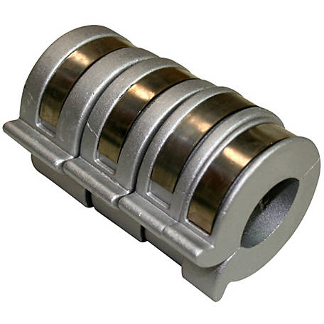

Are there any "styles" of stops that are better than others? I see Shoupes offers2 different types,although only 1 is offered as a "kit". Thanks

The ones with the ears are easier to change. The round ones we use on equipment that were not going to change the stop.

This is the style I use.

Me too trucker.  Sometimes I wish for a little finer adjustment though....

Yep, me too.  I got mine at TSC a long ways back.  They were like $12 for the set of 4.  I too wish there was a couple that were half thickness.

I've seen the aluminum ones like pictured above, and also some cast iron ones with a wire spring. I've always feared that the cast iron ones may be too hard and actually scratch the rod over time.

 Cast iron won't scratch a chromed cylinder rod.
