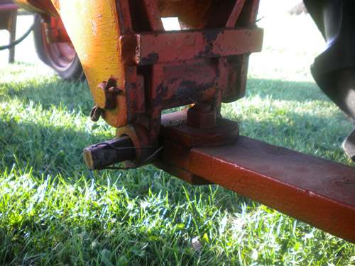

Newbie here. I have a good running Allis WD that came with a 3 bottom snap coupler plow when i bought it a while back. I am a little puzzled as to what it is i am missing on the setup. This is the setup i have where the drawbar attaches to the tractor. Note the pin from side to side.

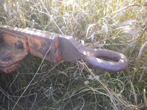

Now here is the end on the plow
I know this sounds stupid, but what am i missing? It's almost like that ring on the plow should be flipped 90 degrees, or that pin that is on the tractor should be going up and down instead of side to side? What gives? Thanks in advance for helping me out.

your missing the snap coupler.  Look at your post in thmorring someone will post photos of what it should look like.

Hot rod, you have a WD which never had a Snap Couple system until dealer installed parts came out with the 45. The plow is Snap Couple and would have pins for the lift latches. The pin hitch plow you need would have forgings that slide over the lift arms and get bolted to the lift arms.

Are there different hole sizes in the plow end for the CA and WD, or should the CA use a bushing??
ALLIS EXPRESS!
This year:
Post Options Post Options   Thanks (0) Thanks(0)   Quote CTuckerNWIL Quote  Post ReplyReply Direct Link To This Post Posted: 10 Apr 2011 at 12:06am
Here is a pin hitch plow. The lift links look like the ones on my CA's plow. I dont know if they would be right for the WD.
Post Options Post Options   Thanks (0) Thanks(0)   Quote CTuckerNWIL Quote  Post ReplyReply Direct Link To This Post Posted: 10 Apr 2011 at 12:08am
I don't think my CA plow has a bushing??  I do believe the lift links for the CA are different than what the WD had.

That makes a lot more sense. Thanks for the help guys.
