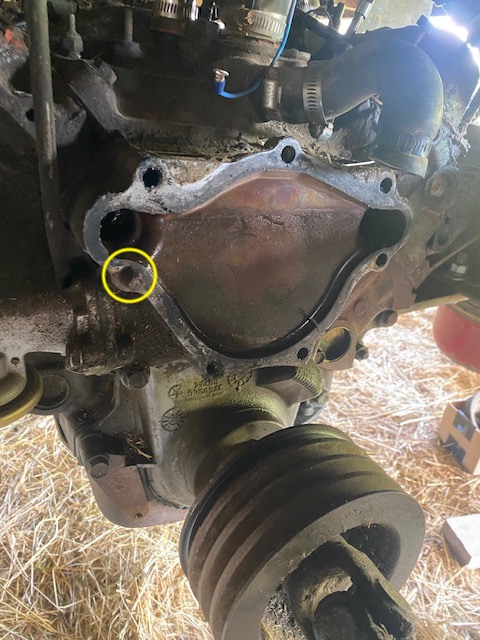

Quick update......with new replacement alternator, pulled the old one and was ready to install new........instantly ran into trouble. The lower, main support OEM alternator bracket is held in place by either two or three bolts......depending on the age and style of water pump......but that braket and the bracket to tension it is held one by only one bolt. One of 7 that holds the water pump in place. The key one.......the one that has to be used.......was found to have been snapped off inside the water pump housing. That bolt passes thru bracket, bracket, water pump, timing chain cover, then screws into the block.....and the end of it is open to coolant. So to install, a good thread sealant has to be used. No telling now many youtube videos there are documenting removal of that snapped off bolt. Now my turn to figure it out. Has been soaking in penetrating oil for days. Trying hard not to snap it off again as that would require removal of timing chain cover.  Exciting times.
Next question.........I now have 3 or 4 of these long bolts out, and hopefully 4th and final is coming out with no drama. I normally would plan to chase the threads in engine block with an oiled tap before putting bolts back. Problem being my 3/8" tap appears to be damaged (won't go into a matching nut without binding) and not long enough to reach thru the timing chain cover to get to the threads in the block anyway.
Do they make a longer than standard tap with 4 inch or so shank? If so, what is now a good brand to buy? What I have now are Blue Point, which as I understand it was an economy line of tools sold by Snap On. I may be able to buy Irwin or Hanson locally. Anything else to consider?

Post Options Post Options   Thanks (0) Thanks(0)   Quote modirt Quote  Post ReplyReply Direct Link To This Post Posted: 16 Jul 2025 at 3:32pm
As she sits now.........that big 4 belt pulley is in place of a harmonic balancer. Have no clue how that is being held in place.......and no desire to find out. But if that bolt gets snapped, I get to find out.

If you just want to clean the threads take a grinder and cut a groove or two through the threads of a bolt that is long enough to reach. I have done lots of times. Simple cheap and don't have to worry about damaging a tap.
Next question.........I now have 3 or 4 of these long bolts out, and hopefully 4th and final is coming out with no drama. I normally would plan to chase the threads in engine block with an oiled tap before putting bolts back. Problem being my 3/8" tap appears to be damaged (won't go into a matching nut without binding) and not long enough to reach thru the timing chain cover to get to the threads in the block anyway. Might be that the nut is not made to the standard of the tap. All that means it you're cutting more thread, and that particular nut would fit a little looser...
Do they make a longer than standard tap with 4 inch or so shank? If so, what is now a good brand to buy? What I have now are Blue Point, which as I understand it was an economy line of tools sold by Snap On. I may be able to buy Irwin or Hanson locally. Anything else to consider?  Try Mcmaster-carr, link below...

Not much progress on the bolt, except new plan to attack it. Have now added an induction heater to stable to tools. Have had more than one guy who turns wrenches for a living tell me that is what they use to free stuck bolts. For lack of a better way to explain it, seems to work like a microwave oven or some such........a coil is placed over end of the bolt and when you hit the on switch, energy waves are directed towards center of the coil (like a loose coil spring), with bolt positioned in the center. Some show it heating to read hot in a matter of seconds. No open flame as a torch or welder. Anyway, going to heat it up, let it cool and bang on it. Do that a couple times and hopefully bolt gives it up.
Interesting that I've now watched dozens of youtube videos of guys working on front end of these old 318 motors and that very same bolt is problem for 99% of them. Generally it gets broken (as mine was), then drama follows as guys figure out ways to get it out.
It may be a major design flaw. In normal use, carbon steel bolt passes thru steel alternator mounting bracket 1, then steel alternator mounting bracket 2, then aluminum water pump housing, then aluminum timing chain cover, then into thread in cast iron block (held in place by some nasty sealant), where tip of bolt is then exposed to some form of coolant cocktail. If for some reason, stray current finds it's way from alternator frame or electrical system you could have no telling what in terms of corrosion from dissimilar metals and all the rest. Bolt just gets chemically welded into place. Don't know if there is a non-metalic bolt tough enough for that duty, but would be worth looking into.

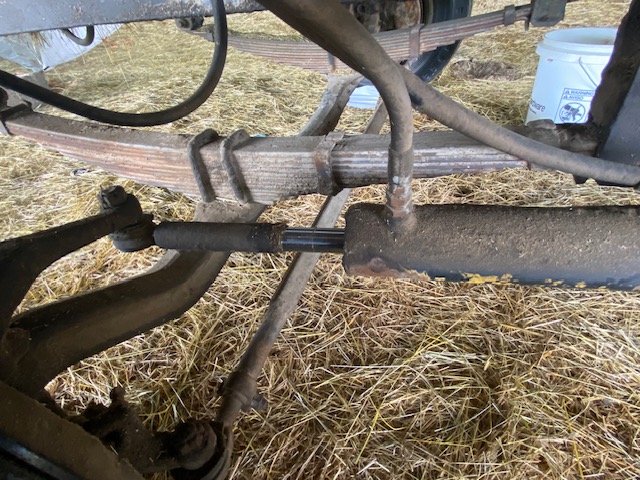

And while we are at it, here is another issue. Has power steering, turns left OK, but does not turn same to the right. Turn radius to the right might be 150 feet or so. At a T intersection, always concerned it will end up in the opposite road ditch or field on other side before it will turn down the road.
Looking for problems, I now see the steering cylinder has a hard stop on the shaft. Why would that be there? Either mismatched cylinder pulled from another use or maybe if it retracts too far it hits something? Once she is running again, will have to look to see if that is a problem. As is, using less than half the throw of the piston when trying to retract to turn right.

Post Options Post Options   Thanks (0) Thanks(0)   Quote TedN Quote  Post ReplyReply Direct Link To This Post Posted: 24 Jul 2025 at 12:55pm
Without seeing the whole cylinder this is just speculation, but maybe it is mounted incorrectly. That may be as far as the cylinder retracts, but you may be hitting the steering stop before it is fully extended. If it were me, I would pop the end loose from the steering arm and cycle it fully as a first step. You may just need to move the rear mounting point.
