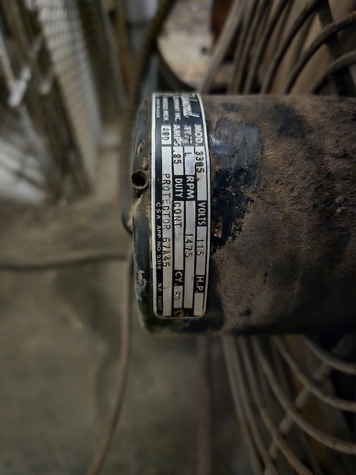

I'm going to see if i can find a replacement. Have good picture of tag on phone.
Points: 8759
Post Options Post Options   Thanks (0) Thanks(0)   Quote SteveM C/IL Quote  Post ReplyReply Direct Link To This Post Posted: 21 hours 27 minutes ago at 11:46pm
Not alot of success finding motor. 1475 rpm 115V .35amp continues duty 60CY,protector 67A45. I'm not much for electronics. Can you use a rheastat on any single speed motor to trim it down on rpm without harming motor? Does it require a "special" kind of motor?

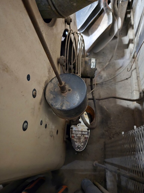

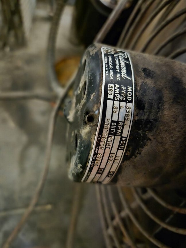

Post Options Post Options   Thanks (0) Thanks(0)   Quote SteveM C/IL Quote  Post ReplyReply Direct Link To This Post Posted: 9 hours 10 minutes ago at 12:03pm
Got better pics and some info I posted was wrong. Ask a member to post them for me.

Points: 8759
Post Options Post Options   Thanks (0) Thanks(0)   Quote SteveM C/IL Quote  Post ReplyReply Direct Link To This Post Posted: 2 hours 50 minutes ago at 6:23pm
Wired up motor only. Ran full speed for about 50min then started slowing down. It kept dropping rpm and at about an hour run time it just died. temp was 180. Took it apart. Brushless. No sign of touching fields. Has a little fan on shaft end internally. It spun freely on motor shaft. Got things pressed apart to get to little fan mounting sleeve and applied red loctite. Will reassemble and try again. Find it hard to believe the loose internal fan is the problem. Will see. Otherwise a small pedestal fan on floor behind stove might do the trick.

Post Options Post Options   Thanks (0) Thanks(0)   Quote AC7060IL Quote  Post ReplyReply Direct Link To This Post Posted: 2 hours 28 minutes ago at 6:45pm
Points: 8759
Post Options Post Options   Thanks (0) Thanks(0)   Quote SteveM C/IL Quote  Post ReplyReply Direct Link To This Post Posted: 2 hours 21 minutes ago at 6:52pm
Thank you 7060 for posting my pics.
