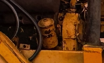

Hi all,
I've been resurrecting our old HD9B and it's actually running very well, thankfully! I've been searching the web for a replacement oil filter cartridge with absolutely no luck. The existing (30 yr. old!) cartridge is about 6 in. long and 3 5/8 in. diameter. The outer housing has a label on it with AC markings as opposed to General Motors. The filters I've found for the 4-71 are substantially larger in length and diameter.
By chance, would any of you know of a source for the stock HD9B oil filter cartridge? Many thanks in advance.

AC was at one time a division of GM, what number is present on that cartridge can?
By one listing a WIX 51242 just under 6” long and 3 5/8” diameter should be it. Should be a spring and cup at bottom of housing that keeps the filter against the engine side filter head.

DMiller: The label on the outer housing was illegible. However, I didn't think of looking for markings on the cartridge itself. I'll do that over the weekend. Also, there's a spring and large flat washer inside the housing and on TOP of the filter cartridge. I didn't pull the cartridge out far enough to have a look underneath. More to come...

OK. I pulled the existing filter and the PN (WIX 51005) was printed on it. I purchased the LF530 and will post a fitment update once it arrives.
AC 079640 - Discontinued
WIX 51005 - Discontinued
Fleetguard LF530 - Available

Just wow! The Fleetguard LF530 was about 1/2 in. too short. The inner and outer diameters are correct, just the length is too short.
Does anyone have the drawing for the original AC 079640? Or by chance, would anyone have an old, used AC 079640 that they could measure and share the length of?
