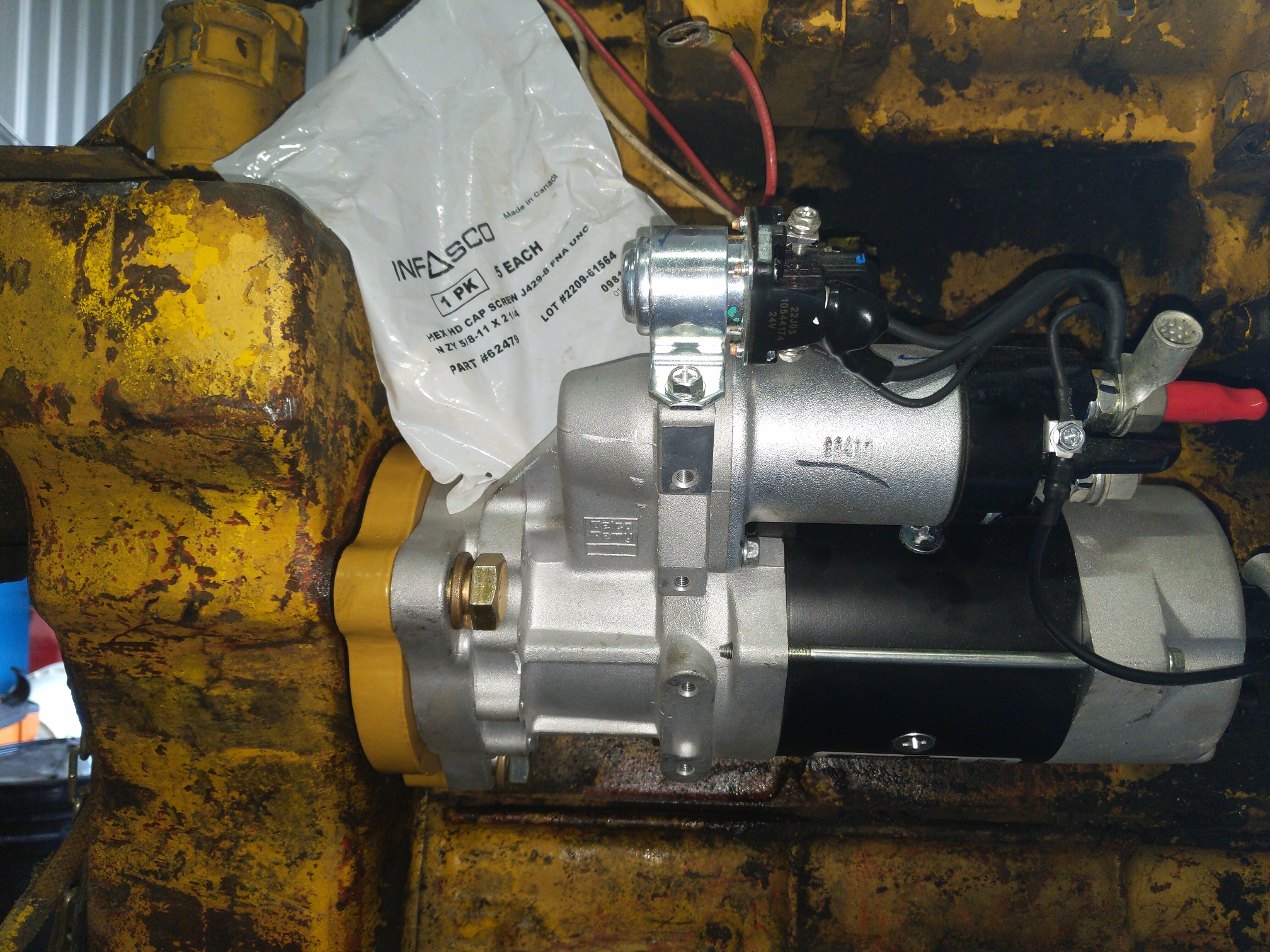

Post Options Post Options   Thanks (0) Thanks(0)   Quote DieselBumpkin Quote  Post ReplyReply Direct Link To This Post Posted: 08 Sep 2023 at 8:53pm
I installed the starter on the 6000 and used the plate. This starter TURNS the engine with ease.
Since I have the engine on a stand, I didn't bother bonding the ground. I made new cables today using the AC parts book and was very pleased to see the lengths listed next to the part numbers. I am going to have to pull the ground strap off the dozer to get the length for that and see what diameter the stud is on the chassis side. I remember the strap being somewhere around 8 inches or a foot long.
