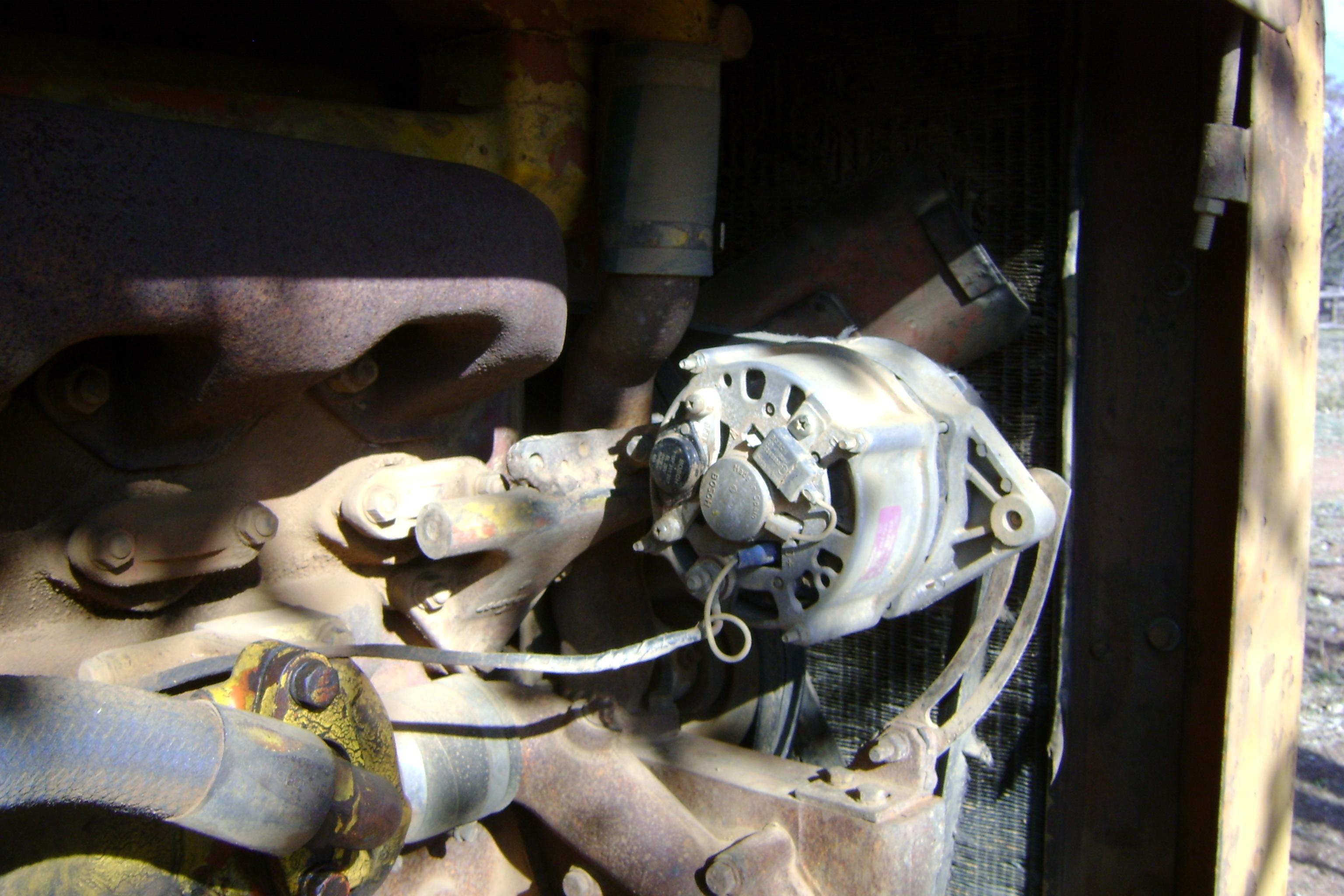

I put one on my HD11S, I found a bracket online that only needed minor modification. Been running it for 4 or 5 years now. I found the one wire alternator on eBay for $60 or $70 I think. I had a pulley in the shop to fit the wide belt that was on it.

I've never done this on an HD6G but I have done it on several CAT track loaders. On Caterpillar it's fairly straight forward but it pays to check which alternator most easily applies to the conversion. I bought the bigger Delco 24V, single wire, as the mounting became far simpler to retrofit than the smaller one.  Use a tape measure and a bit of visual judgement and you'll do just fine.

I did this on an AC Forty Five grader which IIRC has a similar front end to yours.
I used a Bosch 24 volt single wire which is our common go to.  It uses a foot mount and you get a mounting bracket to suit.  I just lined everything up and welded the bracket to the Allis generator mount.  Even used the Allis slotted adjustment strap.  And the pulley from the generator.  No keyway in the alternator shaft so had to use Locktite to hold things down.

I did my measuring but those sheets went with my 7G.  If you have a 344 in yours, I cut down the old Generator mount, thru drilled the old single bolt holes to 1/2" then cut the nose set back for Alternator pivot followed with cutting the rear.  I used a Commercial 1/2" wide Two Groove belt pulley so could use the Allis Original Genny belt.  Just a Generic 24V Fleabay 'New' Alternator.
I did then Change the entire Start Charge circuit to Negative Ground from Positive, Started Fine Charged great.
