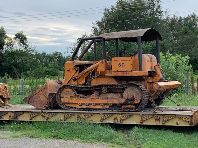

I have an HD6G that sat for 15 years or so.  I started right up after a battery change and new fuel.  I seems to be getting fuel into the crankcase.  I could use help with the cause and how to repair.  Possibly the fuel transfer pump?Thanks in advance.
