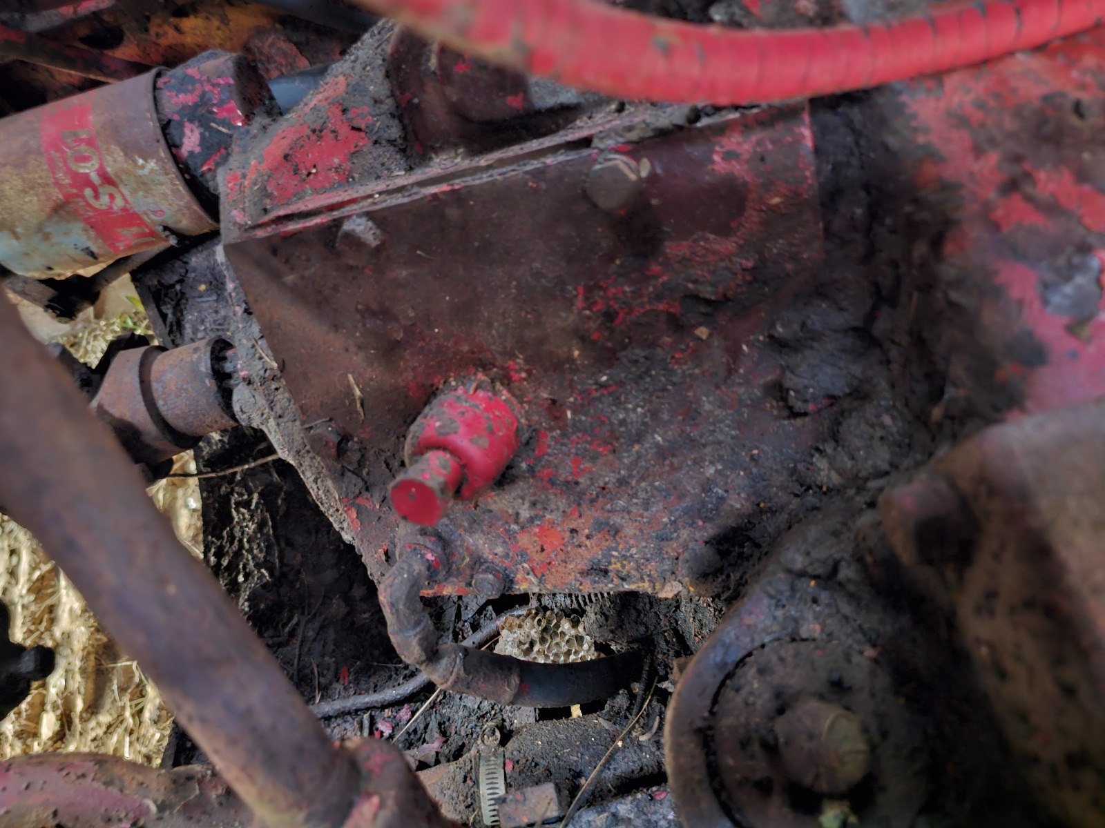

Hey yall helped me a lot last time I was on here got another ? I'm trying to figure out which type clutch I have on my HD6G loader. With a hose in the cover makes me think it's a wet type. But there's also some kinda bolt thing sticking up from the cover that's not shown in the books I have on the loader any ideas what it is. Thank yall

My HD6 dozer has wet transmission clutch and dry steering clutches.                    MACK

Does your cover plate look like mine?

filter hanging off the back says wet clutch, mine is dry and does not have that.

Thanks yall it took some heat but I got the dip stick out and it's bone dry. With some eust on it so it's been dry a long time. How much does it hold? My dip stick has no markings left on it and don't wanna overfill it
