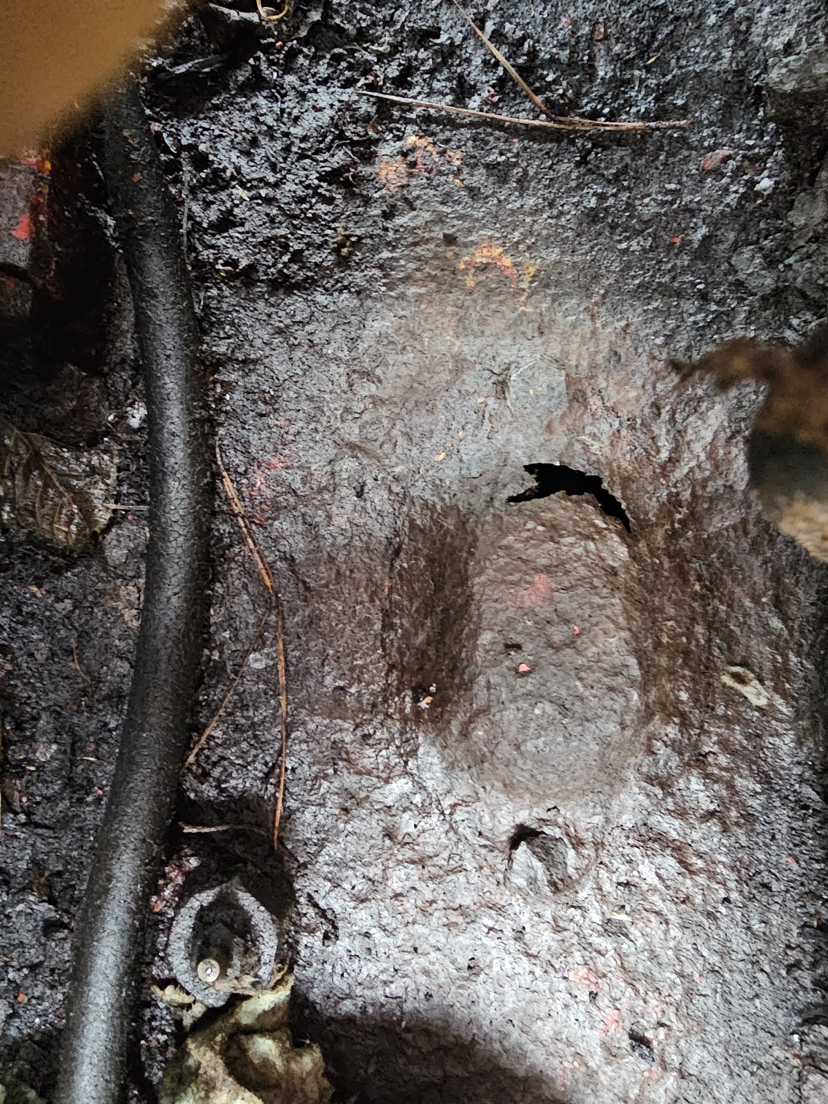

Post Options Post Options   Thanks (0) Thanks(0)   Quote Jhilton69 Quote  Post ReplyReply Direct Link To This Post Posted: 09 Aug 2023 at 5:43pm
Well found the cap this is what it looks like. Apparently someone in the past tried to cut the bolts instead of taking thier time and doing it the wrong way. Started raining on me so I had to come inside. Anyone know a place I can get a new cap from this one has a hole in it. They did the same thing to the bolts on the other side as well.

Post Options Post Options   Thanks (0) Thanks(0)   Quote Coke-in-MN Quote  Post ReplyReply Direct Link To This Post Posted: 10 Aug 2023 at 2:45pm
Don't think i saved those of rear housing I junked .
Might try cutting a plastic bottle and covering them with it

Post Options Post Options   Thanks (0) Thanks(0)   Quote Jhilton69 Quote  Post ReplyReply Direct Link To This Post Posted: 10 Aug 2023 at 4:19pm
Last night while I was trying to sleep which doesn't happen often I was thinking I got an old cat out here and was thinking bout cutting the flat section of it and making 2 boxes to replace them with. Are there gaskets that go under them?
