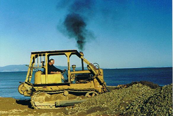

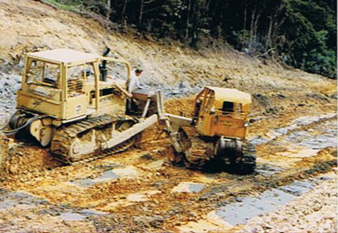

Some HD6EP pics for warren Lucas.
First 2 are 6ep19942 with a E30ps winch earning 2 boxes of beer off the operatop of a cat D6D; and no thats not me im the one behind the camera
next 2 are of a certain tubby tractor driver sitting on his noble steed.

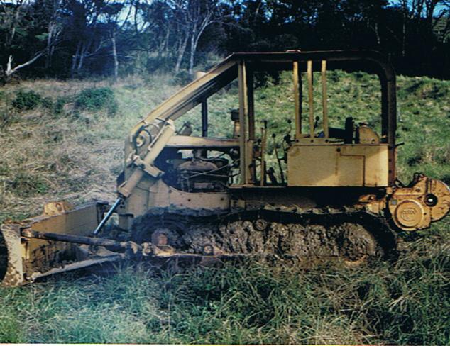

Might as well add 2 more to complete the line up of models
A HD6E and 2 HD6B models. All Bs sold over here after 14484 came with the 5 roller frame and oil master clutch
I once saw this old HD21A; one of the first with the 21000 motor; that had been sitting derelict for at least 7 years, and had actually sunk about 6' into the ground. Anway someone decided to buy it and they came over with some new batterys, checked all the fluids, and pushed the key. It wound over for about 10 seconds and roared into life to everyones amazement  Tongue    Guy who got it used it to tow a big old LeTourneau scoop.

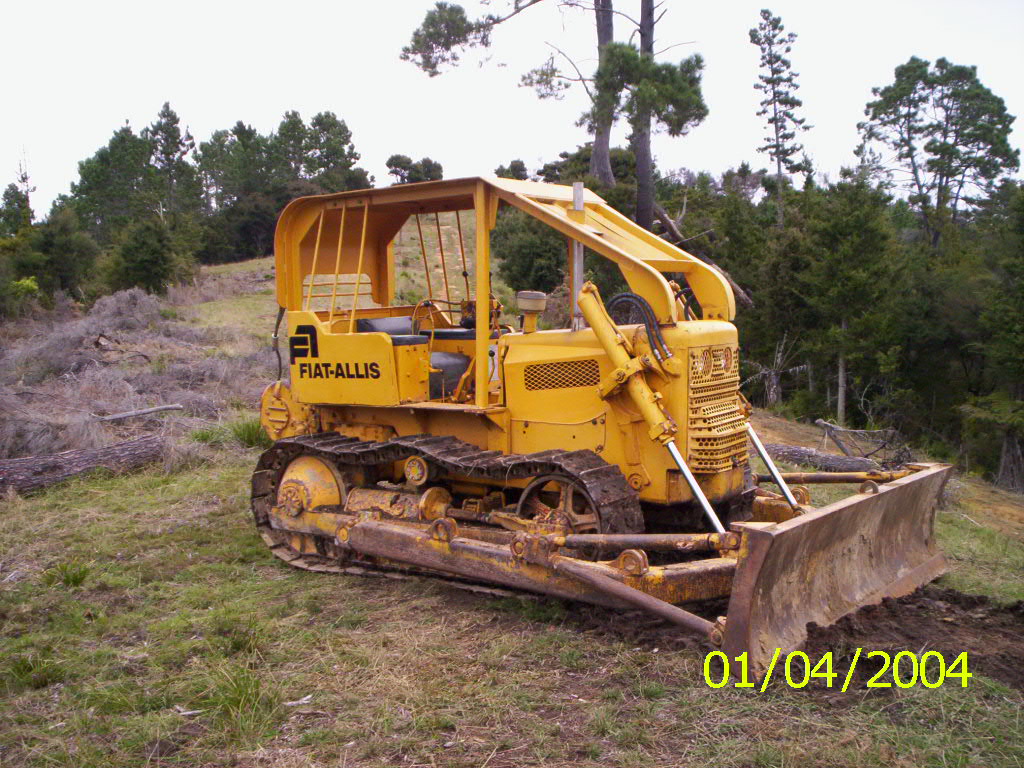

Hi Merv
The photo you have in your post taken/dated 2004, is that tractor in the Bay of Plenty ?
HD6 EW, first sold by Cable Price Tokoroa, then sold to a buyer in or near Taupo, had low hours when traded in. This may well be a tractor I can add some details about if its the one I think it is. Hope you get this reply and can put up another post, I would really like to track it down.
Regards
Dave.

Hi Dave

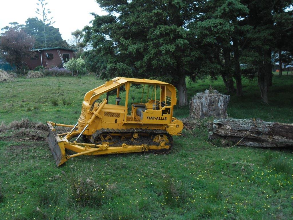

The Fiat Allis branded HD6; is 40M25210 one of the very very last ever made, and sold in NZ is what we kiwis call a 6EO; it isn,t a EW series.
Is came from the taupo area; and was for sale on trademe many moons ago. Got sold to a guy in whangarei who wasn,t overly smart with machinery; and subsequently ended up in a mate of mines possession in whangarei.

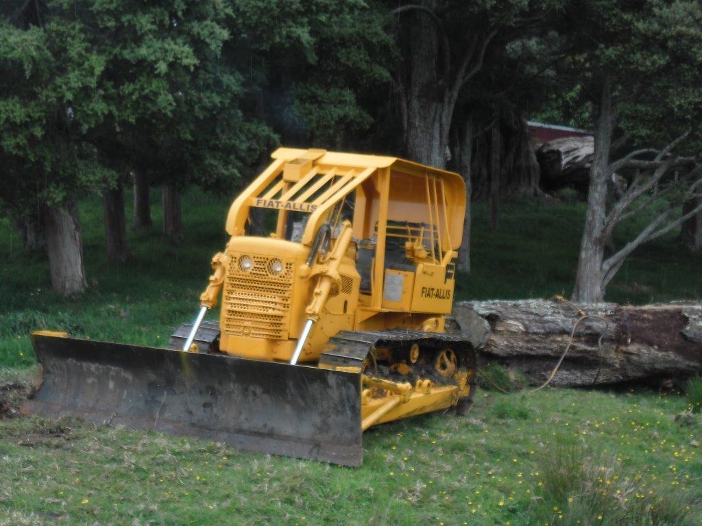

here it is; I hope !   pic taken this year after a engine job and a repaint

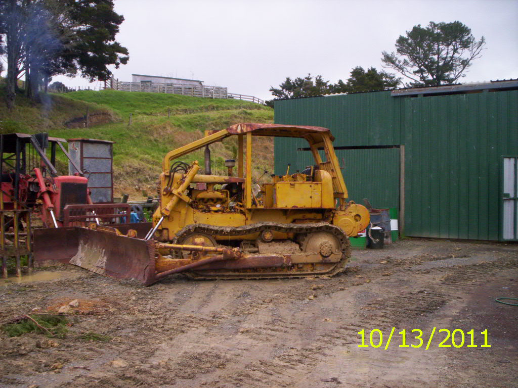

couple more pic of mine I hope ??
