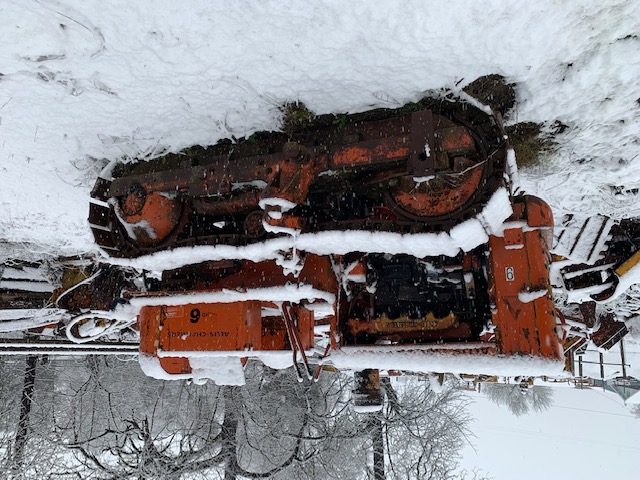

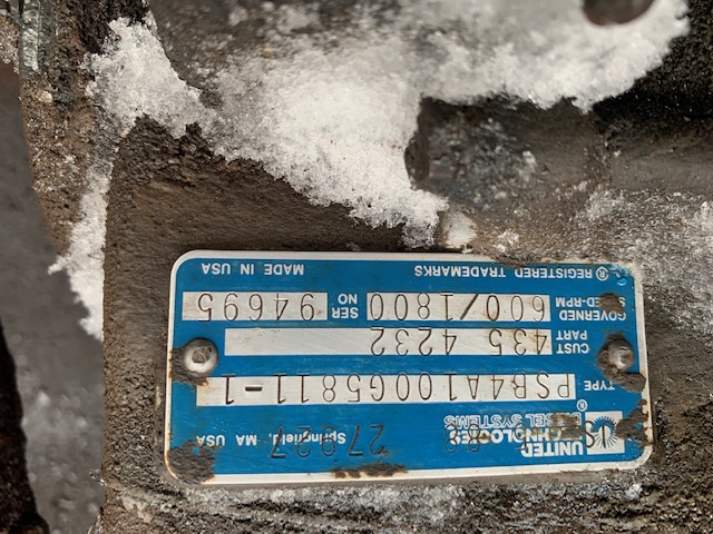

Merv...Thanks for coming up on the air..hoping you would. NO ...we did not check the delivery valve first...we were so sure we had other problems. I removed it yesterday. Started to remove the pump from the donor tractor yesterday also......this is the donor tractor today....yes the snow will win out today.
So here is the specs. from the donor tractor
Here are the specs. from the EP pump.
This would be the model number designation from the AC PSB service manual that we have...657398(9-66)  I believe it to be the last one but I'm not sure.
So...my questions are the American Bosch Part Number designations? Do you have a separate Bosch book or the AC book? For instance...what is the difference between...5299A5....5299A1...5299B1...etc. These are some of the different numbers we have in our inventory of tractors.  I'm thinking a Bosch book would share those designations better. I realize  that donor tractor designation numbers are different ....what is the difference?...what is the difference in the EH...as in the G stands for governor?   I'm thinking that info is in a Bosch book somewhere.

1 Take it you have checked delivery valve, that is the wee valve and spring under the plug on the side of the head.  People wrongly try to bleed them there. And can disturb the valve and spring.  Right place to bleed them is plug in centre of head, where 4 fuel pies come out
2 Pumps on all 6000 engines i 'think' are the same. . BUT 6EP pump delivered more fuel; they are 75hp vs 69hp.
3  done some digging now. . . ! as got a PSB book  Pump for engine 6-16359 up, in a EP up is psb 4A-100EH-5299A4.    fuel delivery at full load is 47-49cc
pump for HD6B and E, engine s/n 6-16084 to 21976 is PSB 4A100EH-5299A
pump for engines above 6-21976 is PSB 4A-100EH-5299C1
full load fuel delivery is 43-45 cc.
timing for both pumps is 28 degrees BTDC.
I did play with pump on my HD6E19541 as it was sum what 'undernourished' and took cover off governor and increased fuel delivery till i got some 'boogy'.
Torque converter stall speed; which is the poor mans dyno on a HD6EP is 1840 rpm + or- 10rpm.
So maybe abit of food for thought there boys.  Nice looking EP there, AND a powershift Carco E30ps winch, got to be a bonus.
Only other bit to add is talk to warren lucas in australia , he is a HD6EP guru, and i know you fellas know each other  !
Cheers from New Zealand, Mervyn Pepper.

Hi Mel
Not HD 6 but I played in that paddock when I was getting our AC Forty Five grader going a while ago.
In amongst the learnings was that they played with pump plunger size and that seemed to flow through to injection timing.
One thing that might be of use to you is that the pump model carries the plunger size -
PSB 6A 100 EH is a 10 mm plunger, timed 28 degrees
PSB 6A 90 EH is a 90 mm plunger, timed 32 degrees
FWIW

Ok...We recently acquired a HD6EP...inoperable at this time...no history is available. When we first visited it in 2015...fuel injector lines were off of the pump....of course leading us to believe it had a fuel problem. Ok...fast forward..8 years later it still has a fuel pump problem LOL.
 We were able to get it pushed on our lowbed and get it home.
 We didn't have to much of a problem getting it loaded with a bigger loader
We weren't even sure if the engine would turn over knowing how long it had been sitting. Some of us are quick to point out about trying to turn these engines over after sitting for fear of damaging the PSB BOSCH pump...made of unobtainium.
So after we unloaded it....a consensus of a committee...the 3 of us Brannen,David,and myself...decided what the hell we already suspect a fuel problem...we'll go for it.
So we did all the normal prep....fuel..fuel to filters...fuel to pump..fuel in the tank...oil..water. Batteries...it turned over very easy.  We get some fuel out of the pump..but not enough...it acts a little different than a broken plunger.   We used either twice..it seemed to run fine...so that was encouraging.
So...we got it put in the shop...and we're going to get close and personal with this pump.  So I'm looking for help....maybe our friends down under...you guys seem to have more knowledge about thees HD6s than a lot of people...So I'm listening.
  What I really want to know...is the difference in the different AC part numbers of the pumps. We have the AC service and parts manuals for the PSB pumps.
We have the parts manuals for ....I think all different serial number tractors..A,B,E,G,EPs whatever. We have the master numerical index..the master numerical index for discontinued numbers.  The master number gives the super seeded to or from...or whatever. so in our collection of parts tractors we have some.....donor tractors that have pumps that might be usable from running engines.  So I gathered pump numbers and engine serial numbers. So ...yes you guessed it. There are a lot of pump part numbers that are on pumps that are not the number in the parts book. Most of them show up in one of these numerical books somewhere. Some of these number changes could have been as simple as...they changed the size of the safety tie wire on the out side of the pump. LOL having to give it a whole new number.  It appears that there isn't much difference in the pumps from one tractor to another? We do not have any info on the BOSH PSB pumps from BOSCH...those numbers stamped on the pumps are very similar...leading me to believe the pumps are similar. Does anybody have BOSCH specs? We have a 1970 model HD6EP.....That has a turbo...yes it probably didn't come that way. So basically it's a 7000 engine.....this AC pump part number is the same as a HD6E direct drive donor tractor that we have. The 1969 6EP here in question has no turbo as is should not.  but it also has an engine serial that is 2000 newer than the 1970 model....leading us to believe that a complete engine swap was done. In a previous life it had belonged to the state of California...that would be there style.
  So...I'm going out now.. to trouble shoot through it and maybe use the head of of the donor pump...or maybe the complete pump if need be.  I've learned to be a good listener...if someone has some thoughts.
