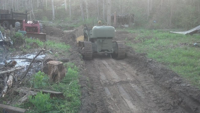

Hi, just wanted to give you an update on my HD5G. Its been a workhorse champ! Not thrown a track since. Engine is purring like a kitten, but roars like a tiger under load. My cleaned injectors and repaired governor are working awesome too. This machine needs a well deserved paint job. I couldnt be more happy with it. Its working for me digging out a canal trench for my microhydro electric project. Hope all your projects work out as well as mine is now. Big smile

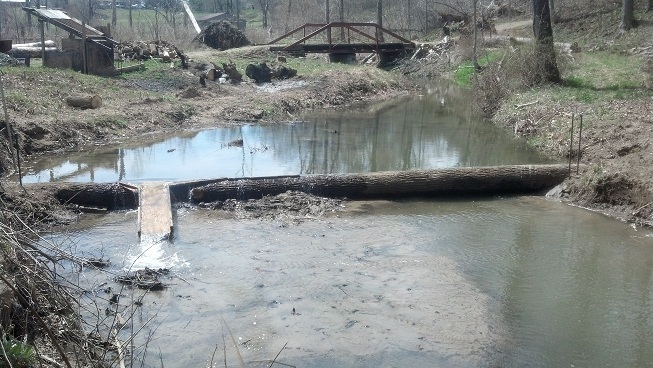

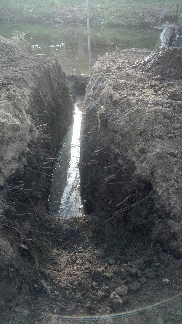

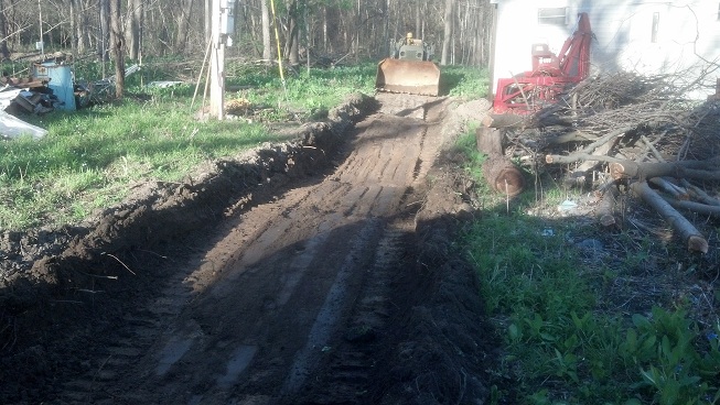

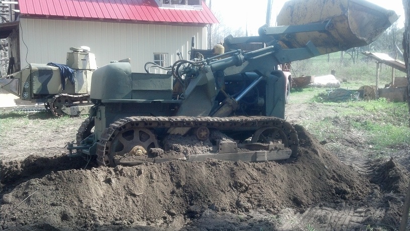

Post Options Post Options   Thanks (0) Thanks(0)   Quote rwhendrix Quote  Post ReplyReply Direct Link To This Post Posted: 29 Apr 2014 at 6:33am
A few more pics of the HD5G and the microhydro project.
