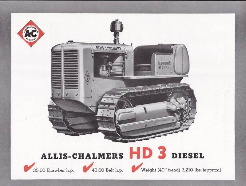

Here is a photo of a 1942 HD3 taken from a sales brochure.
There was one of these crawlers for sale on Ebay about 18 months ago. I have lost my photo of it due to changing computers. I think it was located in Utah or Montana. I believe the sale was completed.

  That 's it in the picture.  Does anyone know how parts cross over ?  I do have an original parts book but need steering clutches for the right side I believe. It runs and moves just will not turn right,  and smells of 90 wt oil in the r/h clutch housing cover. I live in Idaho and just purchased it this spring off craigs list. Any help would be great. Also is this rare or worth fixing for use around my poperty?

Terry, Only 28 of these crawlers were ever made, in 1942 only, so they're definitely rare. Little information has been published in any AC reference books about them but one book does state "the HD3 was apparently built on the M powertrain and tracks" so steering clutches for a model M would be a definite starting place. Some other U.S. members will be better placed to tell you where they are available.
Good luck with your repairs and please save this rare crawler.
