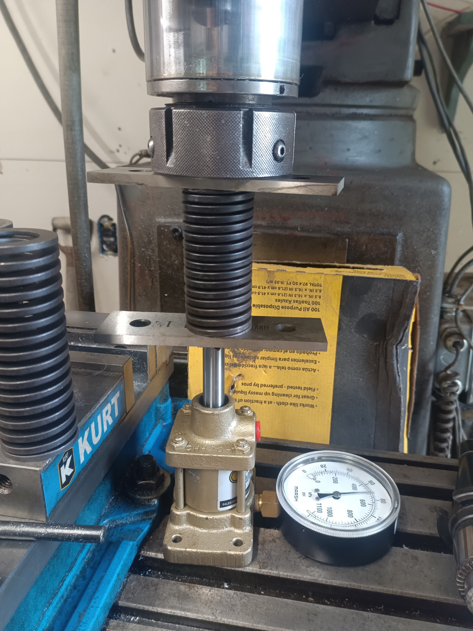

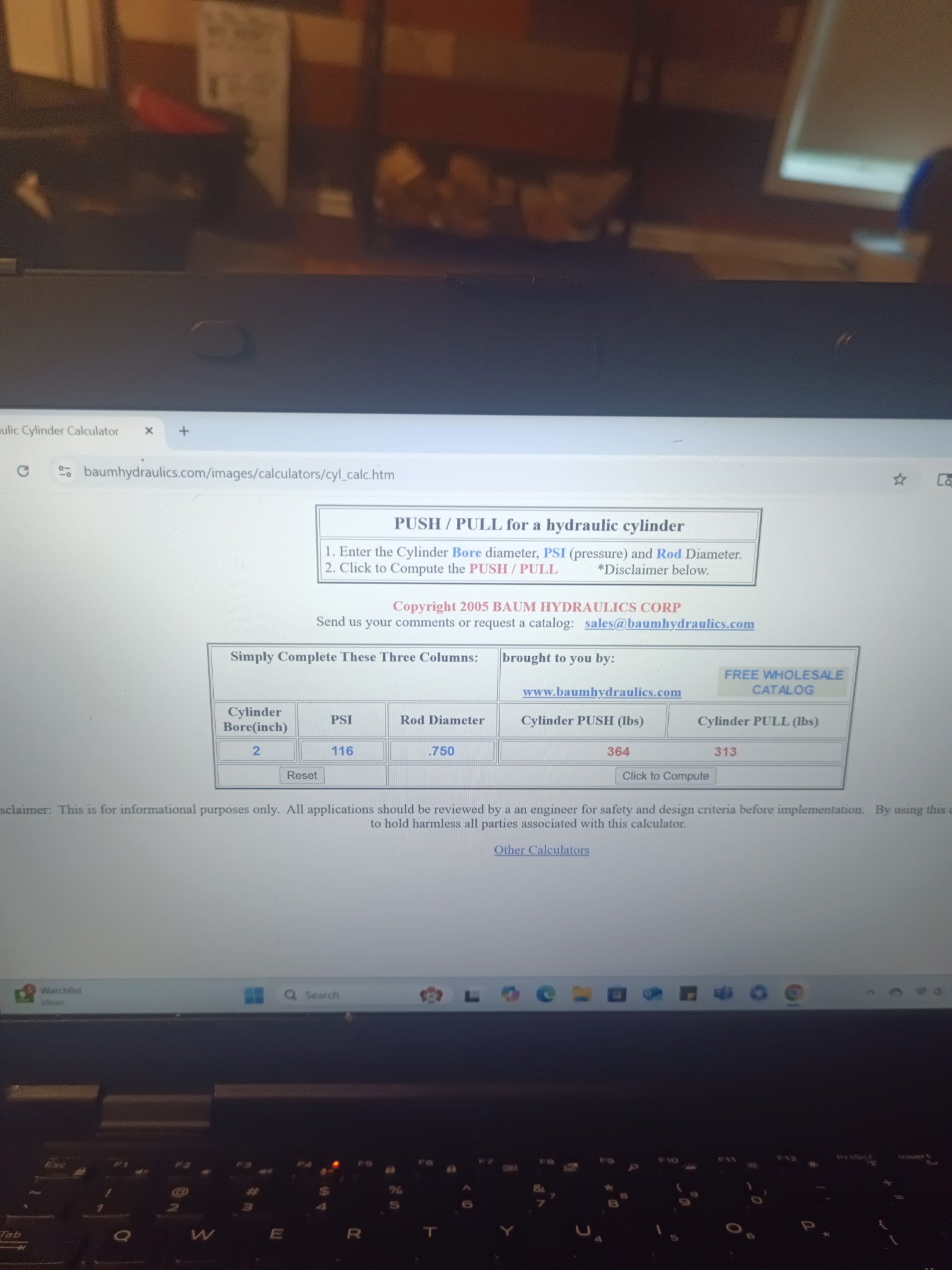

yes i did test them used a short stroke hydraulic cyl 2 inch bore filled with oil and a pressure gauge installed in the port and the quil on my cnc mill to push the spring down on the rod to checking height 3 11/16 inch then used a hydraulic force calculator from baum hydraulic to psi to calculate 335 and 365 psi  365 =115 at gauge reading i think 106 was 335# i checked 4 new springs 2 were 60#,1 was 65 and 1 was 72#.Next i stood on the end of the cyl and balanced on it it come out to me weighing 220 lbs, the bathroom scales showed 223 lbs so i feel its a solid test. i have some pics in my phone of fixture and readings i will try and post. I called general gear they seemed like good people i'm probably going to send them back , i do feel the were probably imported parts. The thing that sucks i work as a maint mech in a 2,000,000  square foot caterpillar facility in morton il and its not a d6Cry.

All I can say is your numbers check out correctly on my calculator; it certainly appears that you have weak springs Ouch

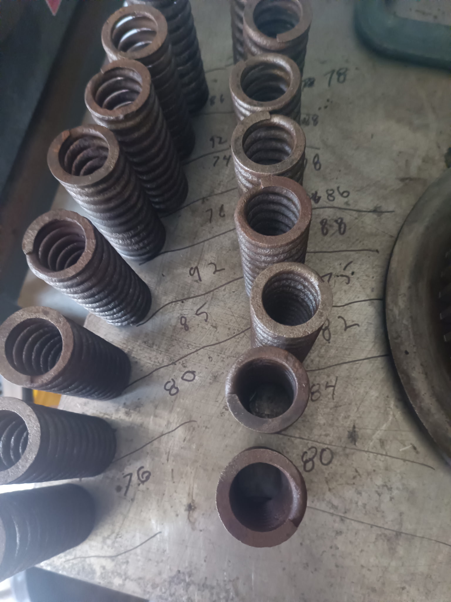

Like Les said your numbers are correct, 2 inch bore is 3.14159 sq in, so simply multiply your pressure reading by 3.14159. Those springs don't look like the ones I have, mine are   round stock like the old ones you show. When I rebuilt my clutches the springs in one side were broke to hell. it looked as though somebody stacked round stock lock washers where springs used to be, they were all broke into 1 coil turn each. I still don't understand that.

I decided to try and cutdown the wet springs heat and fold the tails regrind the bases the picked 8 wet springs and 8 dry springs alternated them 4 in a cross on each hub my total calculated pressure from all 8 springs are in the 3750lb range at 3 11/16 but the wet springs build pressure quicker when compressed farther so i hope it works i will let you know how it turns out figured i had the parts and they were not really good so i might as well try.
