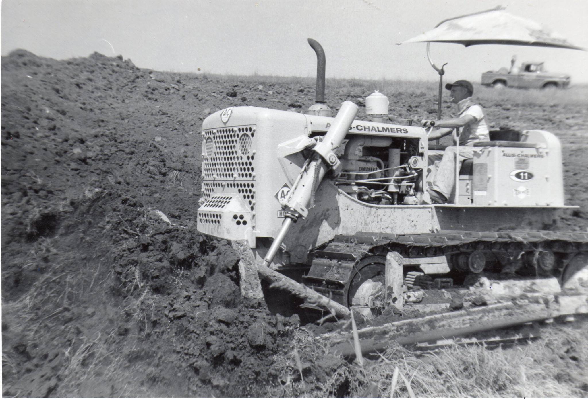

Cooke Tractor came out and took a picture of my great grandpa right after he bought it to promote the HD11EC. My grandparents found a copy of the picture a few years ago.

Very nice old photo.  Looks like '61 or '62- dry steering clutches, and the oil bath cleaner by the looks of it...
