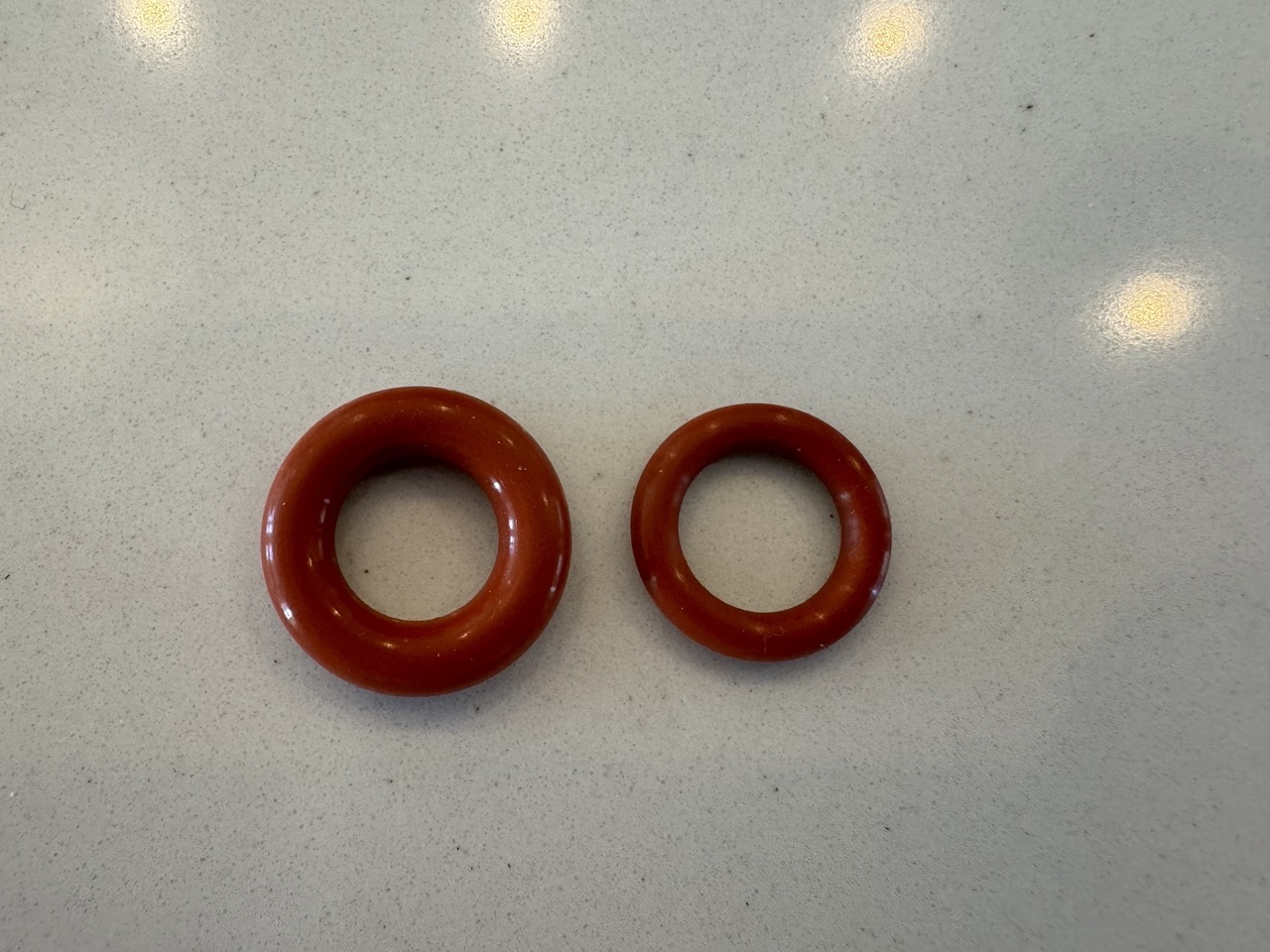

I have spent the last week trying to find the right sized O-Ring for the hydrolic adjustment Knob C. As well, spent a good chuck of the day trying to find an O-Ring locally, however.....  no luck. Everywhere I went today which was NAPA, Auto Zone and Advanced Auto only had these skinny O-Rings that would not work. DJ's and YesterDays Tractors also had nothing!
Thank goodness for the internet.  It took me about an hour to figure out how to search for a sized O-Ring...... which is now quite obvious!  The "nomenclature" for O-Rings is the following: 1/2" ID, 7/8" OD, 3/16" Width.  If you search, you will find multiple options.
Thus, I ordered from Amazon, 1/2" ID, 7/8" OD, 3/16" Width  and 1/2" ID, 3/4" OD, 1/8" Width.  I expect the 1/2" ID, 7/8" OD, 3/16" Width is the right one....... we will see.
The obvious part is the math - it all adds up.... ID + Width X 2 = OD!!!

The "O" rings I ordered for the hydraulic's arrived.
The 1/2" ID, 7/8" OD, 3/16  which is on the right of the picture is what I will put my money as the right one!
The left O-ring is to large: Was the 1/2" ID, 3/4" OD, 1/8".

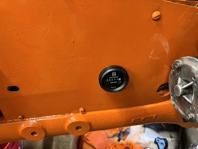

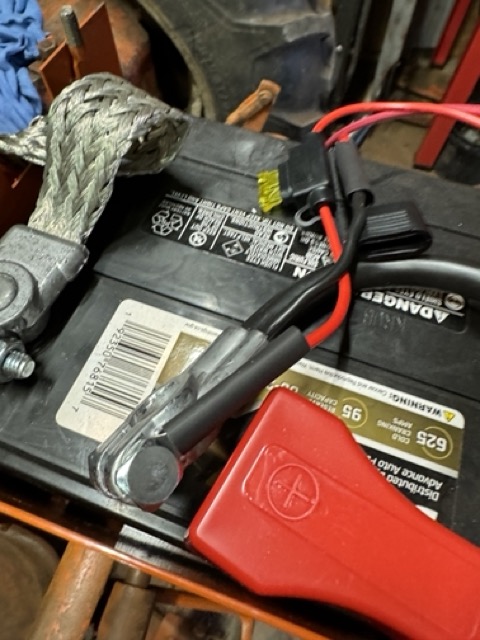

Was able to spend a few hours today.  Did a number of little things.  A bolt here and there.  Clips to hold the wiring harness in place and a bit of touch up paint (kinda of an obsession)!!
Also a bit more wiring and added fuses just as the wires come off the battery.  Also "pulled" a wire for the hour meter.  Next is to assemble the key, light switch and toggle.
And the hour meter. Plan to tie this into the toggle switch such that it is close to hours the engine is running. Thus, able to turn on the key, and run lights and other without running the hour meter.

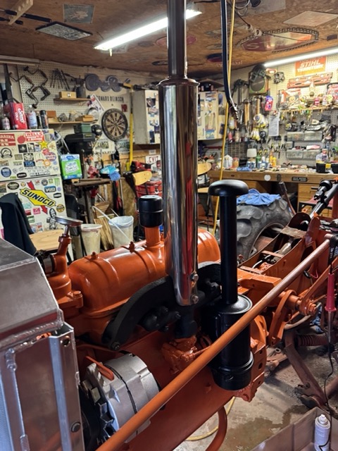

Re-installed the muffler!!!  Yeah my ADHD got me..... saw the muffler and new stainless steel (SS) bolts and thought that would be fun and quick.
Well not so quick... yet was fun!!!  While we tapped the upper threads after breaking the bolt off in the manifold, despite panther piss and heat (prior post).... we did not run the tap on the lower threads.  Thus, tapped out both again and then installed the muffler with the schedule 8 stainless steel (SS) bolts to have a strong bolt that will not break next time they are removed (note prior post discussion)!
Love the SS Muffler!!!

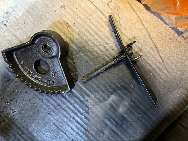

Finally, put together the throttle lever from the "family CA."  Assembled the spring and retaining clip.  Applied a final touch up paint and will instal this and the starter pull this weekend.  This is one part of the tractor that I may regret using white primer.
I suspect the white primmer may show with a bit of use and wear.  If so will get black primer and redo this piece our touch up with black paint.

It's sure coming together nicely!  Looks GREAT.
Couple a questions,,,,,,,
Where did you get the muffler?  What number?
What number is the DieHard battery?
Thanks

Thanks Ted!!  I will get the DieHard number tomorrow.  The muffler is from DJ's.

Ted,
Here is the DieHard Battery. Model 85-2.  This is 8" H, 9.1" L, and 6.9 W.
The Manager at the Advanced Auto distribution center I went to, was awesome....  I had the dimensions of the battery box and we walked around and found this one that fit with a bit of extra space.  The DieHard was one which was not totally over the top in price.
