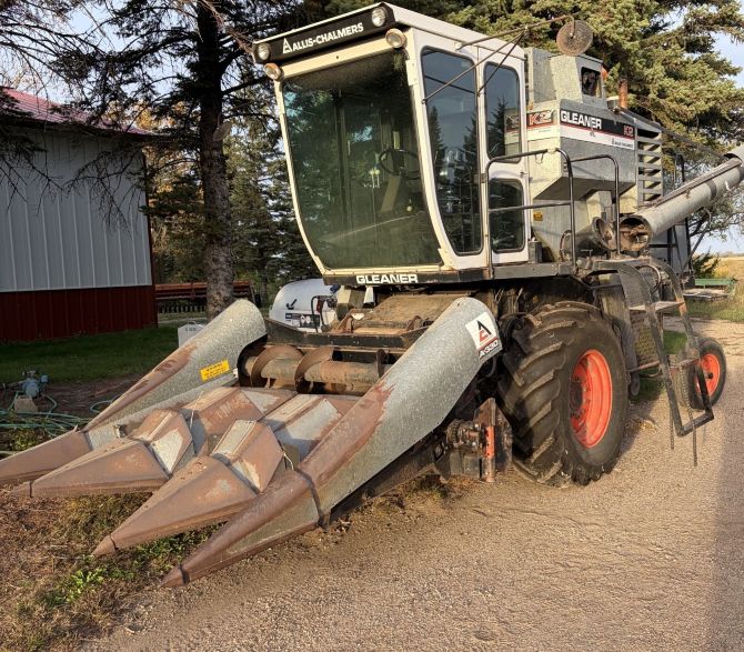

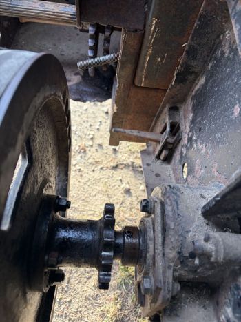

I purchased a '78 K2 Corn/Soybean Special a couple years ago, that came with a grain head. This spring I acquired a low profile black A330 corn header, from a gentleman who had used it on multiple K2's for his test plot business. I assumed these would be similar vintage and align.....I discovered that the sprocket on the cylinder drive shaft on the combine is about 1" off to align with the innermost sprocket on the corn header. Any advice?

You need the double 13 tooth sprocket on the thresher countershaft - will try to get pn tomorrow.
