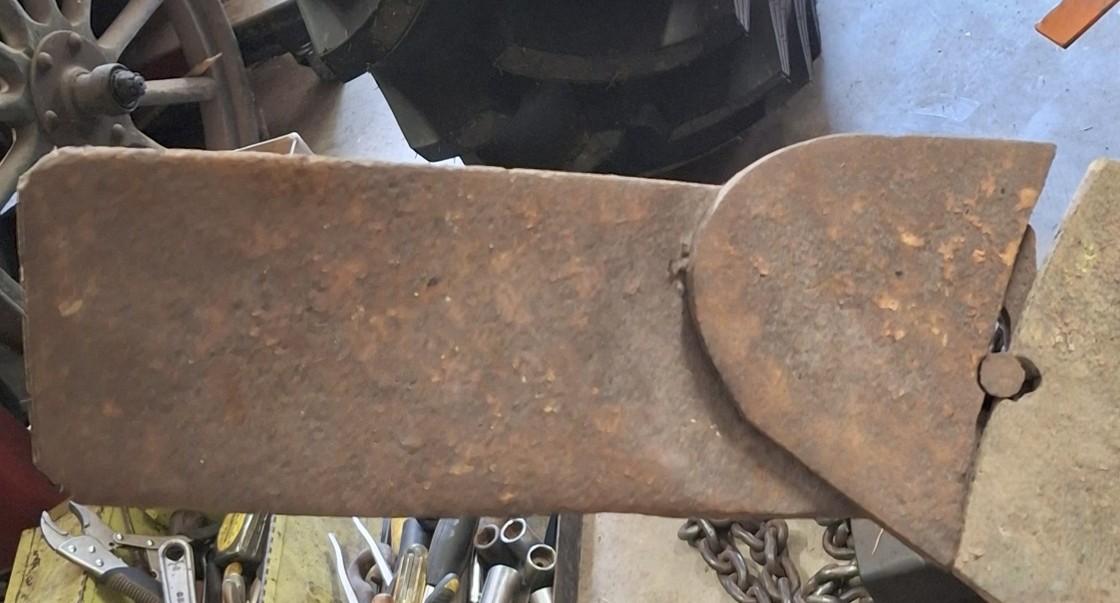

I have enough parts to make one good bottom set.  The other is all broken/welded.  It will be functional, but I'd prefer it if I could find replacements in decent condition:
MB:  309211
PS:  308807.  I don't like the way that seam looks and may work on it myself some more.
Formed a hook and partially built up the trailing edge with nickel rod.
14 Inch Draw rod (completely missing):
Disc for hub 317990.  The other is in good condition.  Both completely functional.  Measures 13.25", likely 13.5".  Not found anything exactly like it at Shoup, but one John Deere one looks adaptable.
MB Extension 315982 (have part where the mounting holes are, rest ripped off).  Probably could make something suitable by copying the good one.

309211 is a part number for a #325-14" bottom. I'd been hauling a good pair of them, with shares around for years with no interest in them. After returning from the Missouri River swap meet this past march all the #325 used parts I had went on a load of scrap, most likely headed to China.
The coulter hub and coulter disc are universal for most all early Allis plows, same for the molboard extension.

lt is my opinion the you will be fine with properly welded shares and moldboards. Ive done as a dyi. I’ve plowed in matched with my dyi welding .

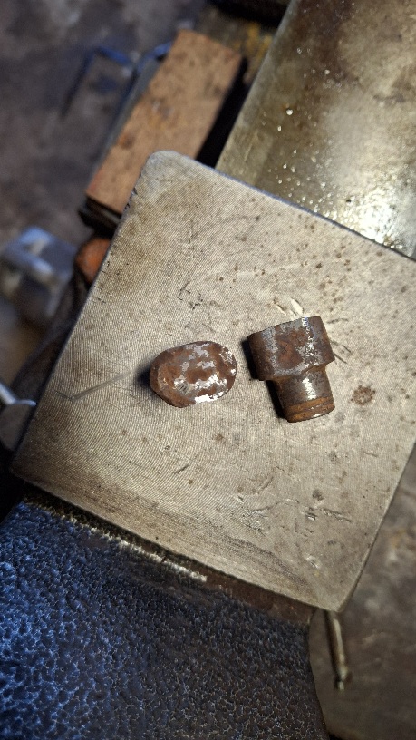

I think the only parts I'm missing are the 2 clipped head bolts for the landslides. I found some similar online but I doubt they'll work. But I think I can duplicate them if needed. The old ones had to be cut to remove them. I'll. Double check the bolts sent with the parts. He only mentioned plow bolts, so I didn't think to check the bag thoroughly.

I just got a couple from shoup. 1/2 inch by 1 and a half. Coarse thread. Did need a little seating but worked great. IH used a lot of clipped head plow bolts. Make sure you wear proper PPE before entering a case ih dealership!

Those look similar to what I got from grainger or mcmaster carr (can't remember). Those i got aren't shaped like the original...original are completely flat on the sides, no bevel on any surface.

My plow book only refers to these bolts as locking lugs. Maybe clipped head isn't quite the right terminology...but it seems to fit, just not precisely what seems to be available now.

There are 4 types of plow bolts that I as familiar with. 1,  the square head under the flat head, 2, clipped head, 2 flats and 2 radius's. 3, the Allis bolt with the single locking lug. 4, the Allis 'cat's eye'. Didn't know they even existed until last spring when I bought some shares from Kenny. Had plows with them but hadn't ever removed a share. It would be really nice if there were only 1 or possibly 2 styles. Numbers 3&4 on my list are rather difficult to source.
If any of this is incorrect somebody fix it or add to it if there are more I'm missing.

T slot? But dozens of t slot styles. Toilet bolt with a very thick head
