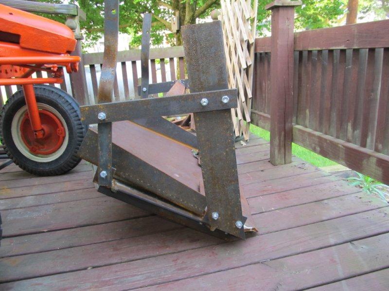

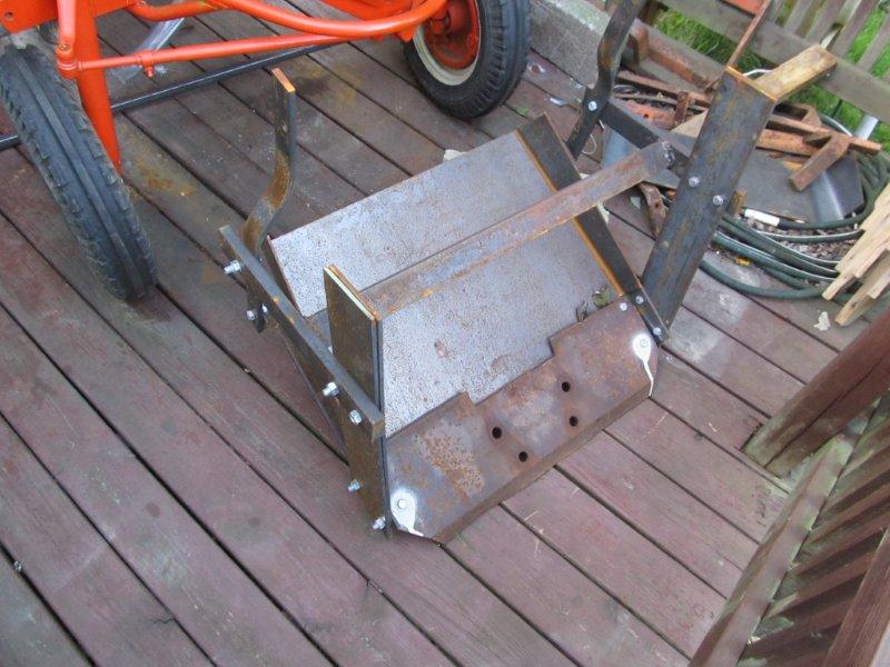

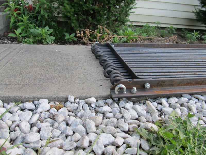

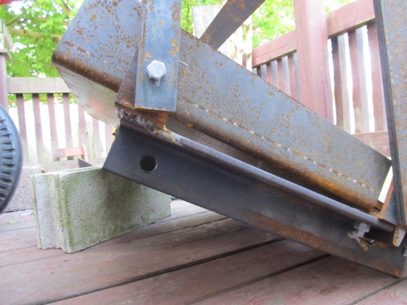

Well, I don't have any plans drawn up, everything is in my head and has gone through a couple rethinks since I started it. I do have most everything built and awaiting final assembly. The digger head needs some whittling on the sides so the front wheels can be turned, someone made it to long toward the front...
I'll see if I can throw together a rough drawing and post it here.

OK, I can't draw everything I've done so I'll post a couple actual pictures of what I have so far. Here's a rough drawing, though.
