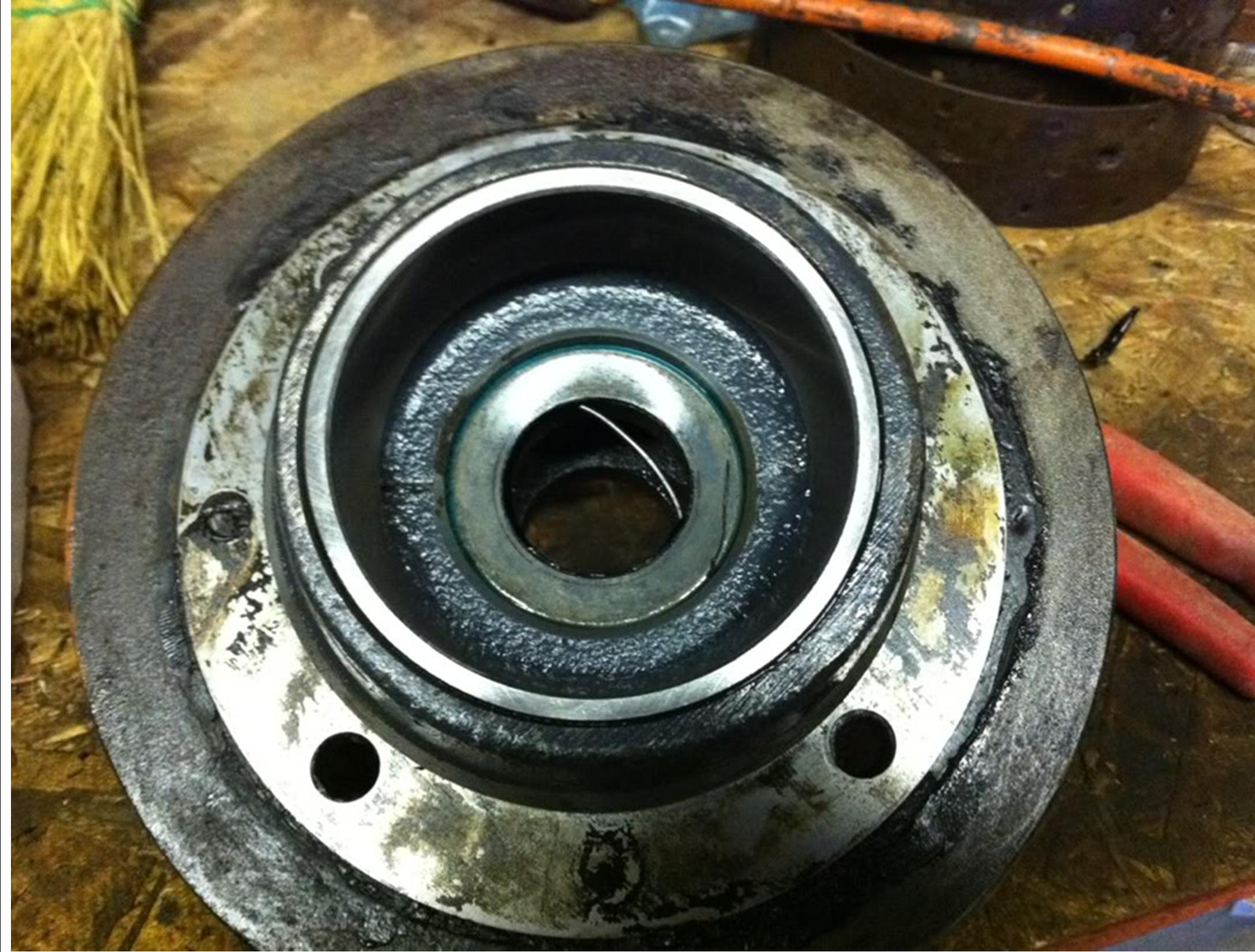

This is a picture I took off this site. I'm not the brightest, but could someone tell me if this seal is in correctly or should it be turned around?

hard to see but the lip should be toward the oil or face up in the picture.

You mean the rubber lip & spring should be up correct?
