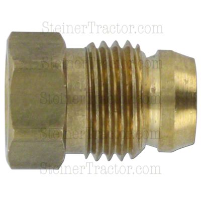

Here is a picture for the "Correct Police" of the "imperial Eastman" fittings that Allis Chalmers used on the fuel lings of their early tractors.  I know these were on most of the early letter tractors and I can't say when the style changed away from this.  The ferrule is part of the nut and at the proper torque it will break from the nut and clamp to the tube leaving a swivel.
Very interesting, I learned something today!  I always thought they were just a compression fitting, now I know they are a little different.  Now I did a brief google search, and it seems that "Imperial Eastman" is the company name, correct?  What would this type of fitting actually be called?  And where (if at all) can they be found today?  Are those the part numbers from Imperial Eastman?  Trying to learn a bit more about this for future reference, thanks.

These were also used on Farmalls and others as well.they're also called break away ferrules.Available through steiner and other places I would imagine.

Those are Allis Chalmers part numbers in the picture I posted.  I do think the "imperial Eastman" company is no longer in business. What I have in my stock may be all that is left in existence. I was looking for something similar in a different size awhile back for the Cummins in my pick up and I was only able to find a very similar fitting is now available from MSC as a high pressure fitting.

Imperial Eastman is no longer in business. Parker/Hannifin bought out Imperial. Used to use Imperial for making hydraulic hose assy's. at work for our Bucket Trucks and Digger Derricks. Like I mentioned in the earlier post, products aren't the way they used to be. I noticed these new Parker fittings corrode very easily once out in Mother Nature. Something that didn't happen before they went over seas.   Bummer!
