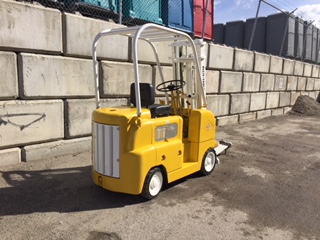

So, I just bought one. Runs and drives but needs a water pump and the brakes don't work. Are parts available through Agco still or does anyone have a good place for parts for these things?
My serial number is 8246114, can anyone tell me what year it is?
Engine plate says it is a Buda 4B 153, and while googling looking for a water pump I came up with a lot of results for Coop E3 and Cockshutt 30,40 and 50 tractors, I'm assuming they also used the same engine, are all parts interchangeable? Engine is painted orange and the guy I bought it off says they used the engines in some Allis tractors aswell, if so, which tractors?
Ended up I paid $1500 for it delivered to me, supposed to be here Tuesday. I think I did alright.

Ended up I got a water pump Monday, local tractor wrecker has a rebuilt pump in stock, forklift showed up today. Got the new pump on, found the alternator bracket was broke and the mounting tab on the alternator has the hole worn out so got to get a new front cover for the alternator. Get that fixed tomorrow and I can put the rad back in and be in buisiness.
Steering is real loose, it's one of those wierd ball and socket deals with the cups and spring where most of the play is, imagine that's easily fixed. Brakes also don't work but the master cylinder was empty, filled it up and they kind of pumped up, imagine it shouldn't be hard to fix and or bleed.

Eric, got it all back together today after the surveyor left, runs like a champ now that I can run it without worry of overheating it. Then proceeded to run out of gas before I drove it out of the shop. Then ran the battery out of juice trying to get it cranked up again. So hopfully the good used battery I had as a spare is still good, it's on the charger now. Also got to rebuild the starter I guess, gotta hit it with a hammer every other time I go to start it.
Jay, this winter I'm going to have to pull the hyd pump too, crank pulley is worn right out. Adjustment is no problem, both the water pump and the alternater is adjustable the way mines set up.
Now with these split wheels, do I need to let all the air out before I take the wheels off so the wheels don't blow apart or how does that work? I also had no idea they were that heavy or are yours solid rubber tires? Mine are 7.50-12 on the front, air tires, no solid

Nice find Dave, you have any pictures of it?
