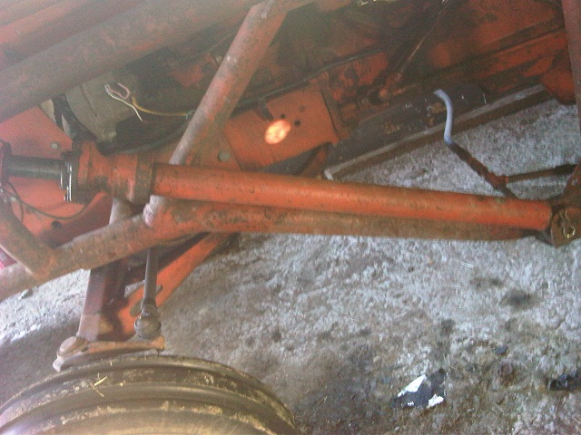

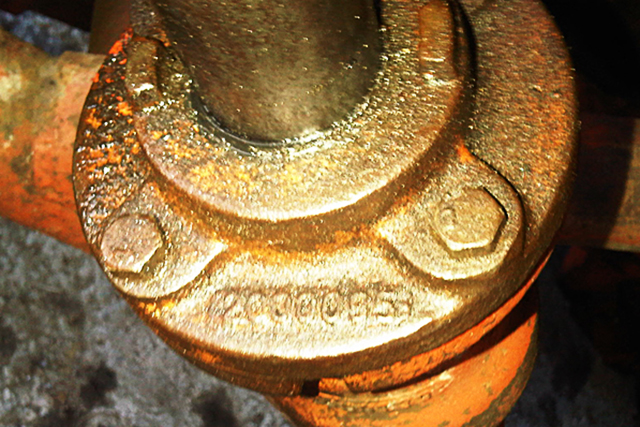

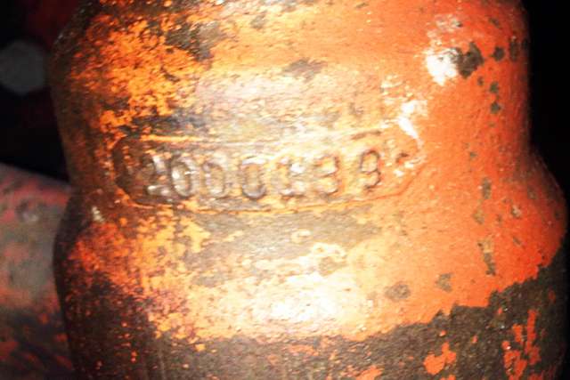

Well after 53 years my seals have completely gone in my cylinders. Anyone know where I can find new seals? Here are some pictures that show the numbers. Also anyone know the procedure to replace them?

Some AGCO dealers may have them.  I got mine from Tony Carbaugh on this site.  They don't cost much, but make sure your rams are not too pitted or corroded or they will just chew up the new seals.

You should be able to go to a hydraulics place with the cylinder or some of its parts and they will determine your needs.

Most hydraulic seals are fairly standardized... What I do, is remove the retainers, pull the seals out 'carefully'... clean up the rod, cylinder, seal and retaining hardware, and carry it into my local hydraulic supply house, and they order in the appropriate seal type, material, and size for the application.  Oftentimes there's more than one component to the seal, and frequently, the new seal type is actually made of more modern, and actually better... materials, and built using newer processes, for even better service.

Use the genuine ac seals, the v packing rings are AC part #72000650 (packing)  it will make the job so easy, follow the link that was loaded by Charlie and you will fully understand how to fix your cylinders it has 80+ pictures. Pay attention to the pages on bleeding the seals and makes sure you put oil on those seals lips. Call me if you have any questions at 708-275-6820.  Coke-in-MN is not correct on the cylinder, it does not have a nut on the bottom of the cylinder.
