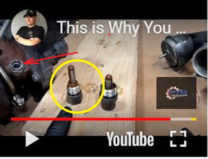

The filter is inside block on supply line connection. it's just a screen.  They are like $15.00 or you can clean yours.
Points: 90994
Post Options Post Options   Thanks (0) Thanks(0)   Quote steve(ill) Quote  Post ReplyReply Direct Link To This Post Posted: 21 Mar 2024 at 8:21am
what does it filter ?? What is the result of not changing the screen ??
apparently there is an inlet SCREEN on the oil line to the turbo.. It takes out BIG contamination that is in the oil... If you NEVER change the oil, or if you have an internal engine problem that puts out slivers / junk ... then the screen is suppose to catch that so you dont fail the turbos also......... "NORMALLY" the screens are never changed... unless you are replacing the turbos..

Well thanks for the info on the screen, but just where is it?  Do I need to be concerned about it? Ouch

there is a 3/8 inch steel line that feed oil to the turbo... There is a INLINE screen that screws into the turbo, and the LINE screws into that screen holder.. Arrow points to the oil supply hole.. Circle is the filter that screws into it..
reading online it seems like all the "EXPERTS" recommend 5000 mile oil changes to KEEP THE OIL CLEAN... If you go excessive, you build up crap and carbon... That has detrimental effects on the engine / chain tensioners / and any think that COULD plug the screens.... It appears that you dont do ROUTINE MAINT to the screen.. You change it out when you install new turbos / rebuild the eng/ etc.
