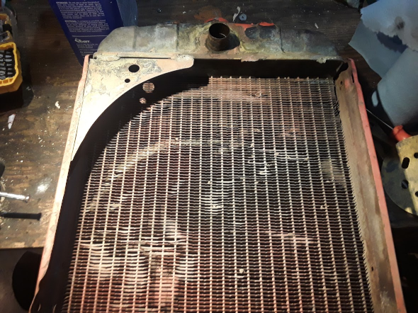

Post Options Post Options   Thanks (0) Thanks(0)   Quote Jay Tee Quote  Post ReplyReply Direct Link To This Post Posted: Yesterday at 10:24am
Dropped the governor housing off with a friend who has an amazing machine shop in his basement. He recoiled when I said I would just glue the pivot post in with JB weld.  In the meantime, the radiator needs help.

Post Options Post Options   Thanks (0) Thanks(0)   Quote Jay Tee Quote  Post ReplyReply Direct Link To This Post Posted: Yesterday at 10:25am
Points: 5012
Post Options Post Options   Thanks (0) Thanks(0)   Quote PaulB Quote  Post ReplyReply Direct Link To This Post Posted: Yesterday at 7:37pm
I have an early non pressurized B radiator that may be fine as is, or at least need less work than yours.
