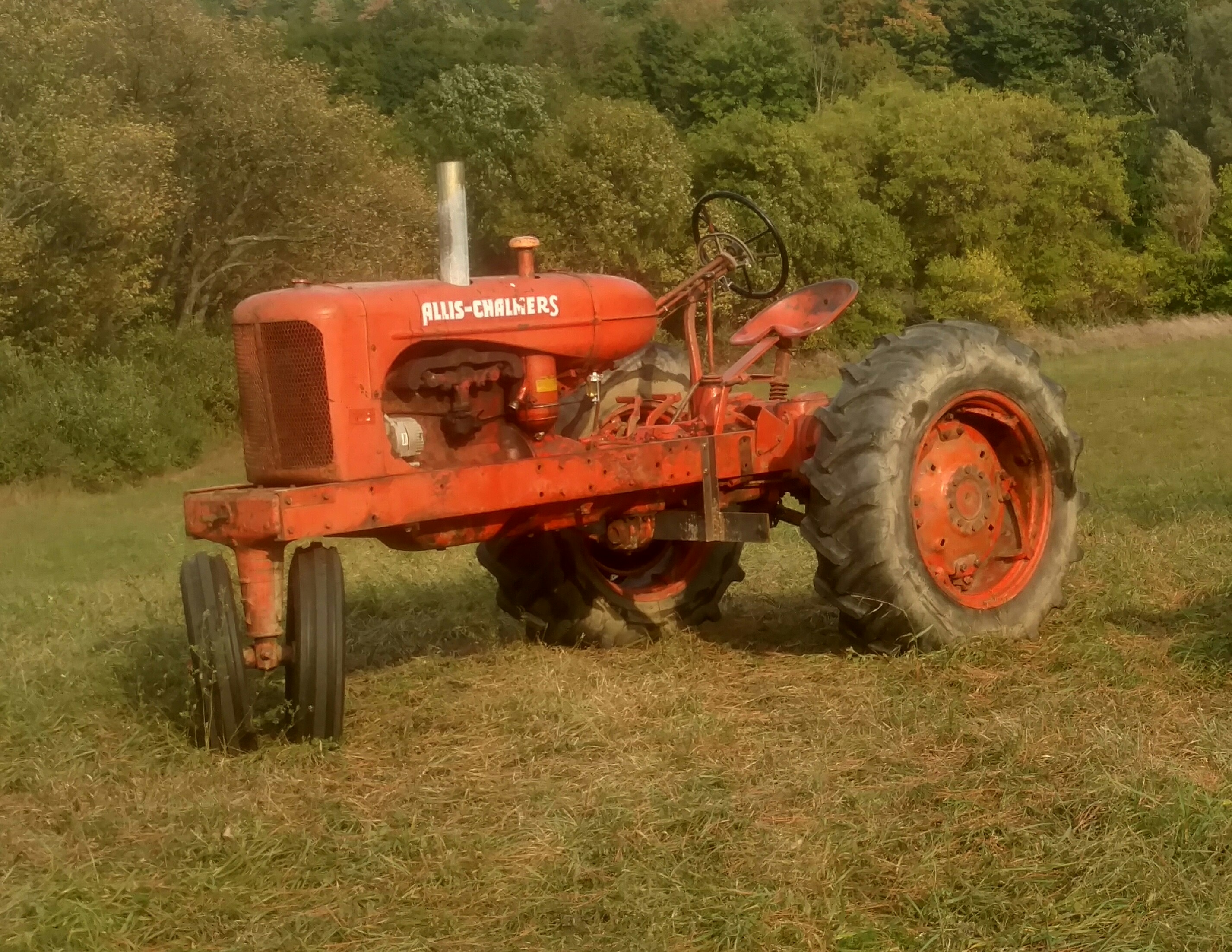

So here is what I started with. Basically bone stock 48 WD

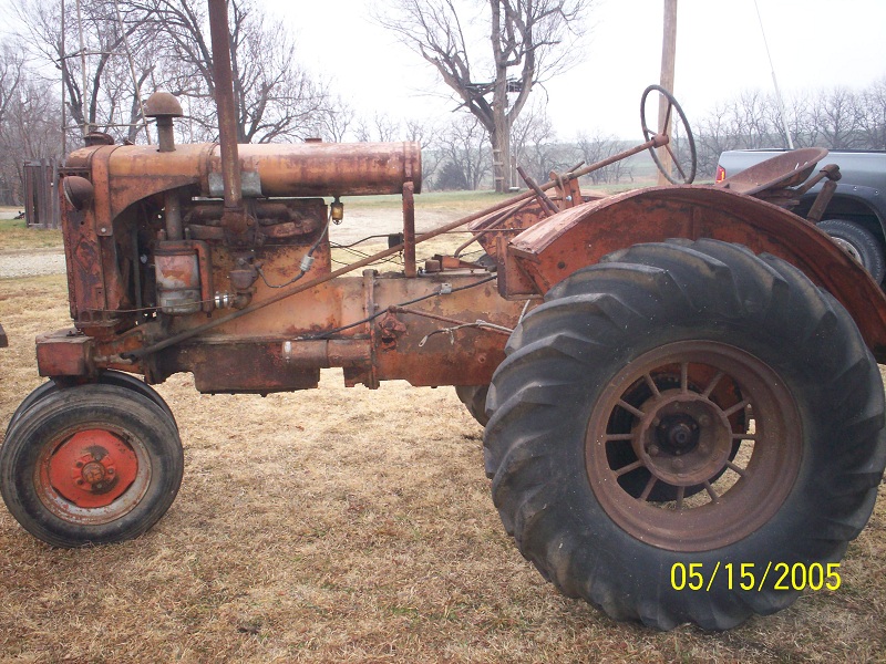

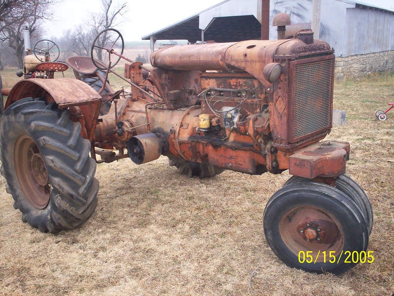

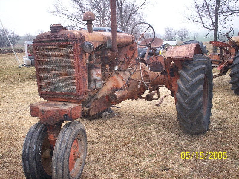

I just setup an account at www.postimg.org after seeing it usedt in construction equipment forum to give it a try.  Looks a little more user friendly than vgy for same application.
here is where my pulling project started.  date was not 2005 more like 2014 or 15  From forum file manager
