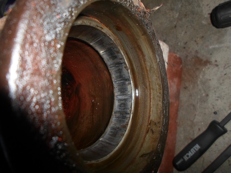

Went at the stuck bearing today with an angle grinder, 2 foot pipe wrench, and a 2 foot long chisel (tight quarters in there). Finally got the thing popped free after cutting the cage. I can definitely see why it was stuck...
Somebody definitely punched the spindle to get some extra bearing bite, to the point it almost seemed like it must have been a press fit or something (either that or the bearing egged out, too damaged in removal to tell the whole story probably).

Dang, someone went crazy dimpling that. I'd probably knock that down a little and use some of the green press fit bearing Loctite, but I don't have the decades of experience with these tractors that some of the other guys on here do so I'd defer to them.

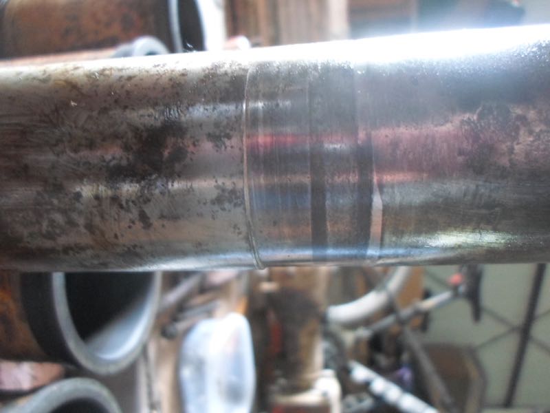

Almost forgot - my vertical shaft was also worn where the bearing rode on it (more evidence that the bearing was locked up). I welded this back up and used a flapper disk in an angle grinder to smooth it out to about the original diameter of the shaft. Ideally you'd have a lathe but I figured for very low speed as long as you have a good fit between the shaft and bearing it will probably last forever. Couldn't be any worse than putting it back together without building up the groove at all.
Again, hopefully yours isn't this bad... But even if it is, it can be fixed.

I'd try to measure that spindle to see if it's way undersize or what. Cone should just slip on without being tight...just like any spindle brg. If way off just replace whole thing. Lonn MN probably has a good one worth the money. If it's not off by much peen the cut marks down and maybe a little filing to get the new cone to slide on. Can't tell in pic if bottom side is worn off from stuck/spinning inner race. It's not meant to be a press fit.
Dad replaced a lot of those vertical shafts. They get worn at brg and bottom keyway would be worn making sideways play. His brother-in-law was a machinest at Blaw Knox and made them on the side.

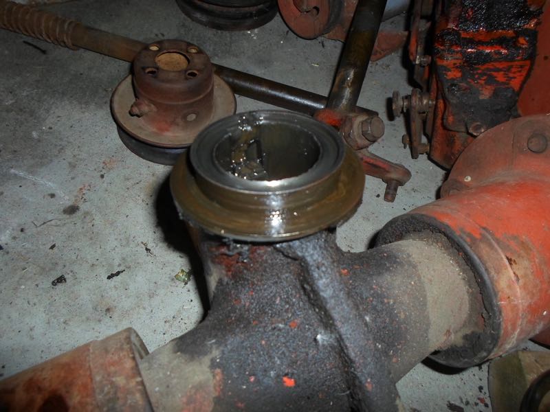

Okay so I ordered a new bearing cone, race, washer shims, and the seal kit (212916 has both the cork seals and the bearing retainers, and now that mine is apart, I can tell mine have been beat to death).
Here's what I found when I got the bottom taken apart (do notice that the bearing didn't just drop out... assume I need to remove the crank somehow to pull that gear and shaft out the top if it's kind of been eating on it). Can't really tell where the "wear" is, but assume it's the key on the lower assembly that got worn loose since the main shaft itself seems good?
So yeah... Guess I just need to figure out how to get that dang bearing out, and pull the shaft to see if the bearing has been spinning on it like wjohn had.

I remember dad working on these. The cup would be indented where rollers rode so it didnt turn . It would then wear face where cone rode as well as shaft. Eventually the wear forced the upper gear against the crank causing hard steering. The bottom bolt and key way set screw were usually loose and the key and keyway got wollowed. I don't remember how he addressed the spindle casting. I remember him using shim washers to space things back to "spec" and replacing shaft and brg. To remove shaft drive out roll pin at pulley end,remove cotter pin at spring. I remove the bolt in the bracket also to get the shaft end closer to the casting to drive out that roll pin. Pull shaft fwd and clamp vise grip on it .

Sorry for the delay - I did look and it doesn't look like I took pictures of the bearing numbers of the new bearings from AGCO, unfortunately. Sounds like you are progressing well regardless.

Well I needed to get my tractor back together to work in the garden next weekend, so I kind of abandoned getting the shaft out of the top for the time being (I got an air hammer to try and drive the pin out of the crank as that has been fighting me the whole way, but saving that for another day -- maybe this winter).
But while I had the bottom end apart... I've got a new bottom seal and washer going in (the old seal was completely gone and the original washer was beaten into a cone -- was able to cross reference the thrust washer to Torrington TRB-4052).
New hubs (old hubs had spun the races), all new bearings greased up and put on.
Just need to get the wheels back on now. Everything seems to be fitting together well.
