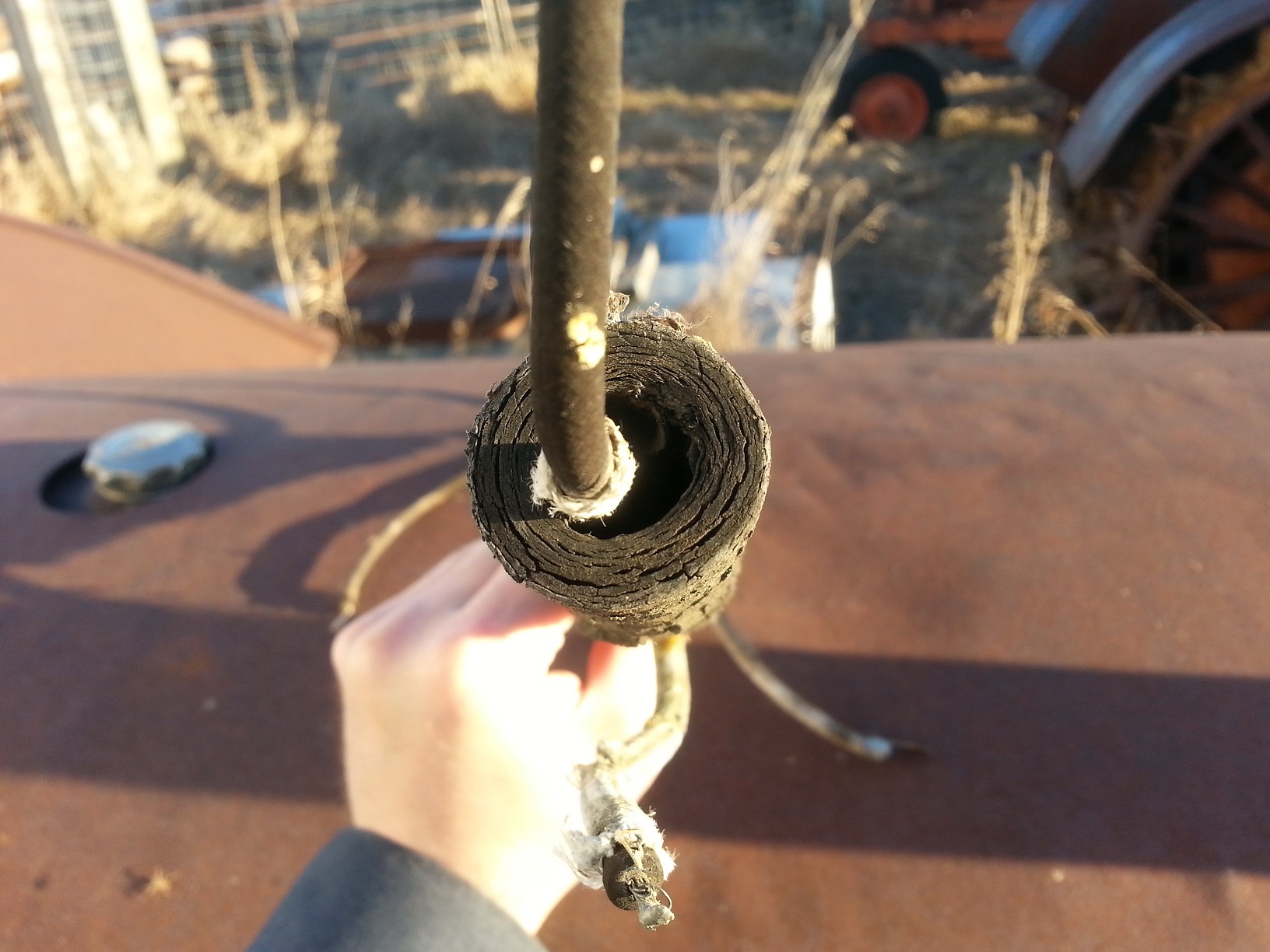

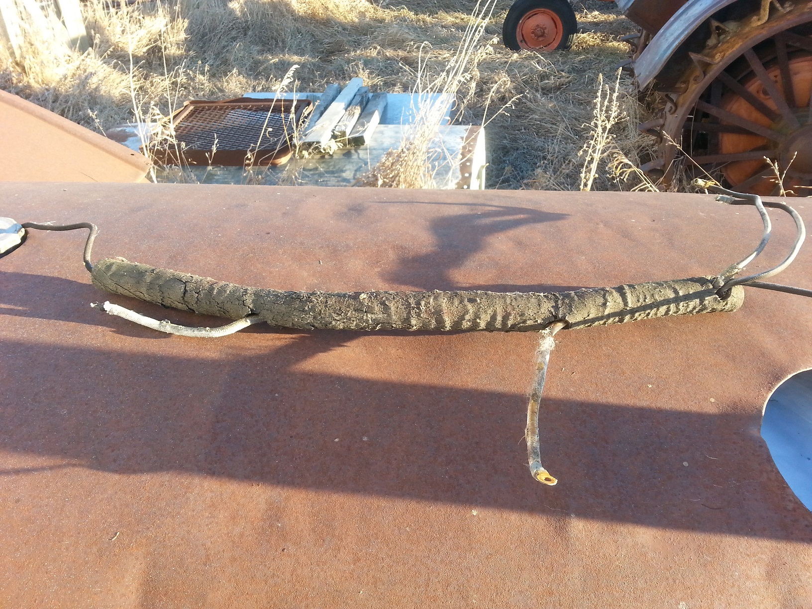

Post Options Post Options   Thanks (0) Thanks(0)   Quote Brendan (AB) Quote  Post ReplyReply Direct Link To This Post Posted: 08 Apr 2019 at 10:42pm
Below are a couple of pictures of the tube that I have. Unfortunately, it is in poor shape, but maybe someone can identify the material.
Edited by Brendan (AB) - 08 Apr 2019 at 10:50pm

Hope I'm wrong but thinking it was rolled with "Asbestos" made from "Amosite" is also known as brown asbestos. It was commonly used for insulation in electrical, thermal, chemical and plumbing purposes, such as pipe lagging and insulation boards.

So a little update with this part of the project.  I was home for the long Easter weekend and got some tractor time in.  Took these pics of my original fiber spark plug tube.
Links to pics:
It appears to be the same stuff that Brendan's is?  Still don't know for sure what it is.  Mine appears to be in a little better shape.
So I ended up ordering the
8640K181 Easy-to-Machine Garolite LE Tube, 40" Long, 1" OD, 3/4" ID
From McMaster Carr.  Seems to be the same kind of stuff, and I'm happy with how it looks.  I'll post pics of the finished product once we are done.
The 20-35 parts manual says that it is 2'-1" long.  My original is like 23 3/4" long, so pretty close.  We'll make it to the parts manual specs.
Not 100% sure what configuration of holes it should have?  We are guessing the 4 holes (which are 5/8" in my original tube) that are on the bottom (so water drains out?) are original? The hole in the side towards the rear appears to be added later, it's not as clean cut of hole.  Logic says that if there were 4 holes from factory, it could have been installed either way (idiot proof).  Thoughts?
