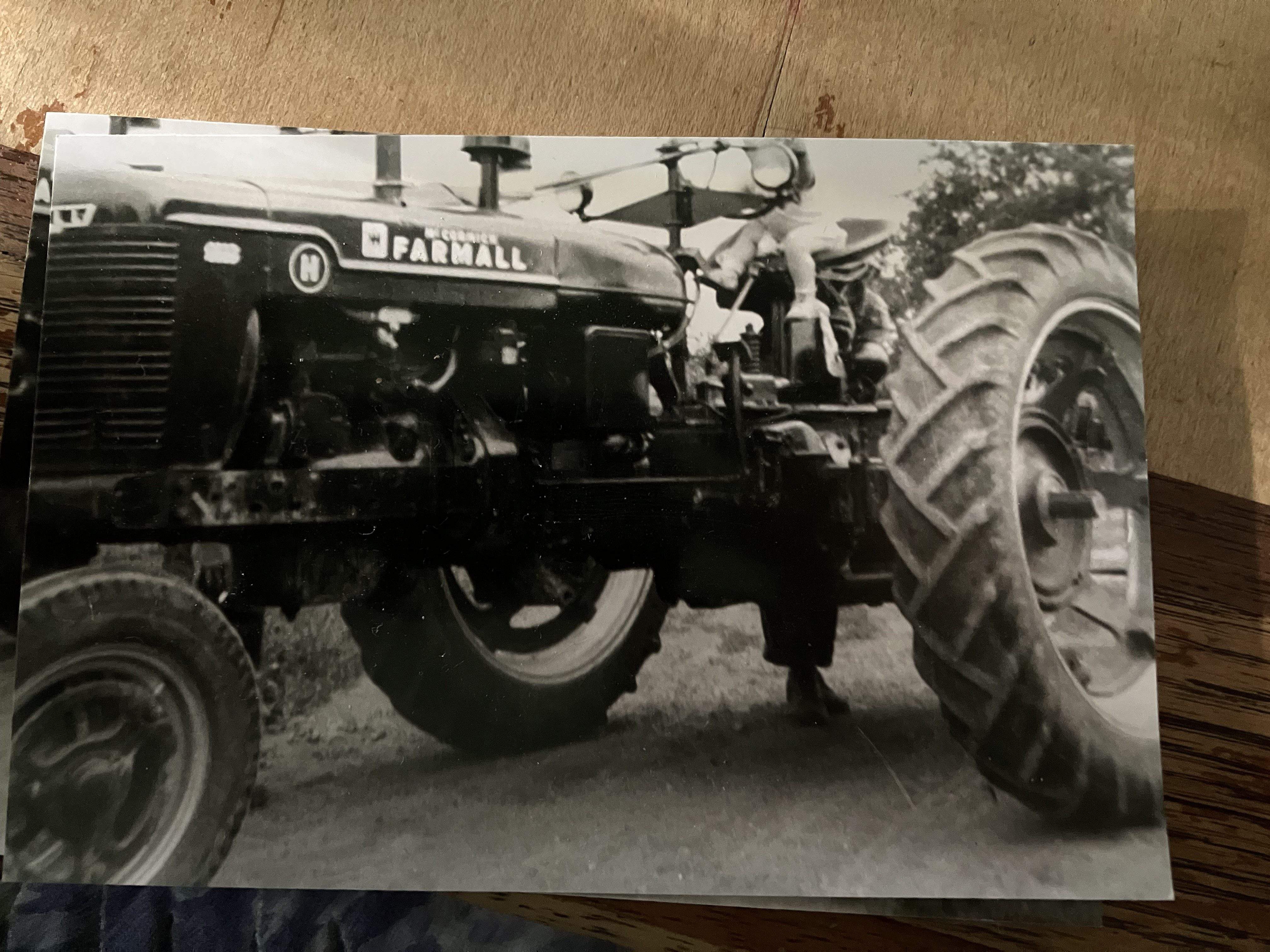

Not the best pics, copy of a copy of a copy. I believe this was taken in 1952, the tractor was I think a 1949. The short-legged dude is me, with my father standing over me. In the other pic standing behind the tractor and seat guarding me from falling out of the seat, just barely visible, is the owner of the tractor and the farm I grew up on.

It's good that the photos have survived; that has been a long time ago.
