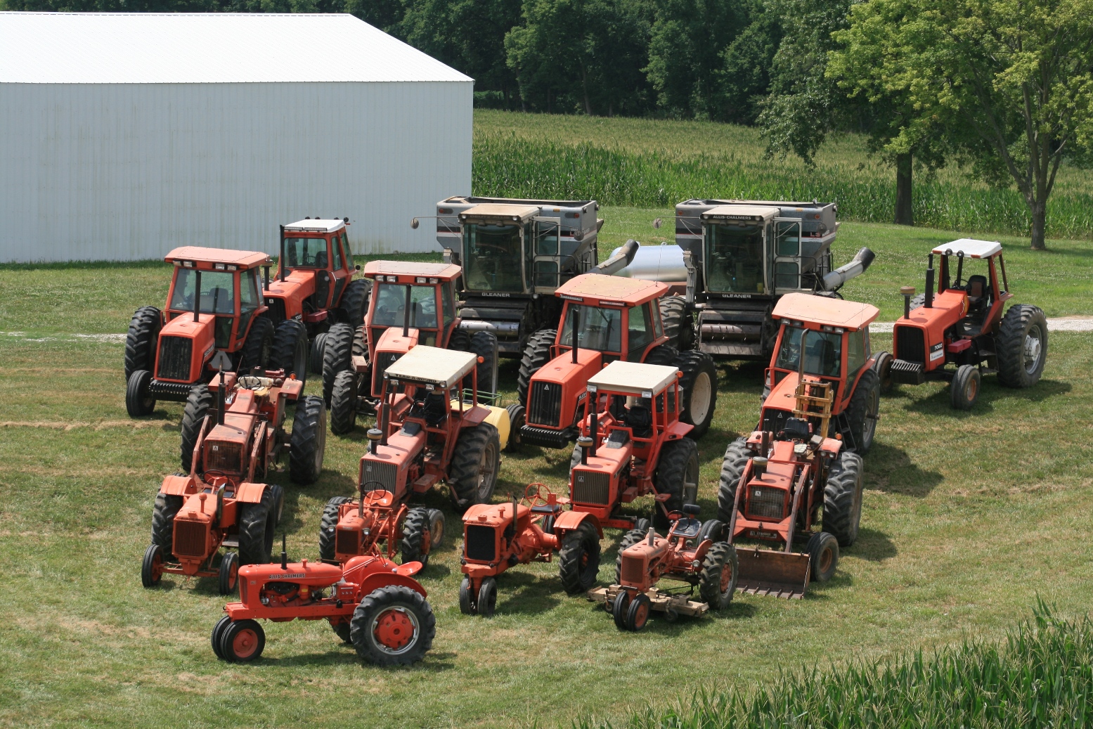

 I have a 200 with Year a Round and a 200 with a Hiniker cab. Both have windows removed and used strictly as canopies. I do like the YearRound better. More simple design, much easier access to batteries. When it gets cold, they pretty much get parked.

Leon, that picture is worthy of framing.

Bigal, that picture is framed. It was a surprise Christmas present to my dad in 2020, every AC we owned. He passed 12-31-22.

that is one excellant photo
