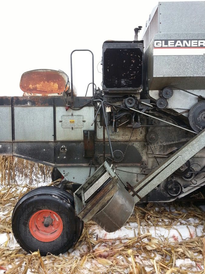

Got the combine to start shelling corn well.  Thank you to all who helped with my last post.  I still have a few bugs in the system, but overall I am pleased.  I finished a field today, and have been doing paperwork tonight for yield reporting.  I looked in the Manual for the F2, and it shows a capacity of 120bu with extensions.  I was curious if mine has extensions, or if it is standard capacity.  Looking online, I see pics with different toppers above what I have.  Mine has two fold up flaps on the front and rear of the upper box, that are held with large rods across the bin.  Some pics have larger boxes going up where I have the flaps.
This picture is from a while ago.
Thanks for helping.

John I believe the extension is the box setting on top of actual bin.Most have it but looks like std equipment was just the bin with something like a 16in shorter elevator.

Here's a picture of my father's F3 that has the extensions. Looks like yours.

Thats the look.  So 120Bu is the magic number then
