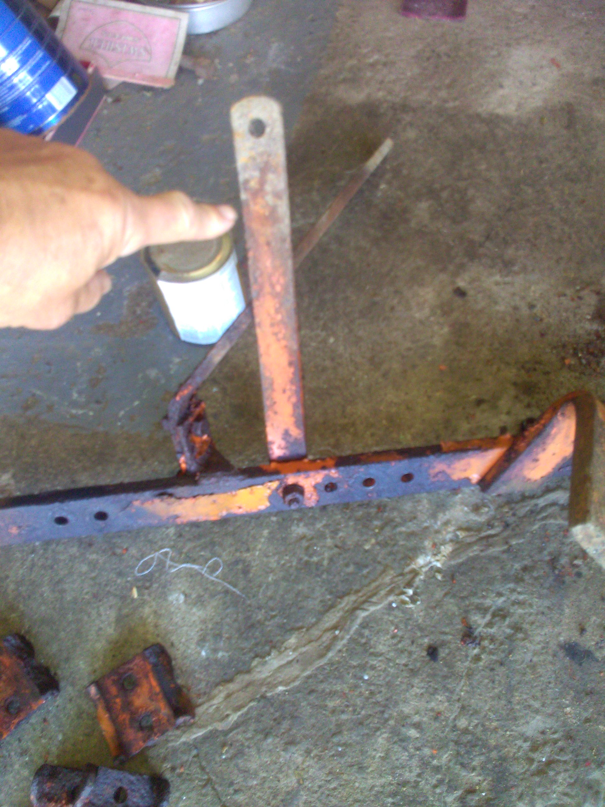

i got these cultivators last fall and never looked at them till now when I am taking apart.
the Owners manual doesnt show this brace???  there is one on each side in the same position

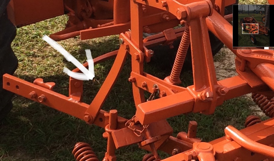

Post Options Post Options   Thanks (0) Thanks(0)   Quote JoeM(GA) Quote  Post ReplyReply Direct Link To This Post Posted: 06 Jun 2024 at 2:48pm
I'm not near my books but that brace on each side will keep you from breaking the mount if you hit something hard with the feet, very, very desirable part that’s often missing. It provides a lot of support to the lift/plow connection

Post Options Post Options   Thanks (0) Thanks(0)   Quote JoeM(GA) Quote  Post ReplyReply Direct Link To This Post Posted: 06 Jun 2024 at 3:18pm

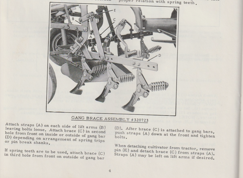

here’s the best I can do for ya at the moment

Post Options Post Options   Thanks (0) Thanks(0)   Quote JoeM(GA) Quote  Post ReplyReply Direct Link To This Post Posted: 06 Jun 2024 at 11:12pm

JCSinPITTS,PA View Drop Down
Points: 240
Post Options Post Options   Thanks (0) Thanks(0)   Quote JCSinPITTS,PA Quote  Post ReplyReply Direct Link To This Post Posted: 07 Jun 2024 at 7:25am
THANK YOU JOE!!!  you went ABOVE & BEYOND on this ....  my manual is FORM TM-27. I will save this pic for future
