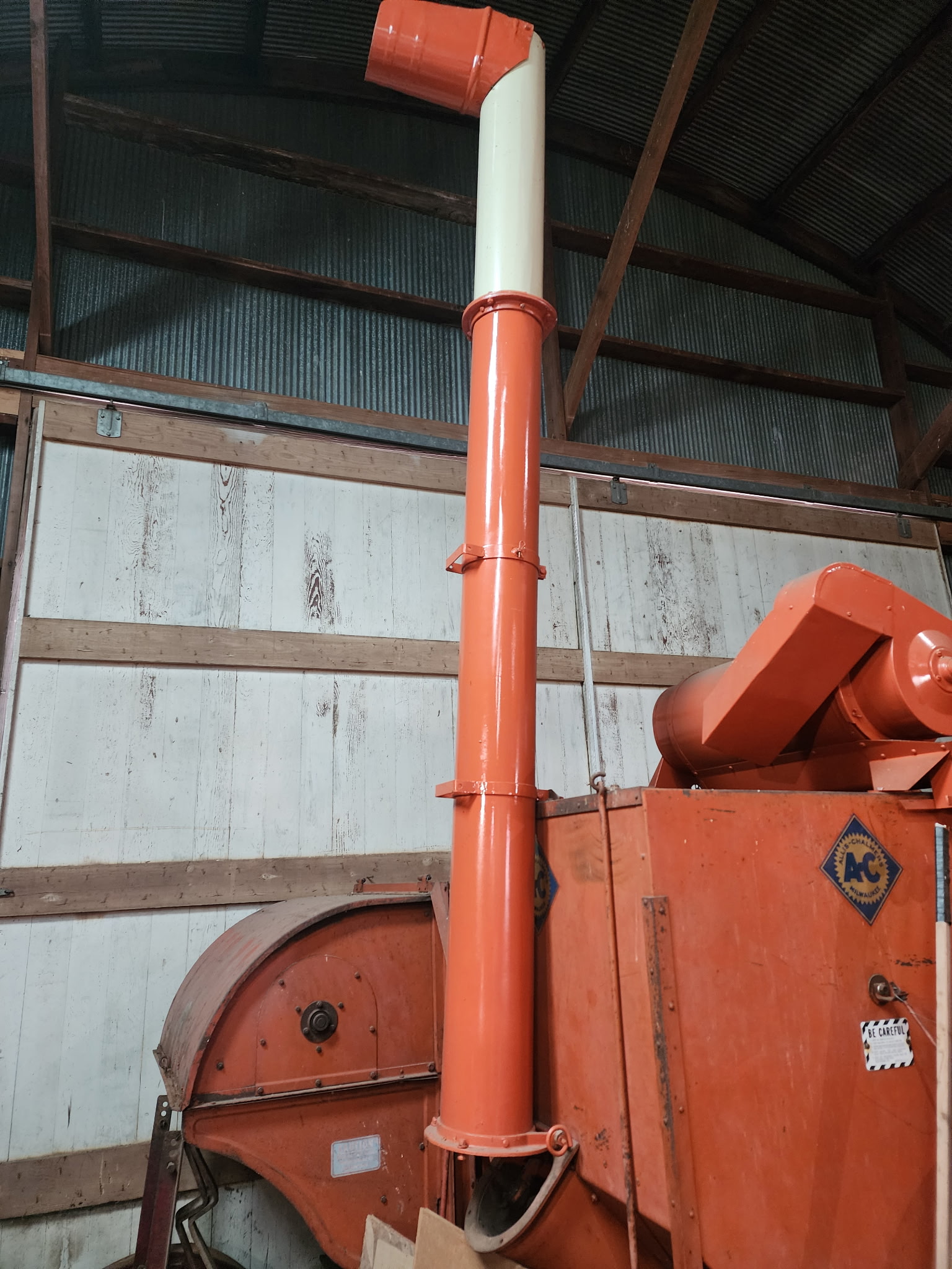

My brother made a 3 foot extension for one of our AllCrop augers. It looks amazingly good!!! I would love to post pictures of it for your interest if it wasn't so difficult to do so. Ryan

I have a factory extension I put on a 60A back in 2015. It's been 10 years now, so I might not remember everything perfectly, but this is how I recall installing it. It came with a stub shaft several inches long that fit inside the existing combine auger shaft. You had to drill a hole in the auger shaft in order to drive a roll pin through the auger shaft and stub shaft. After that, you slide the extension shaft with flighting over the stub shaft, and there is a set screw on the extension shaft that you tighten to secure the extension auger shaft to the stub shaft. To extend the tube, it came with a section that had the lower 5" or so of the crimped seam cut out. That allowed the tube to flare out the necessary amount and slide over the existing tube. Then just put the bushing on the end of the extension tube, attach the spout, and it's done. My explanation might not be the best, but it was fairly straightforward.

Post Options Post Options   Thanks (0) Thanks(0)   Quote Pat the Plumber CIL Quote  Post ReplyReply Direct Link To This Post Posted: 09 Apr 2025 at 6:28pm
Posting pic for Ryan Renko

That is an amazing looking extension from the Renkos. Lots of good ideas in this thread.
Creston, that description was helpful too. Interestingly enough, there is already a cross-drilled hole near the end of my existing auger shaft - but mine isn't even a 60A, just a 60. Maybe the auger in mine got replaced at one point later on, and by then AC had started putting that hole for the extension there?
