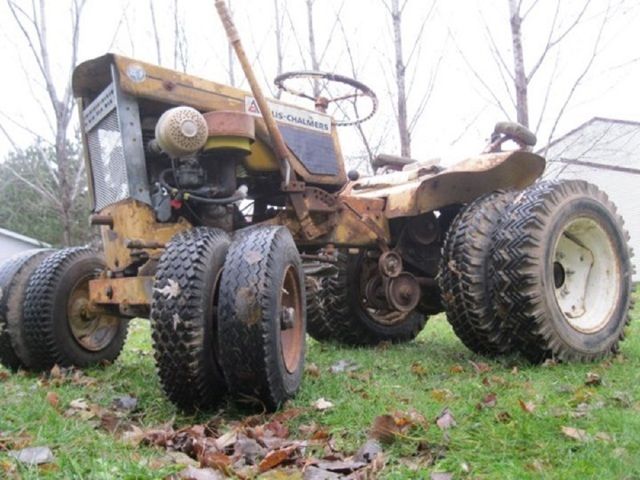

We may as well turn this into  "Duals for Dummies"  (me). I don't know what normal is because I've never put duals on a full size tractor.
Now garden tractors on the other hand....
wiplowboy should recognize this one....

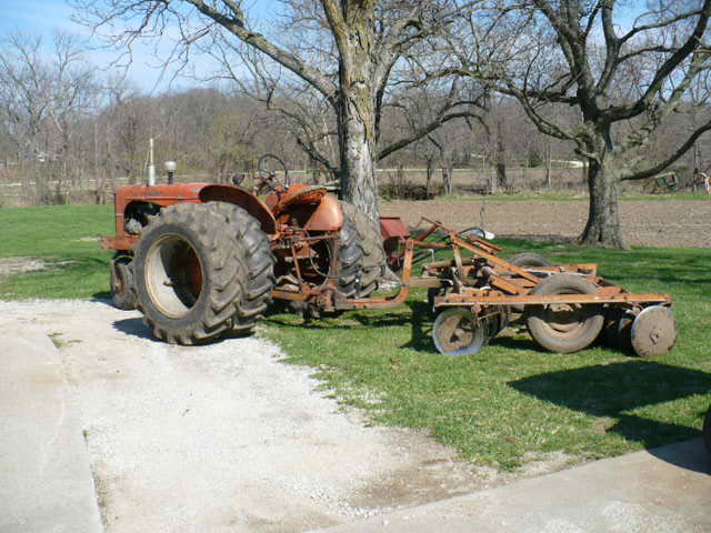

My wd45 uses clamps on the rails that are bolted on.
                  wd45and10footdisc003_zps5c5fc841.JPGwd45and10footdisc003_zps5c5fc841_2017-05-16_23-04-55.JPG
