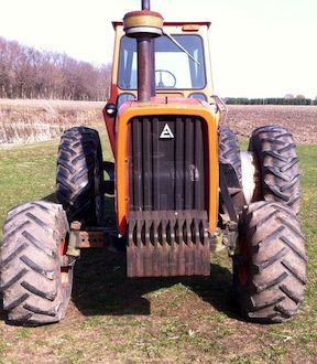

I'd like to add that these gleaner tires are R3 (lug type), not the diamond tread. I run them in reverse direction for better tread wear. They grip, turn excellent, but mostly they float best across softer soils. I found my original picture of them still mounted on the gleaner's rear axle.
s
Here's a picture of them mounted on my 7060

I'd like to add that these gleaner tires are R3 (lug type), not the diamond tread. I run them in reverse direction for better tread wear. They grip, turn excellent, but mostly they float best across softer soils. I dug around & found my original picture of them still mounted on the gleaner's standard (not HydroRearWheelAssist) rear axle.
s

7060,looks like they might smooth out some rough ground
Yes. No comparison to the originals. Tractor in photo had right wheels adjusted outward to run inside plow furrow. It pulls an AC 2000 6-18 monobeam plow & the 18.4 causes no issues in the furrow.
