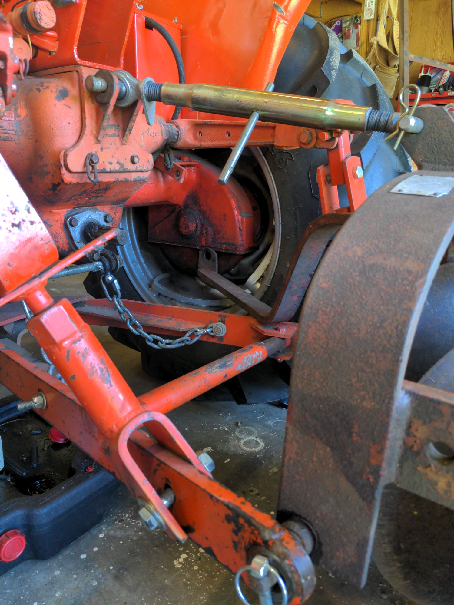

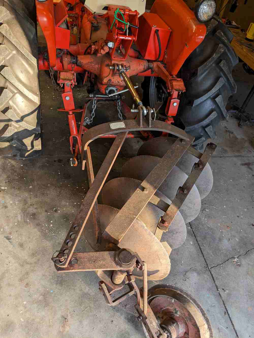

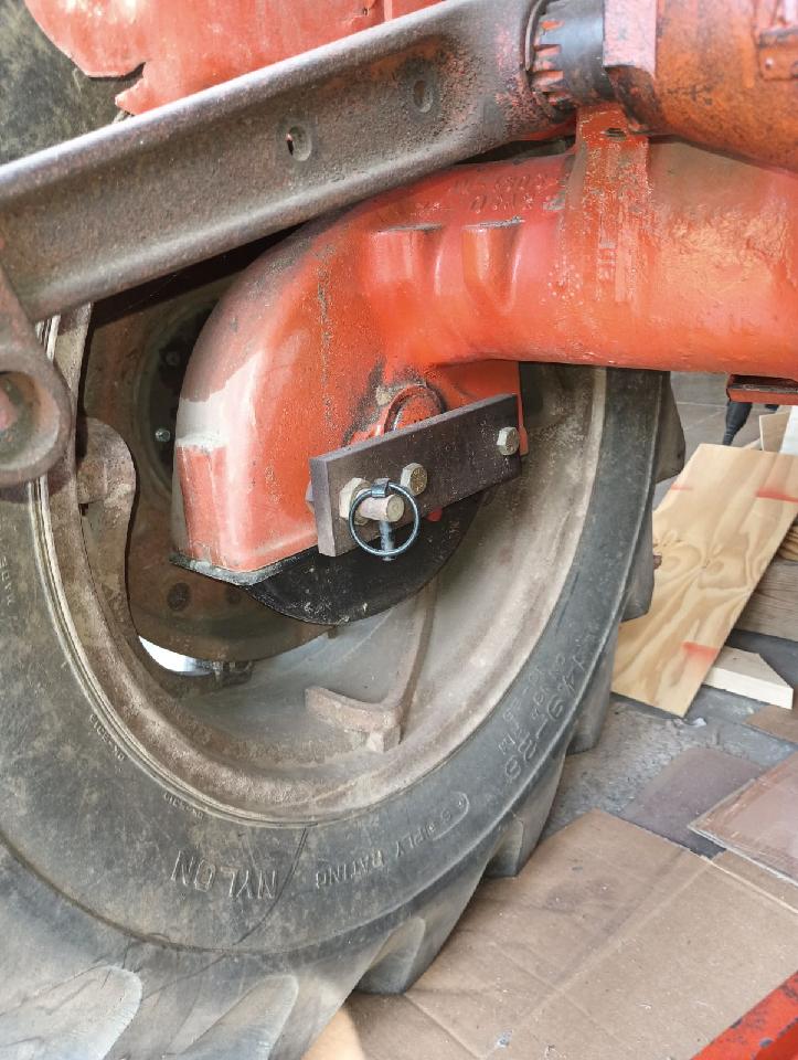

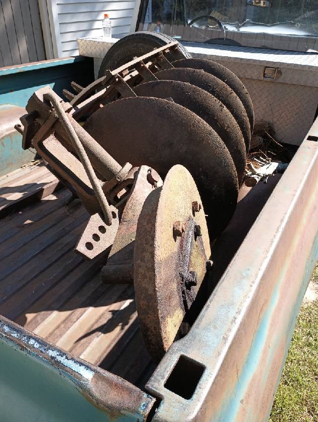

Post Options Post Options   Thanks (0) Thanks(0)   Quote ACinSC Quote  Post ReplyReply Direct Link To This Post Posted: 02 Oct 2023 at 6:40pm
There it is
Top pic is how draft bar goes on the implement
Middle pic is of the left side bracket I took off and last picture is where that bracket goes. Thanks

jvin248 View Drop Down
Joined: 17 Jan 2022
Location: Detroit
Points: 499
Post Options Post Options   Thanks (0) Thanks(0)   Quote jvin248 Quote  Post ReplyReply Direct Link To This Post Posted: 02 Oct 2023 at 9:02am
Ford and Ferguson tractors often have nearly a default axle bracket, I see how your bar is backwards to fit.
Add a follow up picture, for any future folks finding this thread.

Post Options Post Options   Thanks (0) Thanks(0)   Quote ACinSC Quote  Post ReplyReply Direct Link To This Post Posted: 30 Sep 2023 at 6:14am
Think favorite son figured it out
Like Joe said we had it backwards. Big thing is we were missing a bracket. Will post pictures if anyone is interested. Thanks

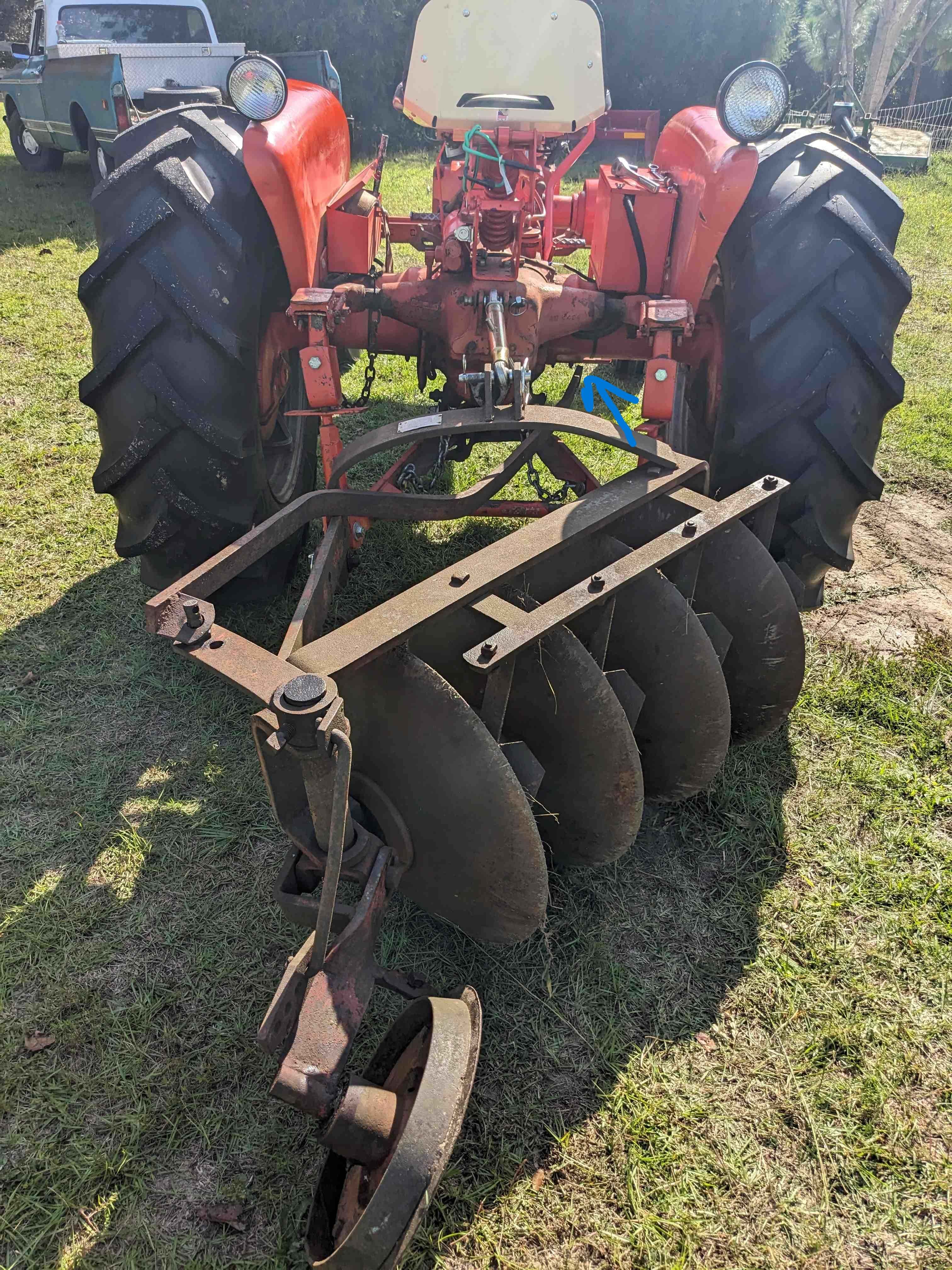

Post Options Post Options   Thanks (0) Thanks(0)   Quote ACinSC Quote  Post ReplyReply Direct Link To This Post Posted: 29 Sep 2023 at 12:24pm

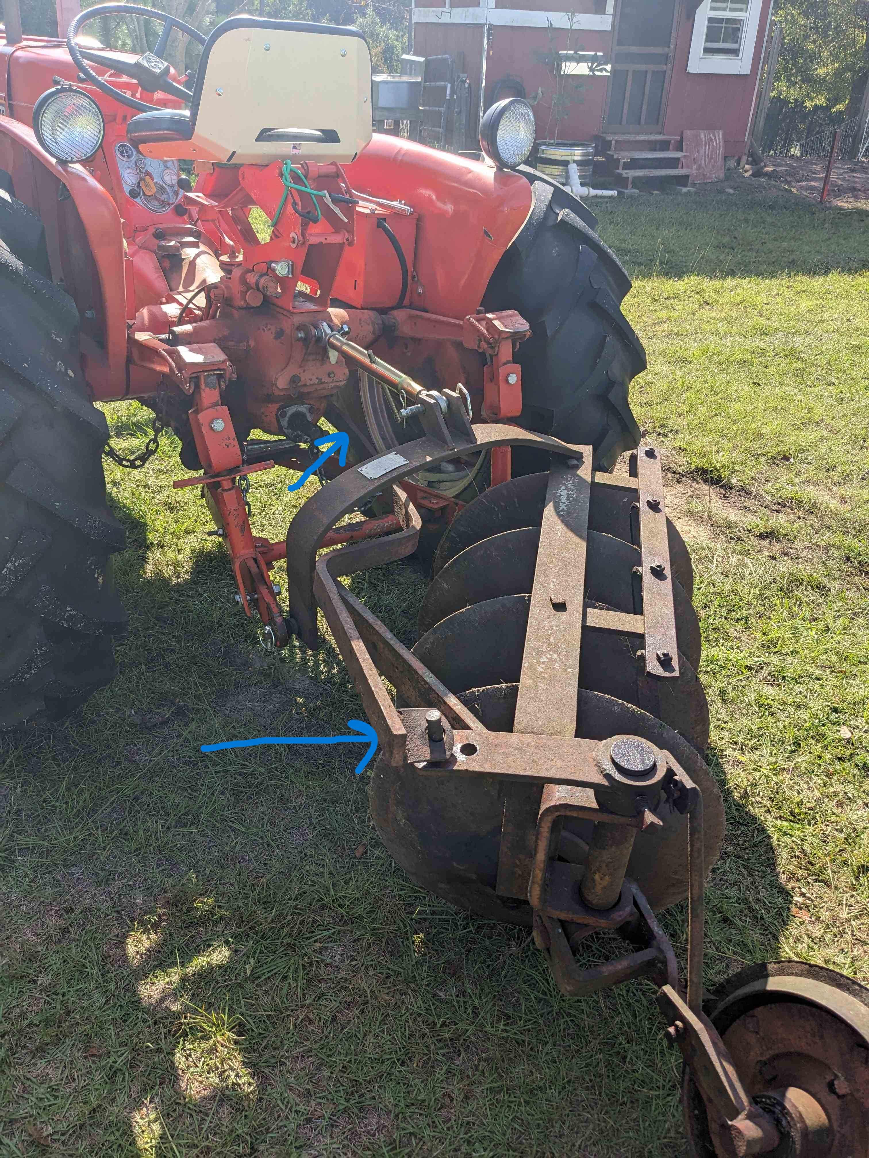

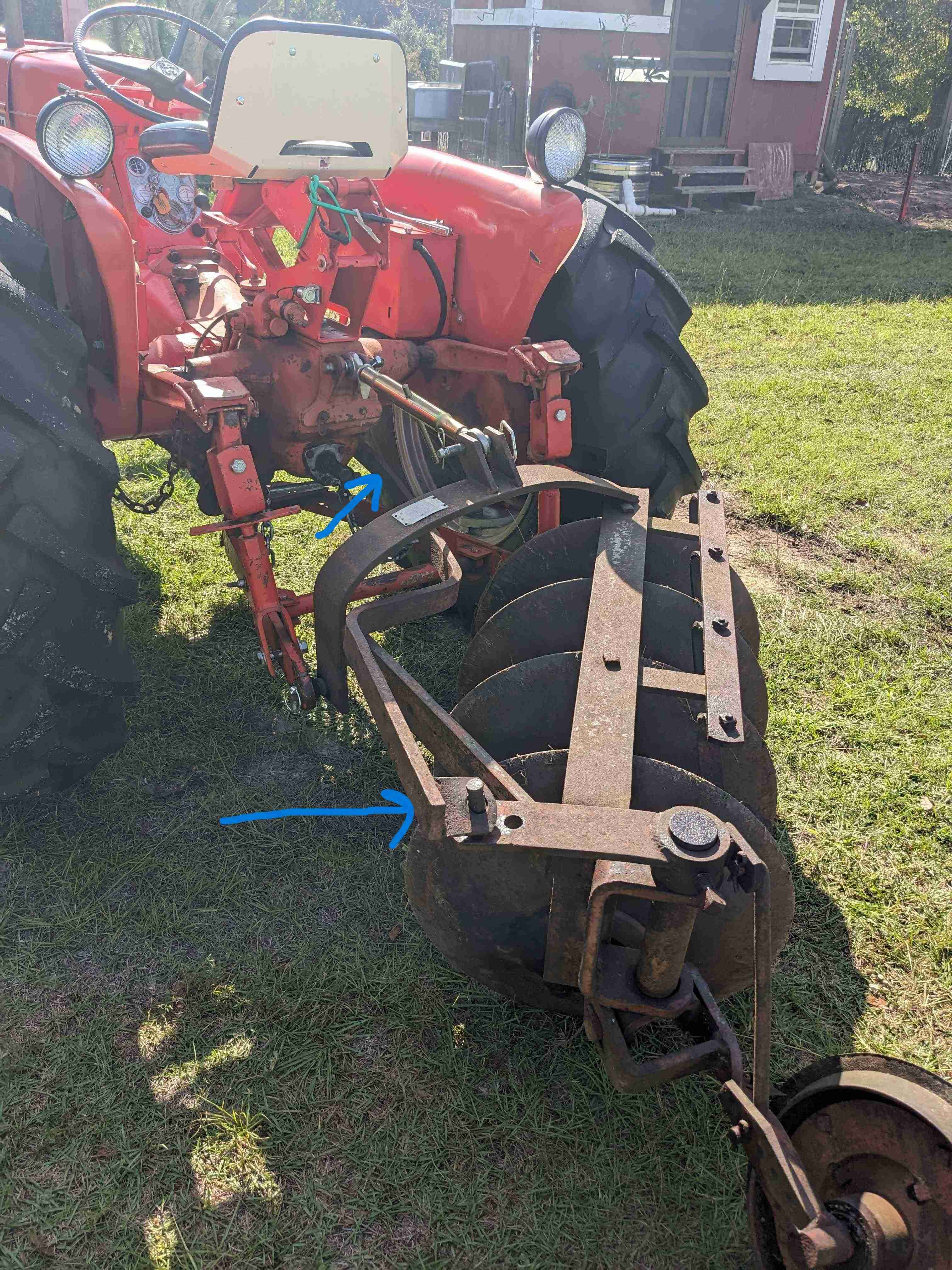

This is about the closest way we could figure. If right the bar is too long. Assume that trail wheel should be close to straight ? Thanks

Post Options Post Options   Thanks (0) Thanks(0)   Quote ACinSC Quote  Post ReplyReply Direct Link To This Post Posted: 29 Sep 2023 at 11:01am

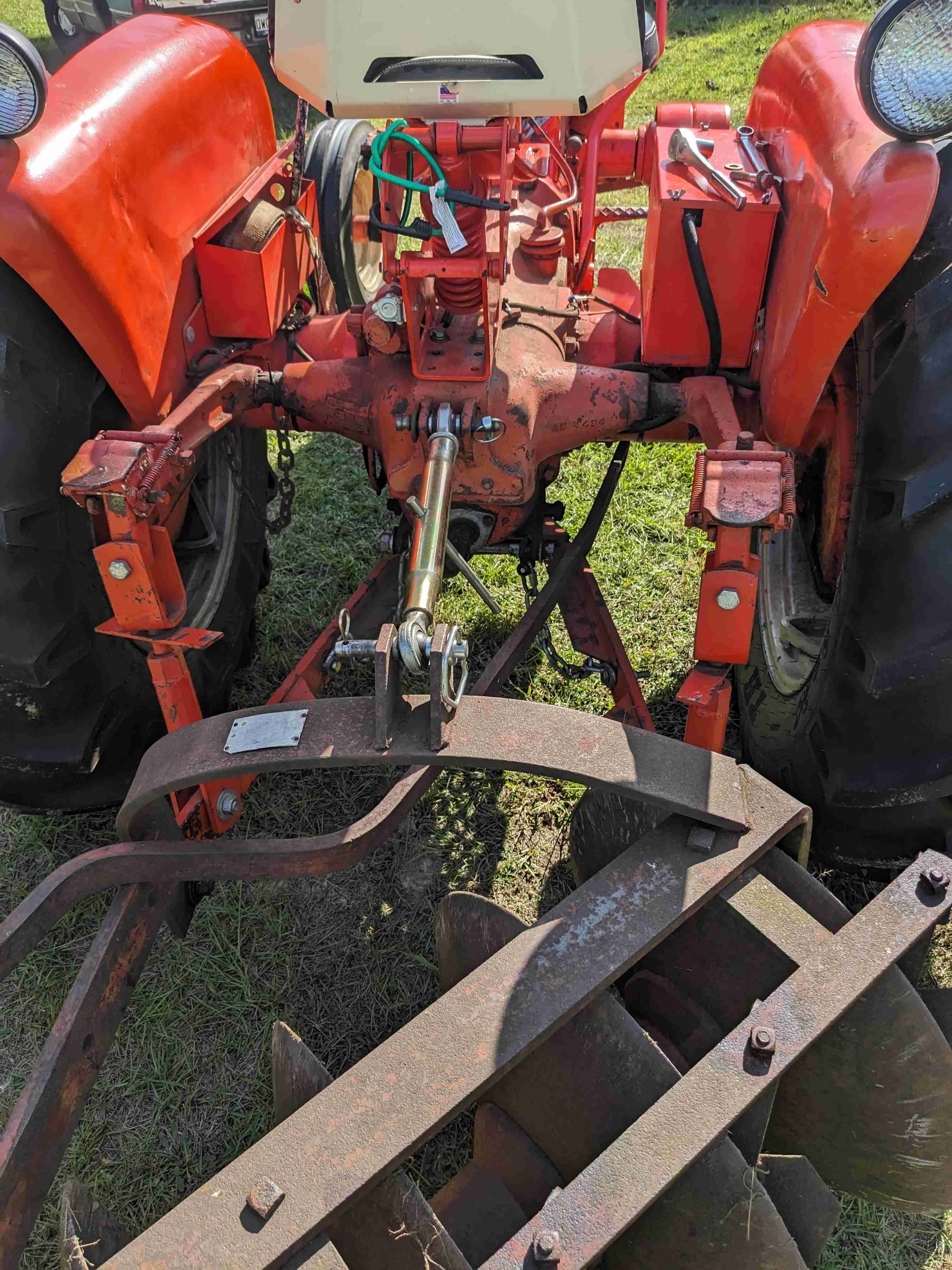

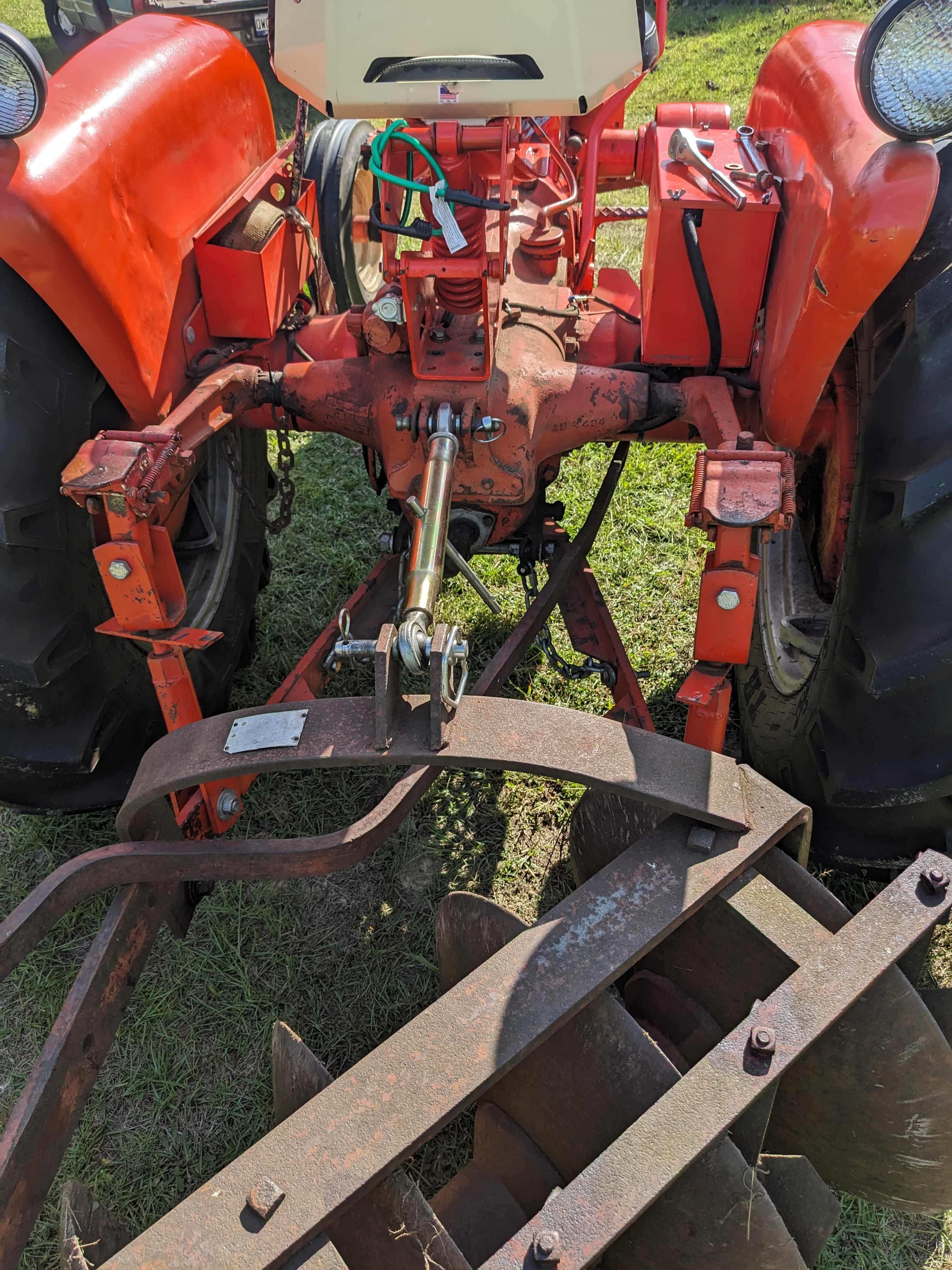

Fav son helped me unload and hook this disc tiller to the D 15 . We can't figure the 'draft bar' out . Guess it's made for a Ford tractor ? Pics should be up soon . Any help is very welcome . Thanks

Post Options Post Options   Thanks (0) Thanks(0)   Quote ACinSC Quote  Post ReplyReply Direct Link To This Post Posted: 26 Sep 2023 at 4:26am
Thanks for the diagram Joe! I just put that arm on there like that. Seller had no clue. Wonder what the tractor end hooks to? Thanks guys!

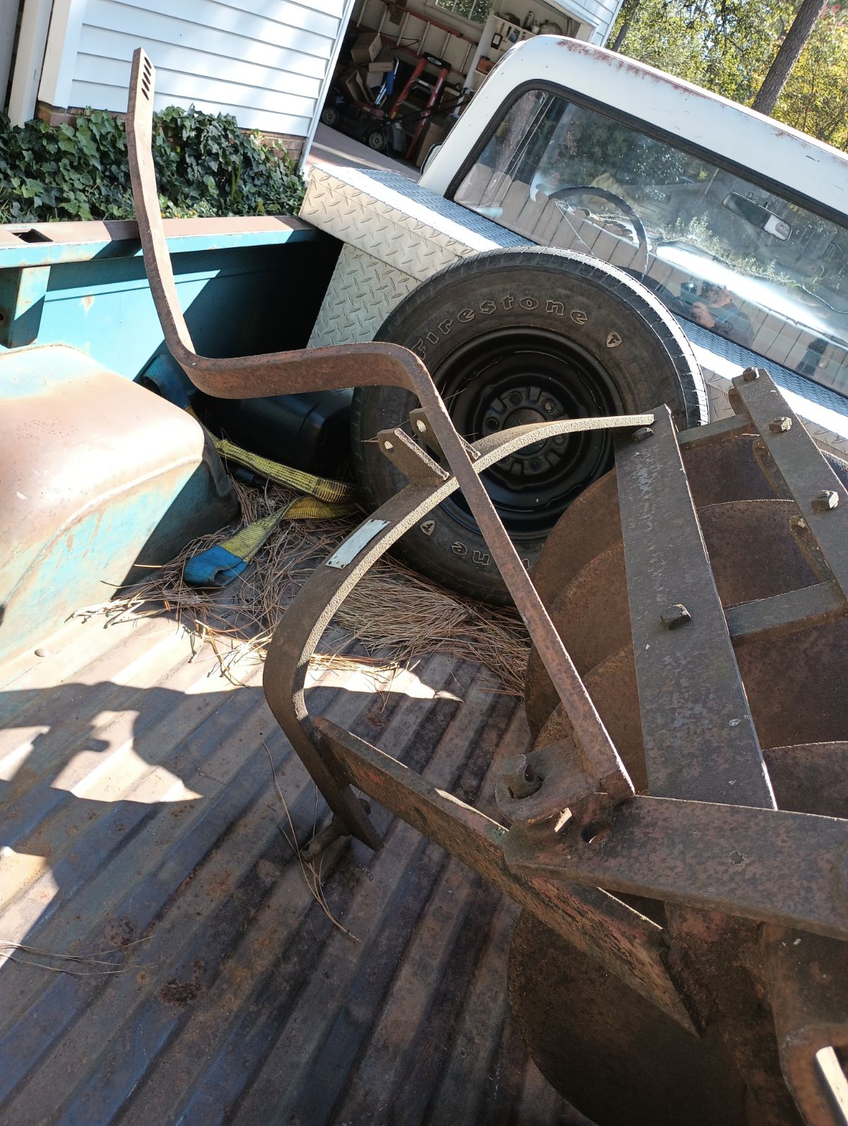

Post Options Post Options   Thanks (0) Thanks(0)   Quote JoeM(GA) Quote  Post ReplyReply Direct Link To This Post Posted: 25 Sep 2023 at 9:21pm
looking at the parts drawings, it looks like the arm is on backwards and the single hole end modified

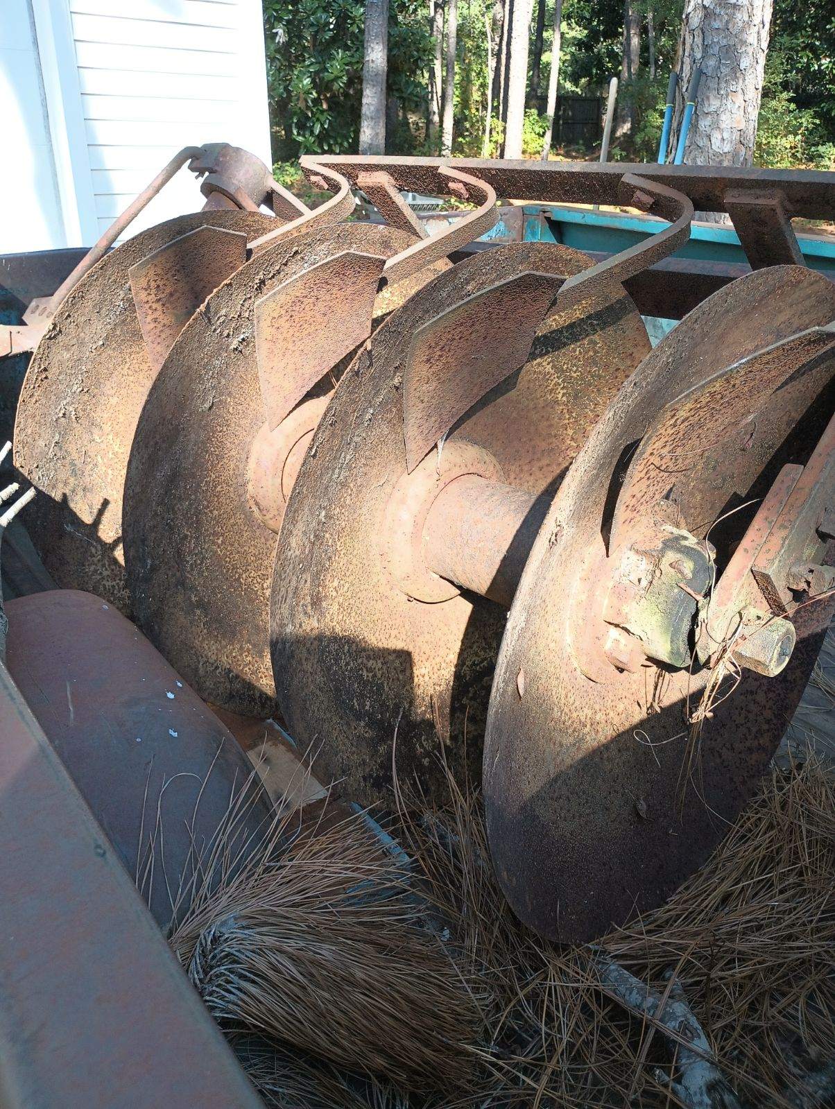

Post Options Post Options   Thanks (0) Thanks(0)   Quote DiyDave Quote  Post ReplyReply Direct Link To This Post Posted: 25 Sep 2023 at 8:08pm
Difference is, that a disc tiller has an axle running through it, a true disc plow has individual bearings on each disc and no axle.  Also called a one-way, in some areas...
On edit, look at the tail wheel.  Not sure if its really wore, but if it pulls real hard to one side, and won't stay straight, then the tail wheel needs a new coulter...Wink

Location: Gallatin,TN
Points: 10876

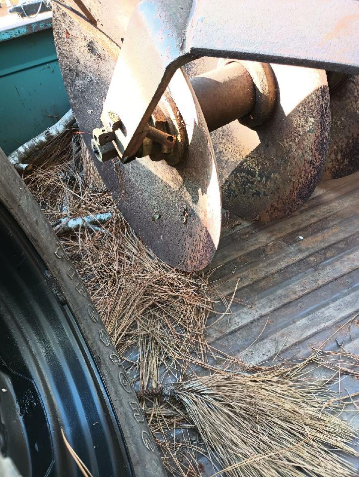

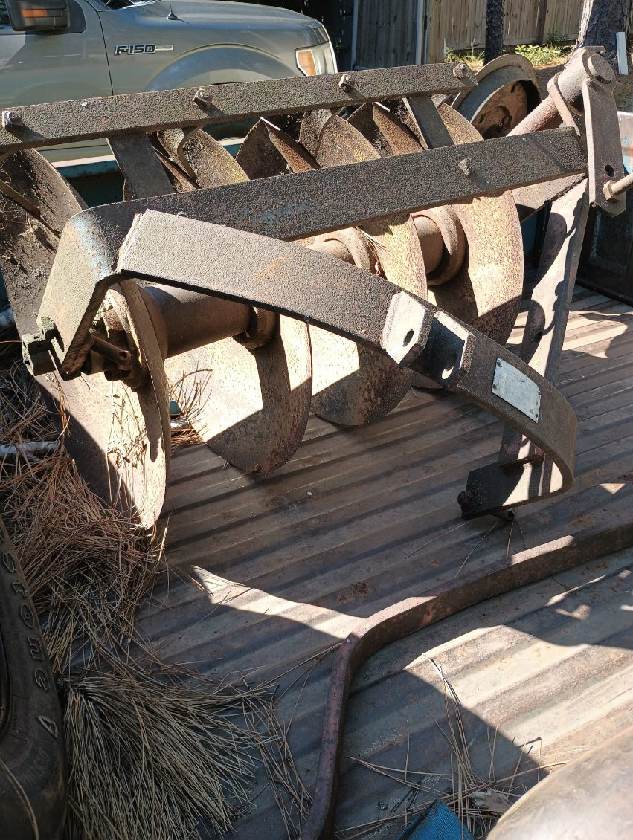

Post Options Post Options   Thanks (0) Thanks(0)   Quote Tracy Martin TN Quote  Post ReplyReply Direct Link To This Post Posted: 25 Sep 2023 at 7:23pm
I would guess that long bar, goes under the top link bracket and to left hand side of tractor stabilizer bracket. JMHO, Tracy
Points: 10876
Post Options Post Options   Thanks (0) Thanks(0)   Quote Tracy Martin TN Quote  Post ReplyReply Direct Link To This Post Posted: 25 Sep 2023 at 7:18pm
That is a disc tiller. HTH Tracy
ACinSC View Drop Down
Joined: 16 Dec 2015
Location: South Carolina
Points: 3178
Post Options Post Options   Thanks (0) Thanks(0)   Quote ACinSC Quote  Post ReplyReply Direct Link To This Post Posted: 25 Sep 2023 at 5:55pm
Favorite son came through! Anyone know how that long rod goes. I didn't notice that one of the lift pins points in until I got home. Never seen that before. Thanks
