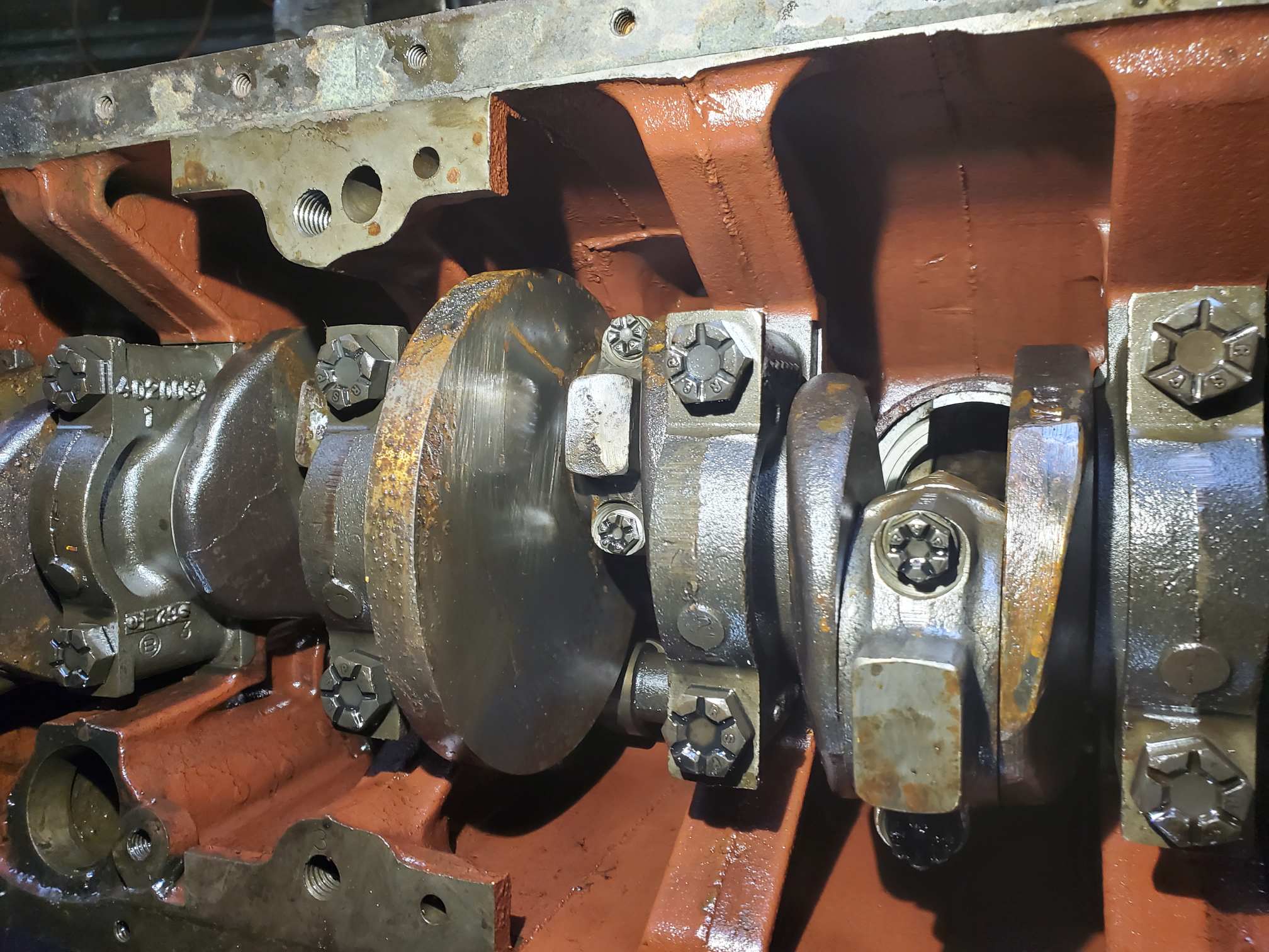

Ca anyone verify ,confirm that this is a AC crankshaft?
The motor tag shows. 2200. 4020150
                        2D 05833
I have never seen a crank with this large disc between the #2 rod journal and the center main
Would these internals be compatible, replacement parts for a later version of the D2200?
Motor ID. 2200.   4022674.
            2D 53934
That is for the ring gear that drives the counter balancer on the higher HP versions.
I would believe that if the crank checks out good you should be able to use it.
On the crank look for a part number cast onto it and it might also have a P/N stamped on it. My memory might be a bit off on the stamped number; I think the later ones had a stamped number.
You'll also find a serial number stamped on it which is unique to each and every crankshaft.

So I could use this crank to replace the replace the damaged one in my 615 backhoe?
Also need 1 rod, lifter and camshaft?

The crank u got pic of is the later crack fits both 2200 and 433t and I eng .the old crank don't have a spot for the gear on it by 1 and 2 rod .I have parts here for the eng if u need any .I even have a core eng here that stuck from setting. Message me if u need any thing .
