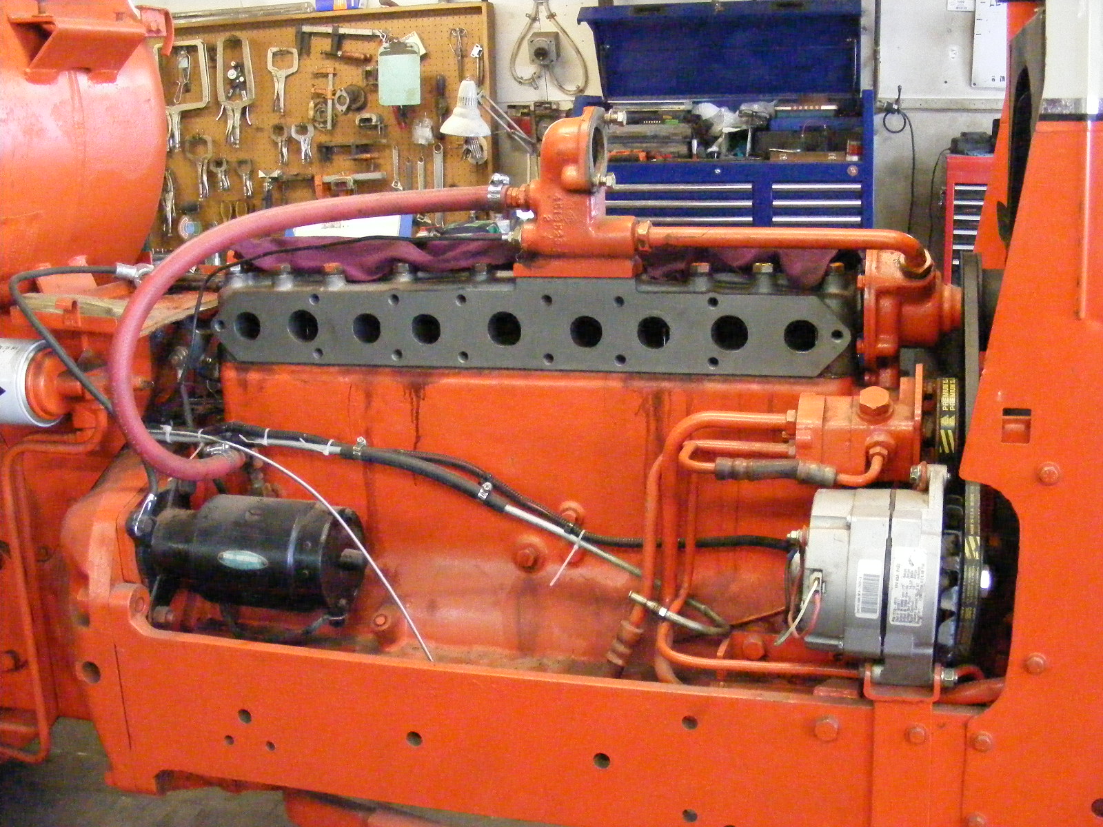

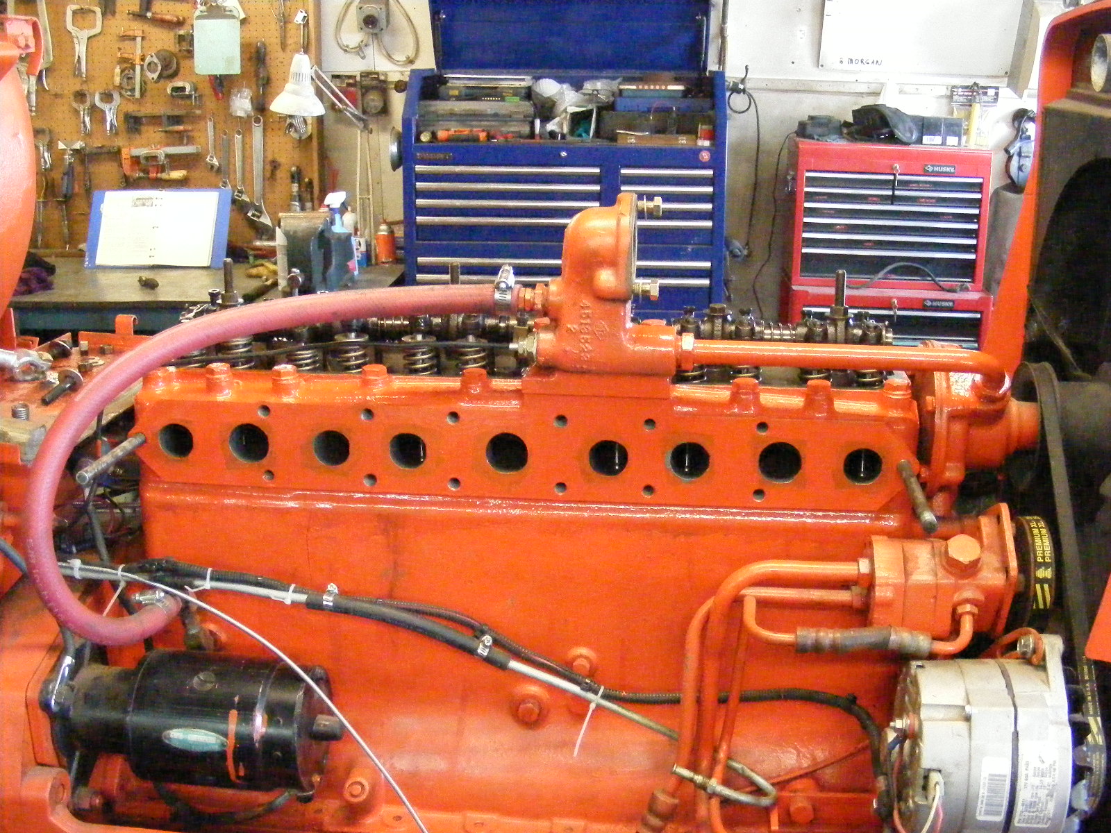

Post Options Post Options   Thanks (0) Thanks(0)   Quote Alberta Phil Quote  Post ReplyReply Direct Link To This Post Posted: 12 May 2021 at 9:57am
Will these help??

Post Options Post Options   Thanks (0) Thanks(0)   Quote KenBWisc Quote  Post ReplyReply Direct Link To This Post Posted: 12 May 2021 at 12:14pm
I appreciate it Phil but it’s the lower line I’m having trouble with. It’s the one with the reverse goose neck connection into the slave cylinder behind the right hand rail and below the the generator. Alternator in your case.

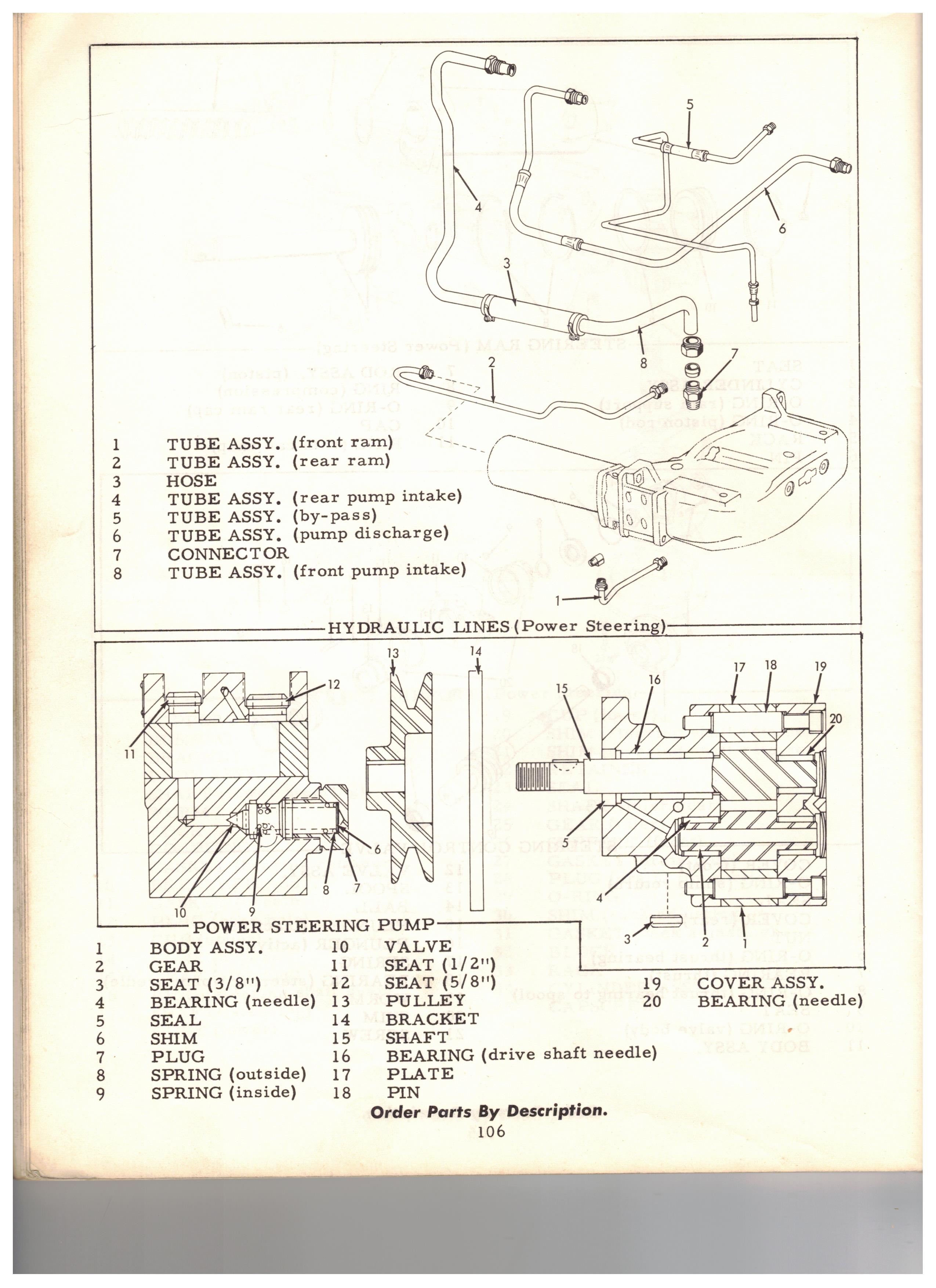

Post Options Post Options   Thanks (0) Thanks(0)   Quote Alberta Phil Quote  Post ReplyReply Direct Link To This Post Posted: 12 May 2021 at 6:25pm
Here is a scan of the lines from the factory manual.  I don't know if it will help.

Post Options Post Options   Thanks (0) Thanks(0)   Quote KenBWisc Quote  Post ReplyReply Direct Link To This Post Posted: 12 May 2021 at 7:43pm
Thanks again! I found the diagram of the lines in an old I&T Manual. If I interpret it correctly, the short Control Valve to ram (front) tube connects to the front hole in the Steering Control Valve and the long Control Valve to ram (rear) connects to the rear hole in the SCV. ??
However, the long line is 1 1/2” behind the ram connection.
Is this routing or orientation (twist) issue?
I also questioned if I mounted the SCV wrong but don’t know that this is possible and the pump to control valve line seems to mount well.
