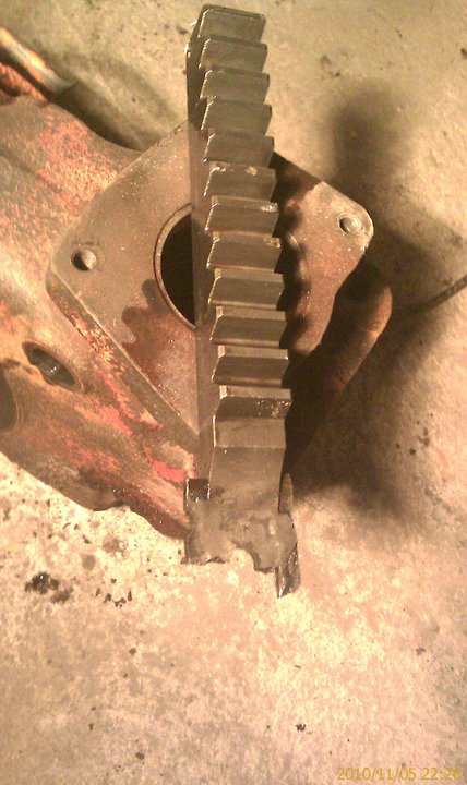

The ram rack was broke on it so that was replaced. I thInk the powersteering setup on a series 3 and 4 are differnt from the earlier 1 and 2

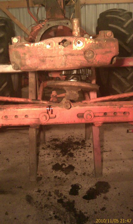

ive been working on this d17 with ironac, and this is what we had to do for drop that front powersteering gear and rack. we r looking for the largest tube that runs from under the front of the left side of the engine , runs to the right side and up to the powersteering, its the largest of the 3 tubes that are present.

I had to replace the seal on the main steering shaft.  The hardest part for me was moving the front wheel assembly out from under the tractor.  Two people really helps.  The bolster is heavy but take out four bolts and support it with a block and jack and you are good to go.

i will look up that part number tonight, i beleive that the fluid had water in it and froze up and thats how that ram rack broke, it surprised both of us to
