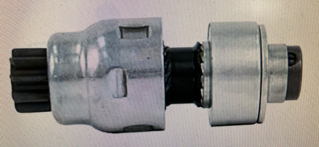

I have a d15 series 1 tractor with a starter problem. With the starter out, it appears the gear is not retracted as it should be. When testing with 12 volts, the gear spins extracted, but doesnt retrack when voltage is removed. Could this be a simple problem or is it going to need replaced or repaired. I assume the gear should move in and out, Right? This is a delco remy starter 1107548. Any help would be appreciated.

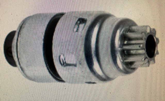

 If you have this style drive and it is out ,like Mack said after engine starts the speed of engine will kick it out of ring gear .
 back in
