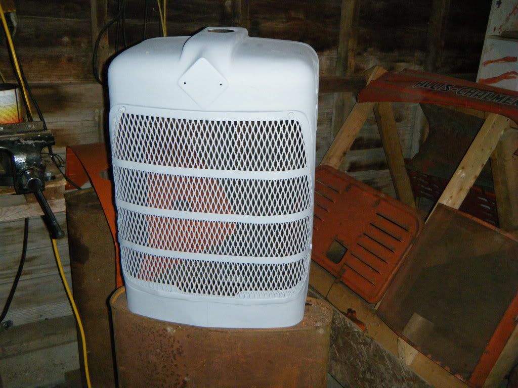

THe ED40 grill screen will fit the d14 shroud, although a couple modifications have to be made. the top mounting bolts are tabs on an early d14, but are easily modified to look like the later (late 59 and 60) d14. Here is a pick of the finished product
