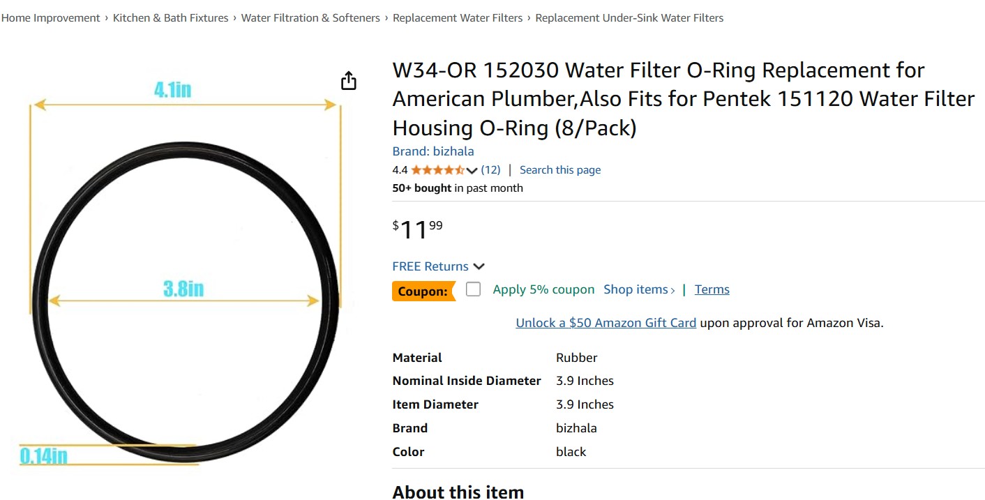

Post Options Post Options   Thanks (0) Thanks(0)   Quote jaybmiller Quote  Post ReplyReply Direct Link To This Post Posted: 14 hours 39 minutes ago at 4:33pm
4 and 1/8" according to this hit...
I used 'culligan o-ring "b" for the search.....
LOTS of people sell them, so check around

Post Options Post Options   Thanks (0) Thanks(0)   Quote steve(ill) Quote  Post ReplyReply Direct Link To This Post Posted: 14 hours 23 minutes ago at 4:49pm
oring OR-34  ?
Points: 86734
Post Options Post Options   Thanks (0) Thanks(0)   Quote steve(ill) Quote  Post ReplyReply Direct Link To This Post Posted: 14 hours 17 minutes ago at 4:55pm
About this item
  • 151120 o-ring for Pentek Water Filter Housing (4 pack)
  • Size:Approximately 3.9" ID x4.15" OD x 0.14" Thickness
  • Replacement for Part Numbers: Ace Hardware 46766, American Plumber 152030, W34-OR, Ametek Kleen-Plus 151120-03, OR-34, Culligan 01019184, 151120-27, DuPont WFAO150, Everpure EV3112-40, Hydrotech 151120, Pentek 151120, Omnifilter 151120, OR-34, Pura 151120, US Filter OR-34
  • Compatible with Select Ametek, Ace Hardware, DuPont, Hydrotech, Omnifilter, Pura, Aqua-Flo and US Filter models
