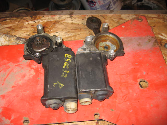

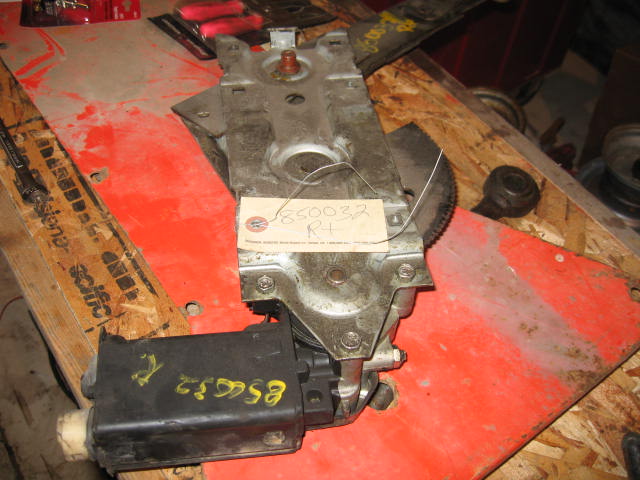

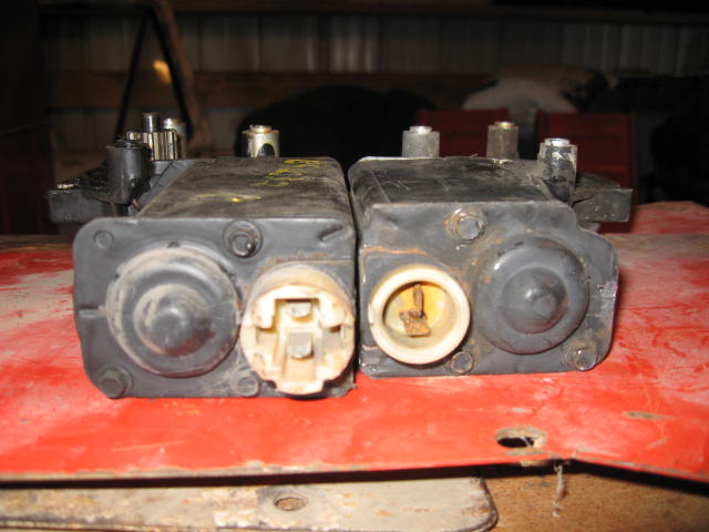

Window regulator motor from early 70's chevy car works.  Does have a different two wire hook up and may have to run ground wire to frame.  I changed the wire ends to the female spade terminals and worked well, didn't loosen with vibrations.  Did it on the snow blower I had, IBWD Mike has it now.
I got the wrong side and think just swapped the gear head from one to the other.  The left one is the salvage yard item.
