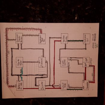

I diagramed my wiring as best I could - see picture below.  I can’t see any variance when compared to the published diagrams(??).
The lower half of your diagram looks ok but the upper half is just weird.
Ammeter + should not go between the solenoid and starter. Battery hot, ammeter, and starter button hot can all go to the solenoid hot (big terminal). Starter button control goes to solenoid small terminal. The other solenoid big terminal goes to the starter.
Erase that weird short blue line at the top of the starter and move the ammeter to the hot side of the solenoid.

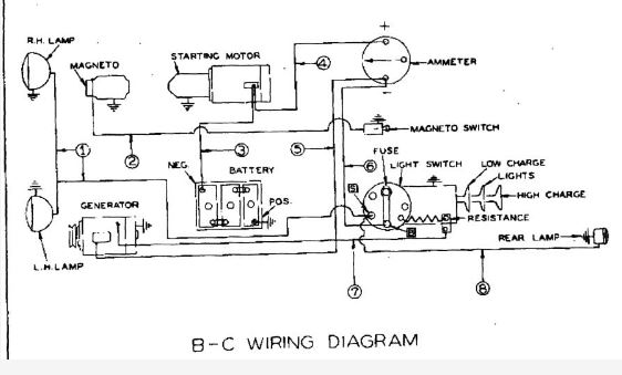

back a ways i posted a color version of the wire diagram.. maybe the Original drawing would help...

  1. WIRING DIAGRAM:
    1. You are correct.  I retraced wiring and revised my diagram (see below)
    2. I noted that the 6 volt solenoid has a “BAT” label on the terminal that I wired to the starter motor.  When I reversed the wiring, the starter was dead.  I did notice this “mislabel” when I installed this new solenoid several months ago (when I had the old 12 volt generator and voltage regulator).  I just figured the mislabeling was due to cheap Chinesium parts (?)
My current plan is to live with what I got - 4/4/4 AMPS - and keep searching for possible ground issues.  I’m in a better place now than before, thanks to everyone’s help.  I’ll try a NOS light switch if I can find one.  I doubt that the new style larger light switch will fit in my cluttered instrument panel box.

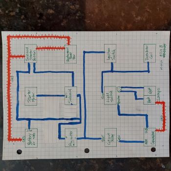

Les - before I try to run test, wanted to make sure the wiring is okay in the picture below:
1. Red jumper wires are those you suggested
2. I added two squiggly dark green jumper wires: from Cutout/GEN to Genny/ARM, and from Ignition Switch to Distributor/Coil.  Are these correct for this test?
3. I kept the GRD wire from Battery to Instrument Panel
4. To spin the Starter Motor to start engine, I can FLASH it from the Battery until it starts
Let me know if this seems correct to you, or if something needs to change.
Hmmm... Smile
The intent of this test is to simulate taking the generator to a shop and having it checked out on a test stand. Since I do not own a test stand, I just use the tractor (or vehicle) as it already has a generator mount and a means of spinning the unit under test.
The important thing to remember is that if you were to actually take the generator to a shop, they wouldn't have any of the wiring, etc. that is on your tractor that may interfere with the test. In order to accurately test/troubleshoot something, it is necessary to eliminate as many things as possible that may interfere with the test.
Visualize how a shop would set up the generator for testing; they would have a mount, a means to spin it, a battery, an ammeter, and a voltmeter. They would also need a way to energize and control the field. And nothing else.
... from Cutout/GEN to Genny/ARM
You do need this.
I would leave the ignition switch completely out of the circuit
I would use a dedicated jumper wire directly to the battery
This won't hurt anything, it is irrelevant to this test because everything is being bypassed.
Yup.
Of course the battery needs to be grounded and also connected to the starter/solenoid
I realize this seems like a lot of fiddling around (it is) but once it is all set up it's sorta fun to play with the field and observe how the outputs change. You will be manually simulating the action of a voltage regulator, albeit much slower and with less precision.

Got it wired for the test - not sure how. See wiring picture.  BLUE wire: used same existing wiring (too many wires for me to jump).  RED wire: new Jumper wires.  “X” out faded: disconnected previous wiring.
Reading with Engine Running
1st Test (1)
2nd Test (2)
3rd Test (3)
AMP
7
15
5 - 3
VOLT
7.60
8.65
6.84
  1. High idle. Light ON.  Light would fade when idle down.
  2. FLD terminal grounded.  High idle. Light OFF.
  3. FLD terminal grounded.  Low idle. Light OFF. AMPs only dropped from 5 to 3 (not zero)
What Is the conclusion: is Generator and wiring working properly?
