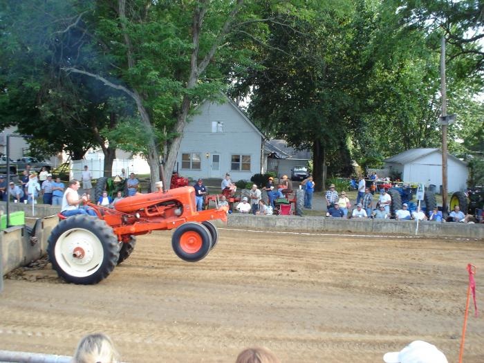

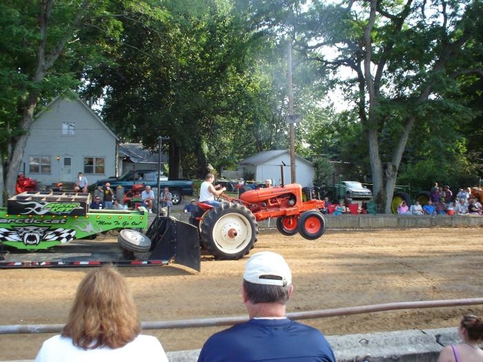

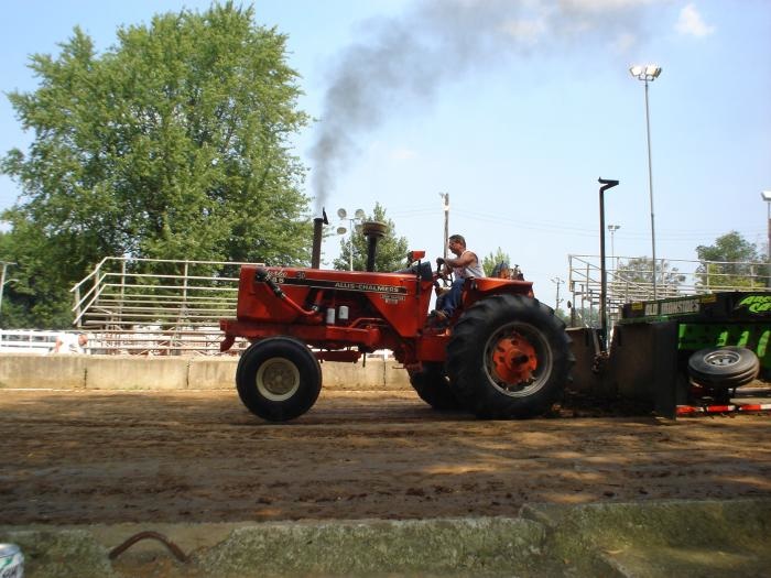

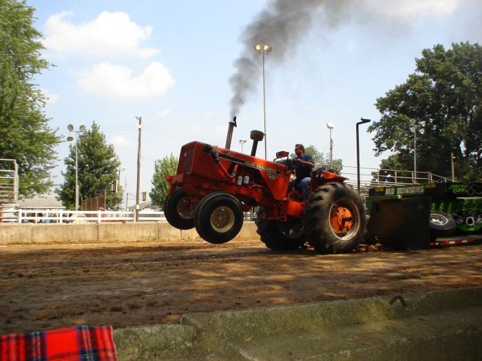

 These are the pictures of the WD-45 diesel that we pull, in classes 4500-6500.  We also pull the 185 in 7000 & 8000 pound classes. We won several 1st, 2nd, and 3rd places pulling last year.  These are tractors that I use to farm with.  It sure is fun to beat out the tractors that they only use for pulling!

Like to see the old WD45D's pulling, And yes the 185 is cool too!

whats all done to the 185 ?  how much horse ? and the long tube that sticks out the side ?
                         just asking   Shawn

We run 3000rpm in the pulls and the pump was worked on and 200 nozzles were put in. The tubing that  you see is hooked to a car intercooler along with a electric fan in front of the cooler. This is mainly done for farming as all I do to farm with it is to slow down the rpm. The extra tubing actually make me loose a couple of pounds of boost. We are running a little over 200hp.

   Huh, I think I'm in that third picture. Wish they would forget the stupid slow speed limits down there.
