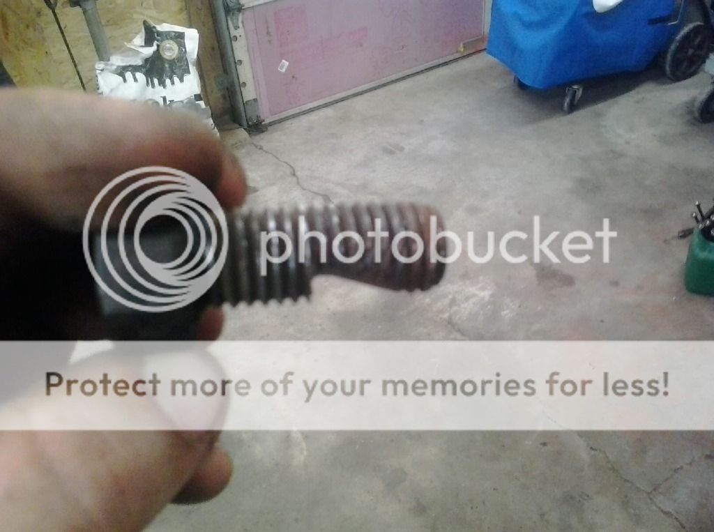

Oh and here is the crank off of mine. I'd like to find the people who owned it before me.

Was your crank pulley rattling and making noise? I think your crank is shot unless someone can fix it?

Pete, you couldn't tell it untill low idle, but it sounded more like a knock in the motor. And yep it's shot it is worse in person. sooo I will be looking for a new crank..

I think IV has harden journal on crank.

  We had a WC crank with the same problem fixed by a machine shop in Shelbyville, IL .  If the crank is good otherwise it might be worth checking into getting it fixed.
Post Options Post Options   Thanks (0) Thanks(0)   Quote CTuckerNWIL Quote  Post ReplyReply Direct Link To This Post Posted: 06 Sep 2015 at 8:30pm
That nose on the crank can be fixed with a good epoxy. I fixed a flywheel on the back shaft of a 2,500 ton forged press with a Moglice product for static fit. Just takes lining up the pulley and filling the void.

Josh - happened to mine back in like 1996/1997 and I ended up having to get a different crank too, couldn't be fixed.  Good luck.  Mike
