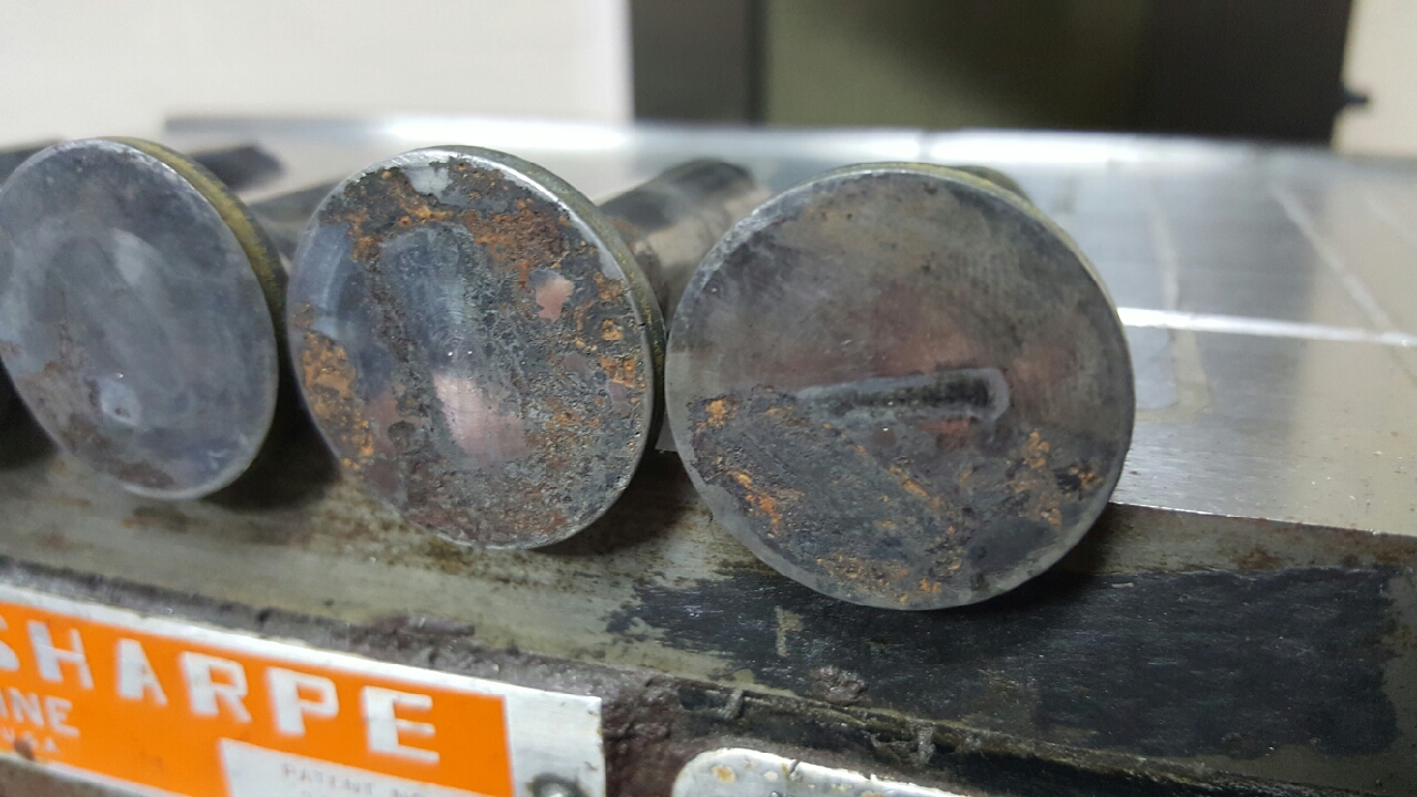

Post Options Post Options   Thanks (0) Thanks(0)   Quote BlackFatbob Quote  Post ReplyReply Direct Link To This Post Posted: 13 Oct 2016 at 11:28am
Hi Dick,
I was hoping you would pick up on this.    Maybe I'm being fooled by the surface finish.  Here's a pic or two

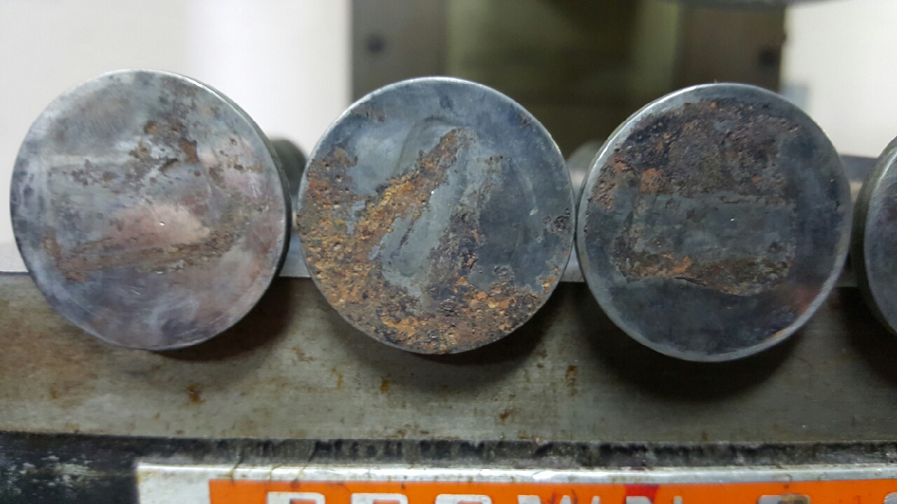

Post Options Post Options   Thanks (0) Thanks(0)   Quote BlackFatbob Quote  Post ReplyReply Direct Link To This Post Posted: 13 Oct 2016 at 11:32am
Here's another

Post Options Post Options   Thanks (0) Thanks(0)   Quote steve(ill) Quote  Post ReplyReply Direct Link To This Post Posted: 13 Oct 2016 at 12:31pm
couple of them are a little deep.. Might be cheaper to buy a used set and pick out the best ones as compared to grinding $$.

Post Options Post Options   Thanks (0) Thanks(0)   Quote Dick L Quote  Post ReplyReply Direct Link To This Post Posted: 13 Oct 2016 at 7:07pm
Originally posted by BlackFatbob BlackFatbob wrote:
Here's another
I would pitch those.  It sure looks like a coating on them. You can never say never but there was no coating on any I have removed from old engines.  I have some around here someplace that are wore concave.  Those that I have resurfaced polished up like new. I wouldn't think you would want a hard chrome surface rubbing on a cast iron camshaft. I have never seen any rusted that bad either.  Take a grinder and lightly remove a small part of the area that looks like a coating and see if it changes look. Hard chrome would not be very thick.  Hard chrome will chip after it is thick at some point. I have had mold cores hard chromed but don't remember how thick it can be before it is in danger of chipping.  I had some mold cavities re-hard cored to thin the part and the build up was nickel with a flash hard chrome.
